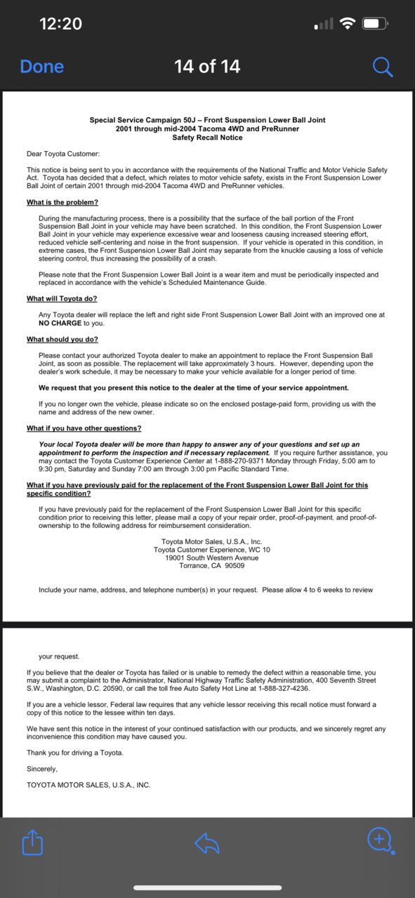

    Did a little searching on the Google and found this….

    There is almost no visual indication of an LBJ about to fail, other than perhaps if you’re missing one of the steering knuckle bolts. The joint itself only has an allowable play of 0.020” before being considered out of spec. If you put it on a lift and flex the joint with a pry bar, any visible movement means it’s already on its way out.
    The “voluntary replacement campaign” (not a recall) was for the original joints installed from the factory, and was for a narrow range of production dates. Even if your truck fell into that category, you’d probably have a hard time getting any reparations from the dealership at this point. It does go to show that they knew there was an issue though, and probably to a much greater extent than they’re willing to admit.

    Good to know, I want my brother to be aware of this too since he also has a 1st gen Tacoma and 4 runner. Better to get them on the lift with 4 wheels and check that out vs what happened to me.
    I don’t doubt that!
    I’m going to call and talk to them anyway just to see what they say but I don’t have any expectations that Toyota will do anything but it was nice to read and educate myself on the issue and now how to prevent and be aware of it before it completely fails and to help bring awareness to other Tacoma owners.

    Looks like that is regarding a manufacturing defect in a run of LBJs that they were replacing, not wear and tear, so I don't think you'll get anything out of them. It is a goofball design though, so it is important to inspect them periodically. Here's a video that shows how to check them:
