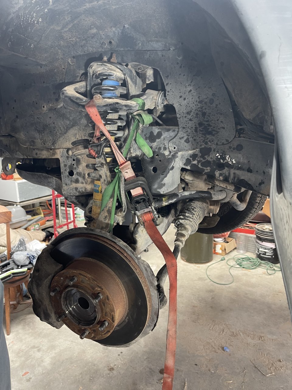

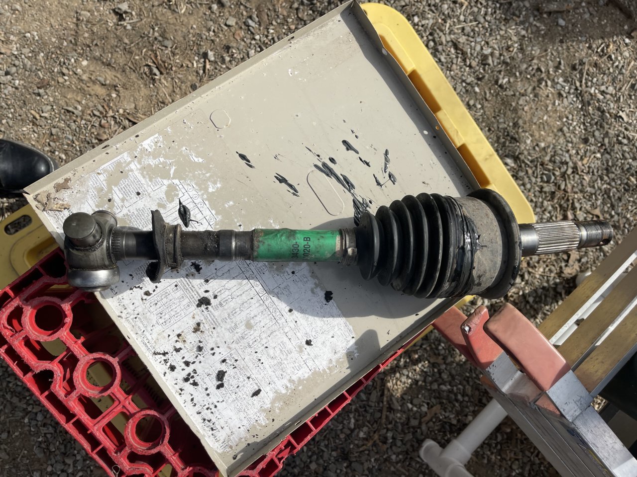

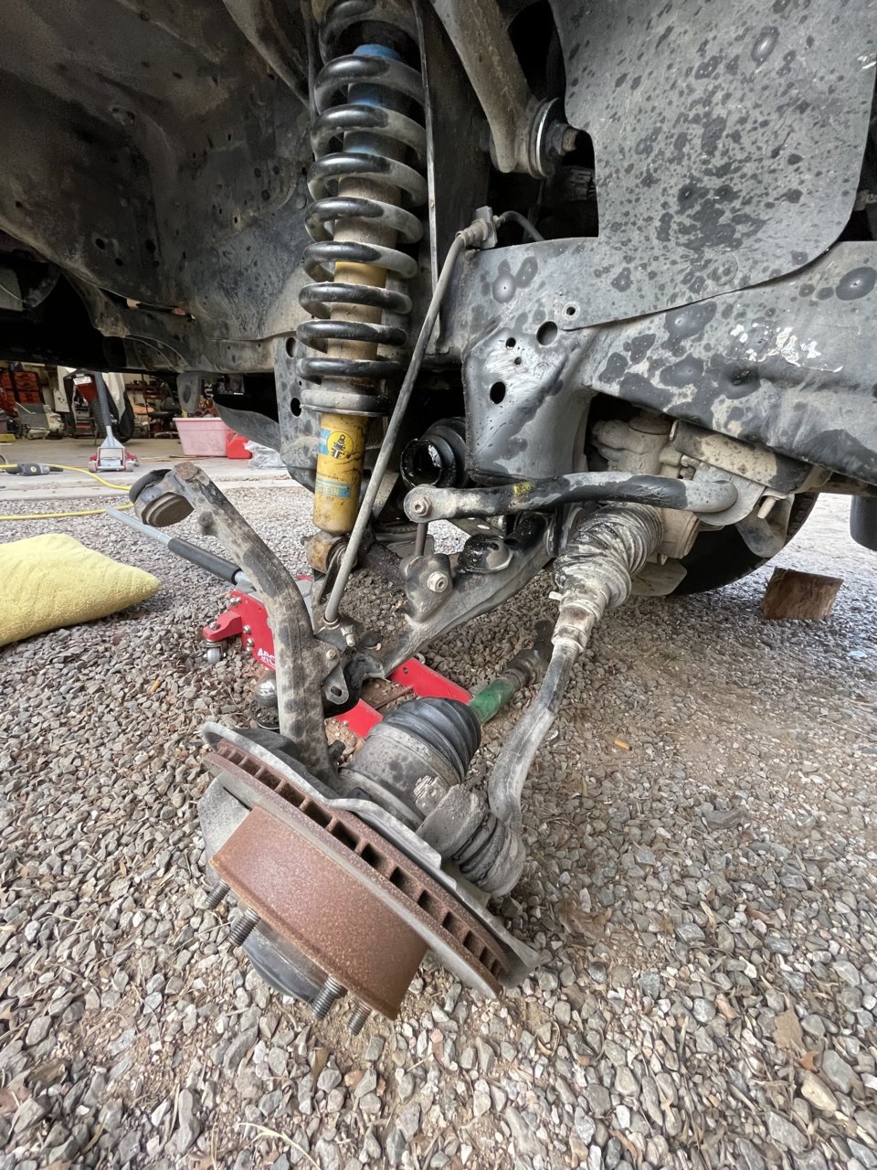

    Looks repairable. I would assess the condition of the tri bearing on the cv shaft? If it's in good condition I'd clean it up and re-use it. Looks like it only pulled out of the boot. (Do NOT buy a re-built CV from autozone or Napa. There is a reason why people turn those in) But clean off the tri bearing and see what condition your CV is.
    One of the main causes for ball joint failure is a sagging suspension. If your truck shows sign that it is contacting the "bump stop" regularly, you might want to look into new struts. Hitting the bump stops causes major force on the LCA ball joints.

    Don't beat yourself up too hard on this one. Honestly, at only 70K since they were last replaced, and by your Dad, I wouldn't have worried about them either until at least the 200k mark was approaching on the truck; especially as it was a one-owner and previously by your Dad and I'm assuming they weren't showing any imminent signs of failure. (excessive/uneven tire wear, loose or wobbling steering, bad alignment, failed inspection etc.)

    Do you know what brand your dad replaced them with? If they were cheapies from the auto parts store that probably explains the early failure, try to stay with OEM on the LBJs. If that's out of budget then the 555 brand ones are also recommended and are cheaper than OEM are through Toyota.
    I would stay far away from those ultra cheap ACDelco/MasterPro/Duralast etc LBJs.

    I'm talking specifically about the balljoints as the item you shouldn't cheap out on.
    If a cheap CV goes out it's not likely to cause the same issues as a cheap lower balljoint going out. The NAPA CVs I hear are actually pretty good.

    I'm sure her dad has it under control. I rarely have had any problems with aftermarket parts. I'm only trying to save the girl some money. I'm not going to friggin' Toyota for wiper blades or a battery, lol. :)
    BTW, it was the upper ball joint that failed. Her dad might have only replaced the lower, which didn't fail. Her mom wants her to get rid of it, anyway.

    I'd be either disconnecting that brake line, or at least propping up the spindle so the line doesn't break. You want to keep the fluid in the system. I'd still suggest changing the lines out. No telling what internal damage might have happened there.

    I noticed that, also.

    Thanks everyone for all the posts! I havent had a chance to read through all of them yet but I appreciate all of them! I’ll share some pics of the parts to make sure I’m understanding what is what.
    A little update: found out that the BJs are original from factory, the only thing my dad did when he first got it (never have owned a Tacoma before but is well versed in vehicles and working on them) he put in the Bilstein shocks when he got it, and we eventually replaced the carrier bearing (that and getting my tires balanced helped the shake I used to experience at around 55 mph) , last year did all new rotors, calipers, break pads (the old ones were shot) but basically everything else hasn’t been touched and was on the to do list before the BJ failed mid ride so here we are.

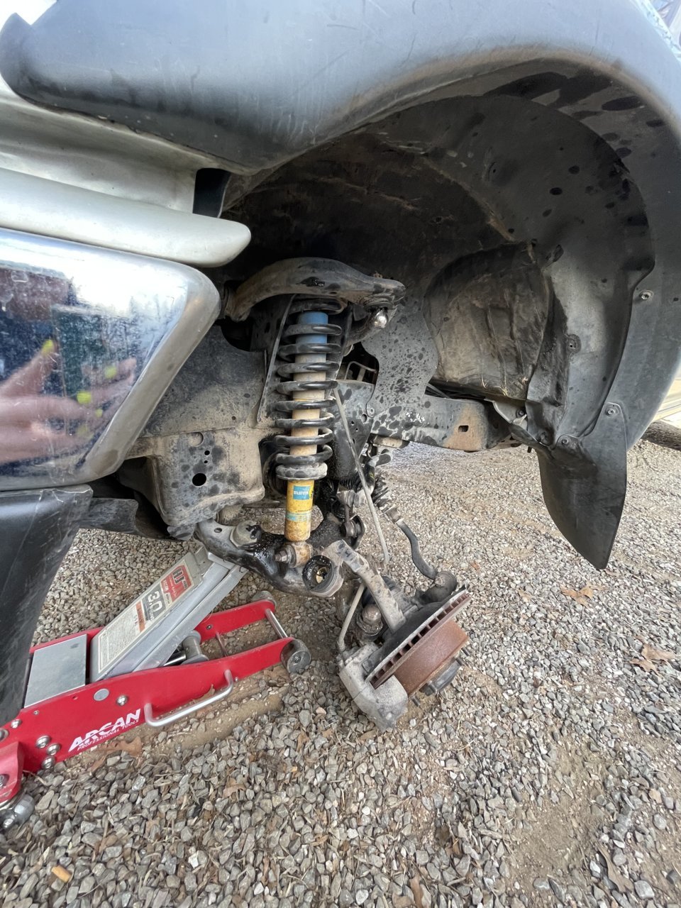

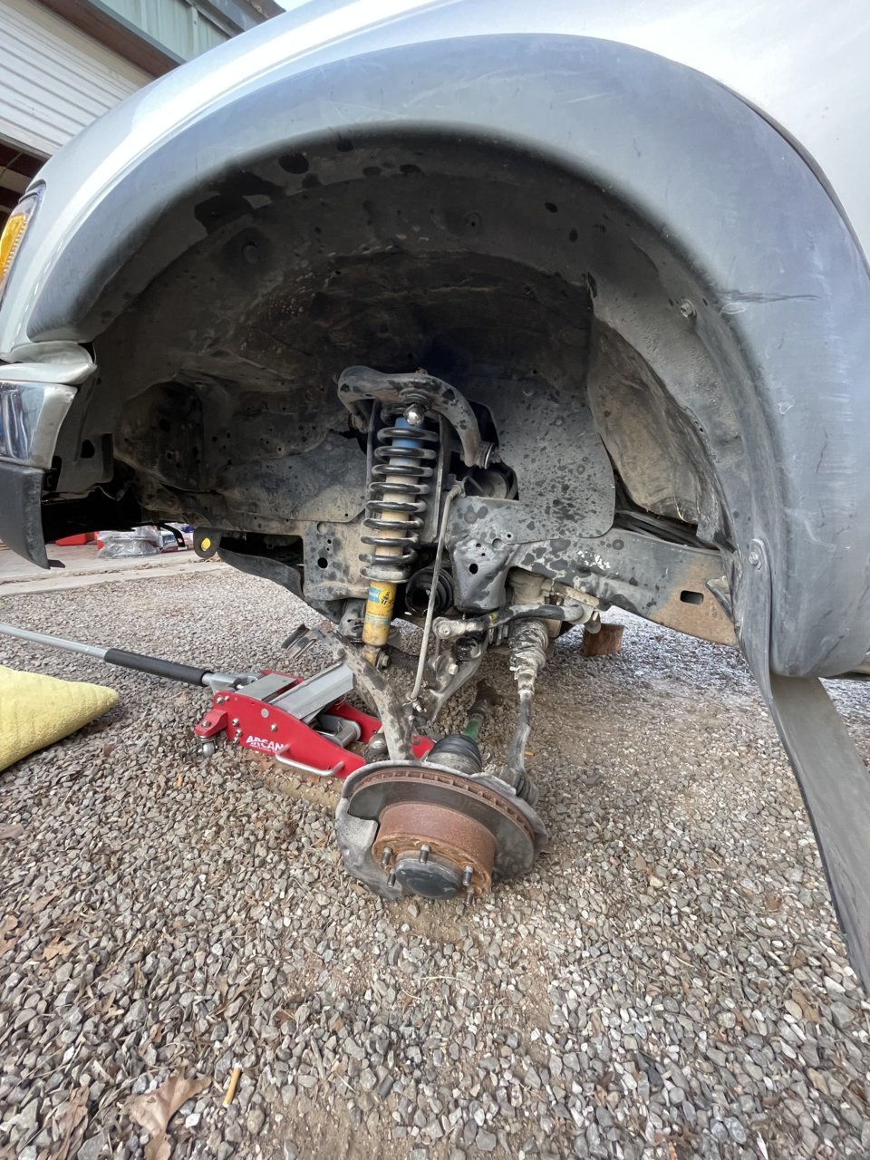

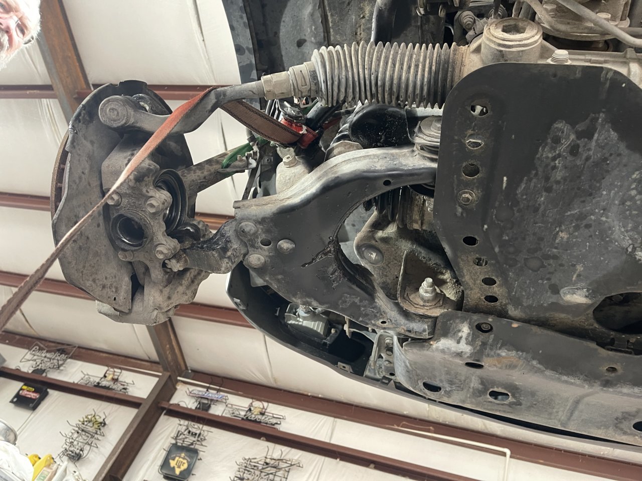

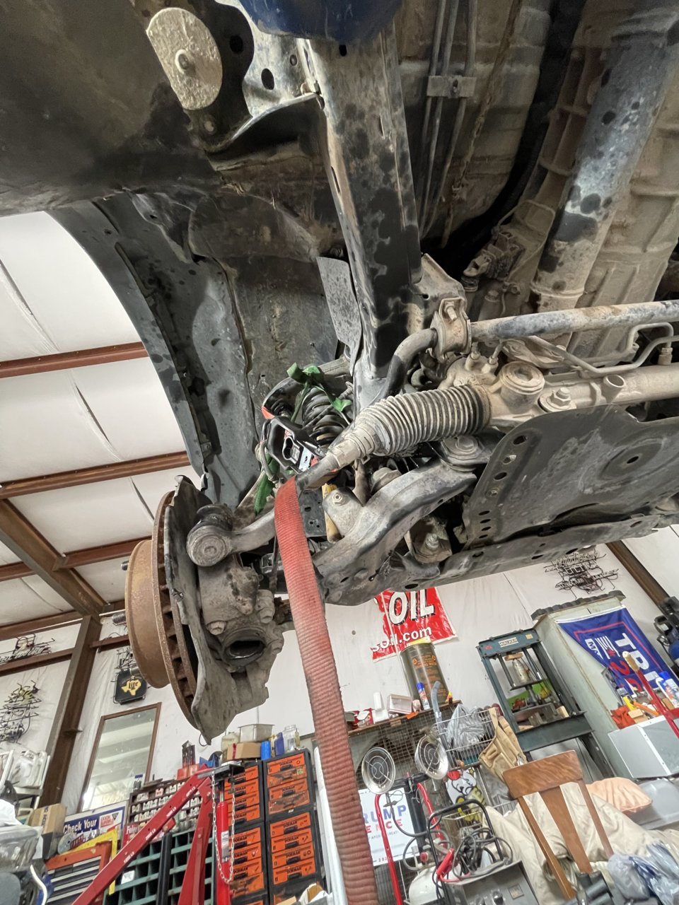

    Came home from work to find my dad had managed to get it in the shop and on the lift. Starting to get my list of parts needed and won’t be stingy if needing OEM. This is a vehicle I plan on literally driving the wheels off for a second time :thumbsup:
    my mom may not want me to keep driving it but once she knows it’s nothing to be scared of after fixing and continuing to take preventative measures and thorough maintenance, she will be just fine!
