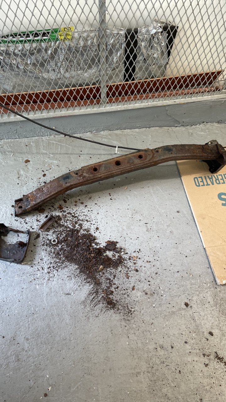

    It makes you think.what else you dont see is rusting . my rear bumper reinforcement bar rusted into two pieces F784E5A7-4374-4F0A-9126-840AE4AFBCB8.jpg

    Those bumper bars are absolute rust havens. Replaced mine early last year, about a year & a half after I got a new frame.
