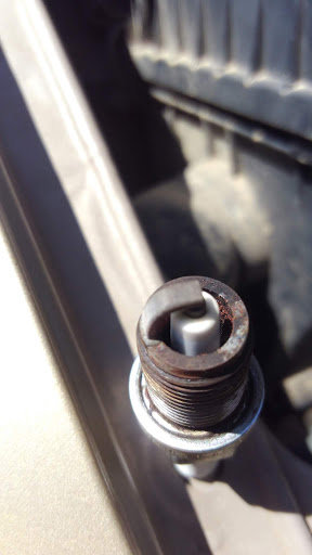

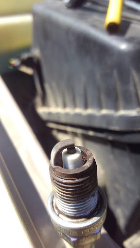

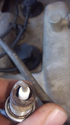

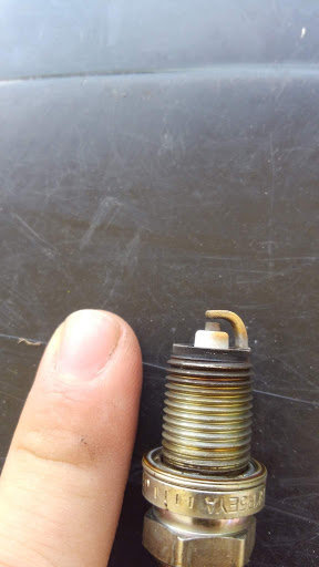

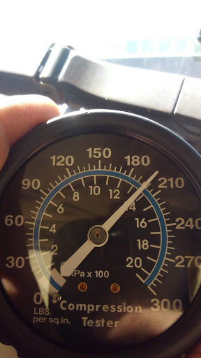

    Coolant level has been slowly dropping on my '96 2RZ-FE Tacoma. Drops maybe half the overflow bottle in 6-700 miles. Very slow. However I can find no evidence of external leaks. I parked the truck for almost 3 days and unscrewed the drain plug until the oil just started to slowly seep past the thread. All I got was good oil, no water. Yay! Then I decide to pull the spark plugs. #1 looks good. #2 looks good. #3 not so much. It looks clean with a little white residue on it and what looks like rust or dried coolant. Also smells strongly of coolant. Great! Got 195 lbs of compression though, so thats good. But somehow coolant is getting into the combustion chamber.
    So a little background on the truck...I just replaced the head and head gasket 2000 miles ago. I used OEM Toyota head bolts, and OEM Toyota gaskets everywhere. Also bought a remanufactured head from Allied Motor Parts. Remaned using OEM Toyota casting. Block deck was checked and was flat as can be, also head was checked with straightedge and was dead flat. Head bolts were torqued to spec and I literally checked everything like 5 times before and during installation. Head surface and block deck surface were extremely clean. I did everything possible to properly prep the parts and quadruple check everything. Also, while I have owned this truck it has NEVER been overheated AT ALL. Temp gauge never went above halfway. So I am thinking there must be a) cracked head (I believe most likely, though it was supposedly pressure tested for cracks) or b) blown gasket (I doubt it blew on its own though, everything was perfect when I installed) or c) cracked block (very highly doubt) I do have a 2 year warranty on the head, so I can get another if needed, but what if I get the same problem?
    A mechanic I trust recommended I put some Bars Leak pellets in there as its such a small leak. He said theres a good chance it might stop it, being so small. Now if its a cracked head then it might not stop it. So I did that tonight and drove it around for 40+ minutes, got it good and warm. So I will drive it around a bit and see if that stopped the leak. If it did then I am happy, though I know the problem isnt really "fixed''.
    Basically I am looking for ideas on what it might possibly be...maybe theres something I havent thought of. Thoughts, suggestions? Anyone?
    Thanks!
    First pic is what plugs 1,2 and 4 look like. Rest are of #3 plug and comp. test results from #3 cyl.

    Ran the engine an blipped throttle, don't recall seeing any bubbles. Not sure it would pool either, being such a tiny leak but worth a shot. I will see if I can get ahold of one of those testers somewhere. I have basically no other common symptoms of HG failure (no smoke, no oil in coolant in or vice versa, runs smooth, good compression) ...only a small coolant leak really.
    Well here's the deal, the heads got a 2 yr warranty so I should be able to warranty it IF that's the issue. Used lower mileage motors gonna run me at least $800 if not more. Head job hopefully only $250-300. Doing all my own work.
