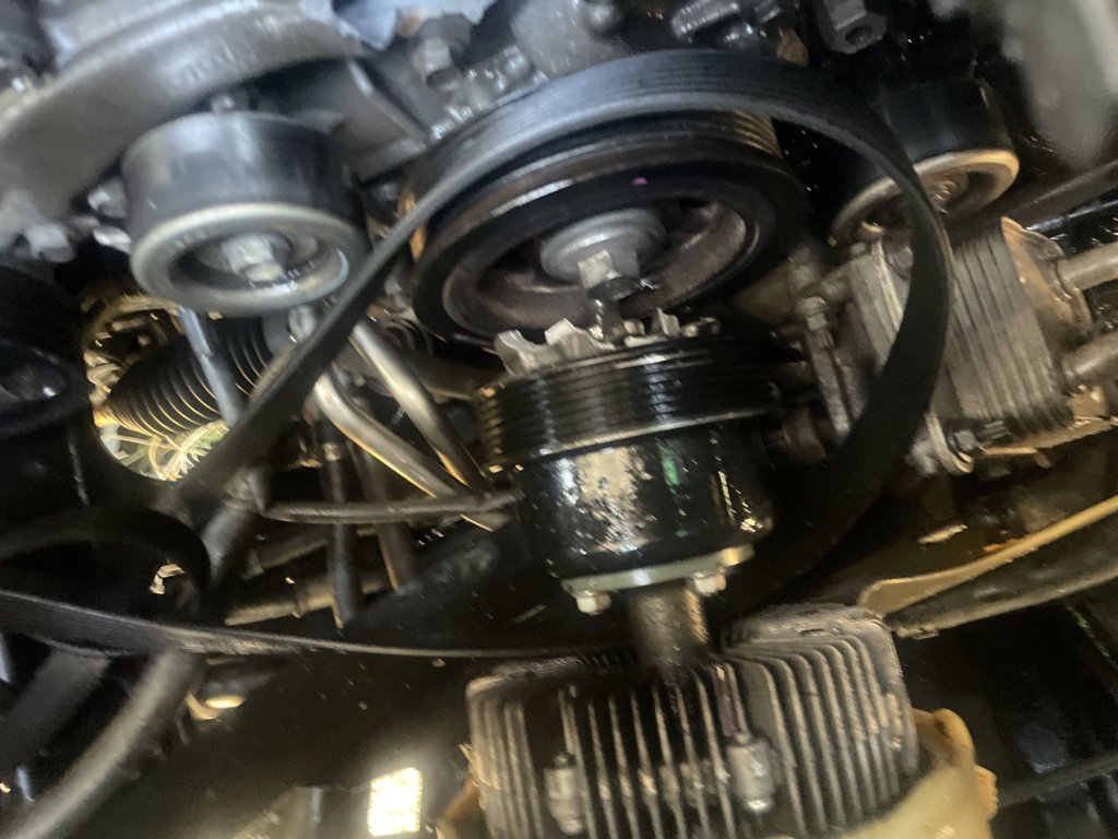

    Well the shitbox let me down once again.. fuck Toyota. What a piece if shit!

    Was passing a car and heard a pop and saw smoke.

    What was the work done previously?

    2 engine replacements about 60k miles ago.
    cause of the initial engine failure was vapor lock blowing out a cylinder of the block (cracking the aluminum block). Power train warranty ended at 60k miles, failure happened at 65k Toyota did not cover. Luckily I had extended warranty bullshit…
    engine 1 had 55k miles and a cracked casing and the other had 20k miles and didn’t leak.

    nah bro, this is the third engine… at 135k miles. Apparently I just have bad luck and picked a bad truck.. the only thing I do differently from normal Tacoma drivers is actually driving on dirt roads. They did just pay $7500 to repaint the parts they agreed to repaint due to the paint falling off. So that was cool other than the inconvenience of getting it done.

    the second engine got installed was determined to be damaged in shipping, then removed and had to wait for the third.

    To clarify the engine that had this failure had about 110k miles on it.

    Looks like the front of the water pump broke off? I wonder if the belt tensioner is seized and putting too much strain on the drive belt system

    Agree, but was unfortunate.. failure occurred when I went to pass a car on a two lane road, heard a pop and saw smoke then pulled over.
    my fan was completely destroyed and looks like oil all over the engine compartment.

    Odd, how does a water pump snout break clean off just like that?

    Seen something similar. Fan bracket broke on a GX460. The culprit was a bad fan clutch.
