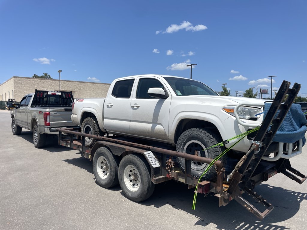

    77CEB596-3931-4F36-97C4-4AF26378FDFD.jpgThis truck gets towed more than that water skiing squirrel… DIY it is.. the dealer wanted $8k 5.5 due to damage and the rest really expensive maintenance they recommend that I do myself anyway.. they have lost their damn minds!
