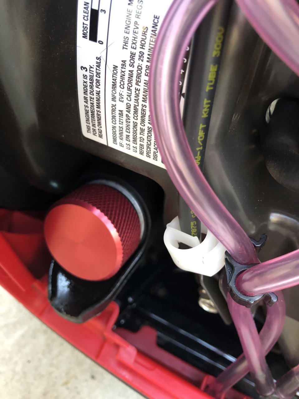

    Wow. Power is on!
    Drained fuel. Changed oil. I’ll fog the cylinder this weekend.
    Screwed in a magnetic dipstick.
