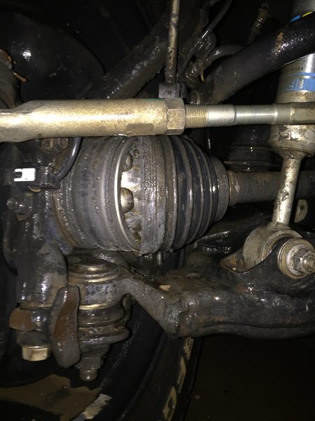

    One more thing. I noticed this when under there cleaning. Is this boot coming loose? What's going on here? It doesn't look right.

    Not coming loose that boot is off!

    Time for a new axle. With the mud in there the joint is probably worn.

    This ^^^.
    Get a new CV Axle.

    I'd be inclined to remove it, clean it out REALLY well, and reinstall it.
    Since its been a relatively short distance, it probably didn't wear to much.

    you assume that the boot came off when OP was mudding recently...

    Yup what he said, you need a new CV axle. Who knows what's gotten in there or how long that boot has been off.
