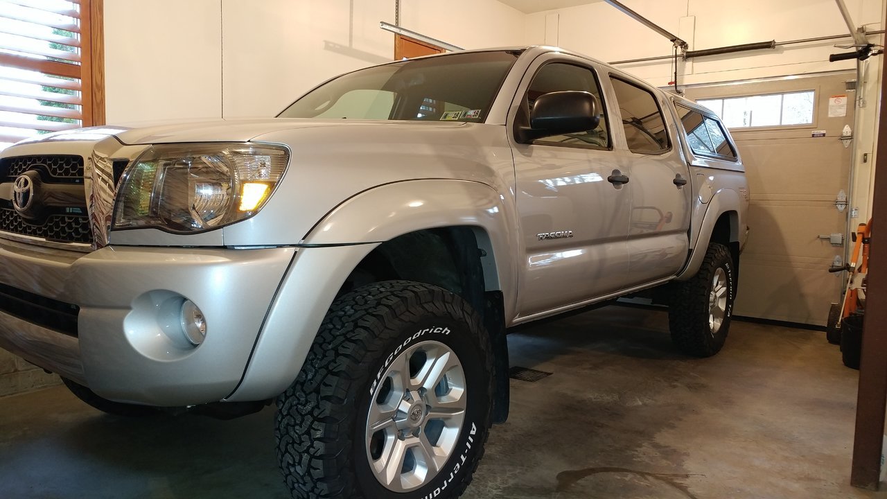

  15. Jul 7, 2017 at 4:58 PM
    #35
    coseng
    coseng Well-Known Member
    Apr 24, 2012
    #77559
    102
    Grove City, PA
    2011 TRD DC
    OME 885x front, Dakars rear, LR UCAs, ECGS bushing
    I used the grade 8 hd bolt kit. You need to run a 1/2" drill bit down thru the mounts to get them to fit.0419171738.jpg
    Ktaco[OP] likes this.
