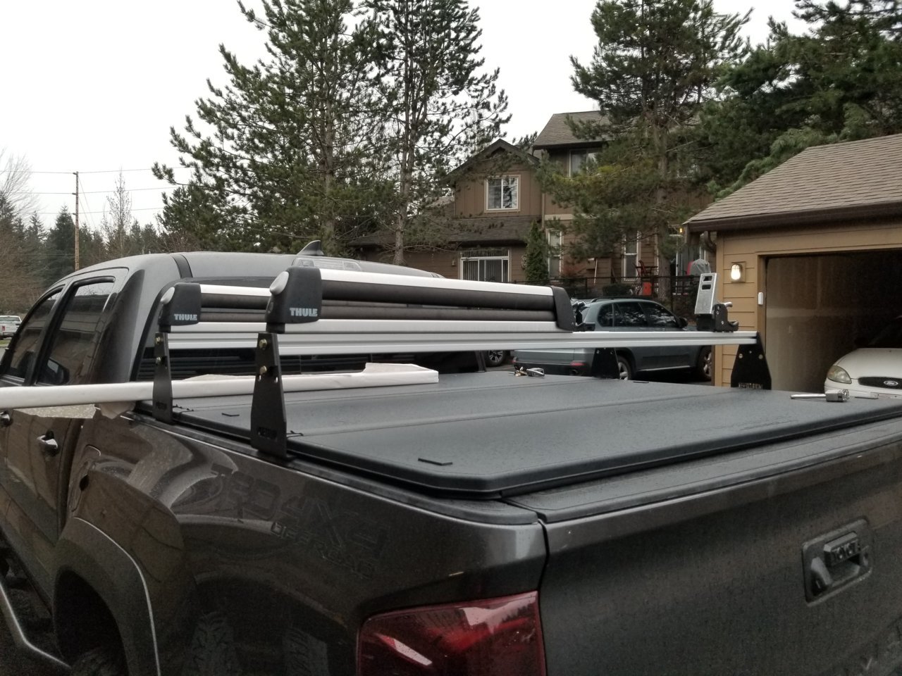

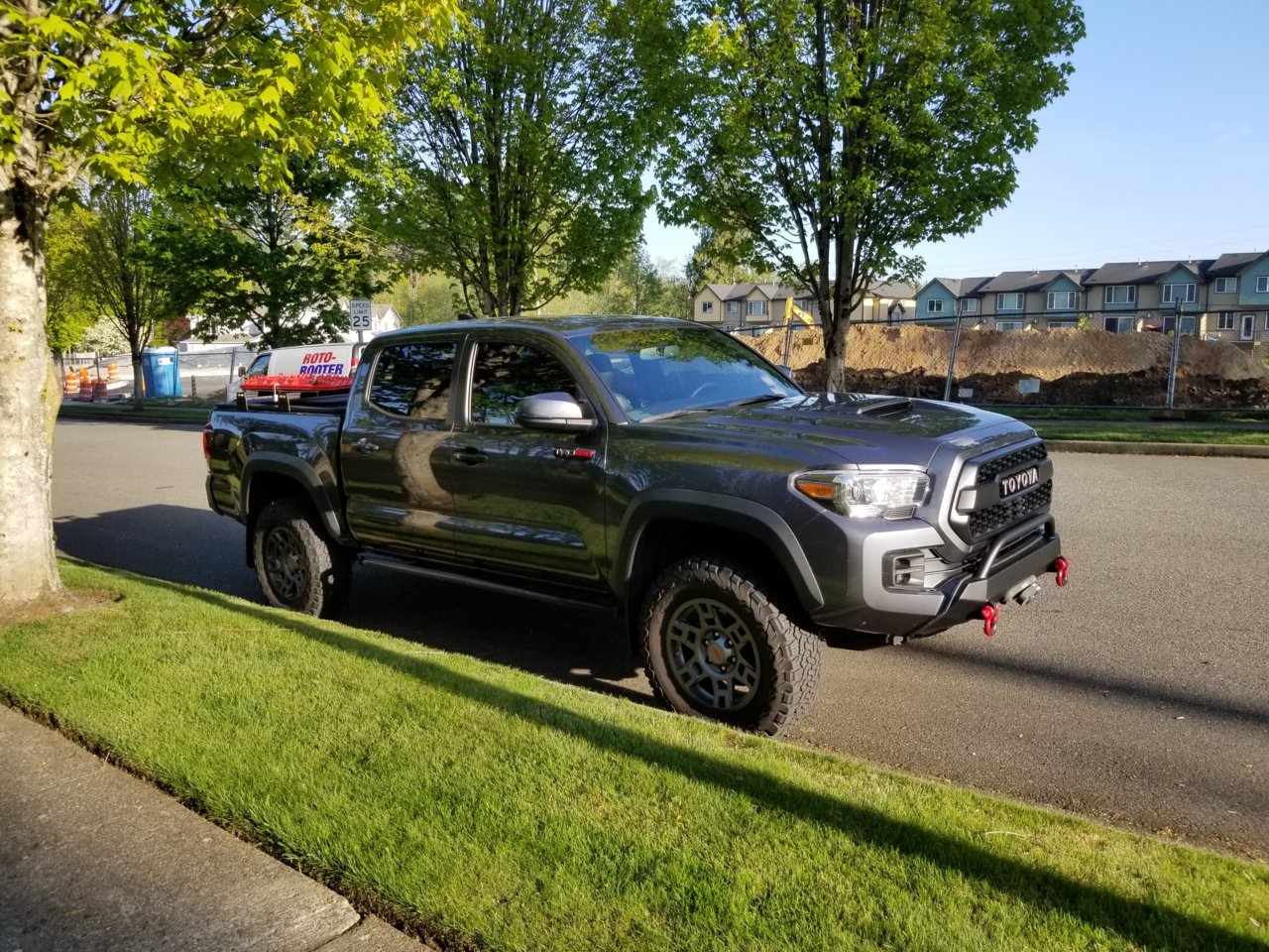

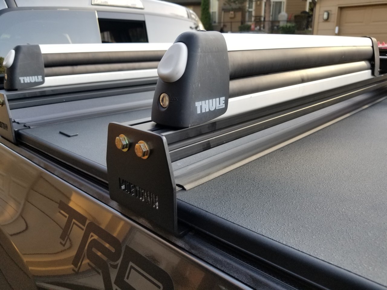

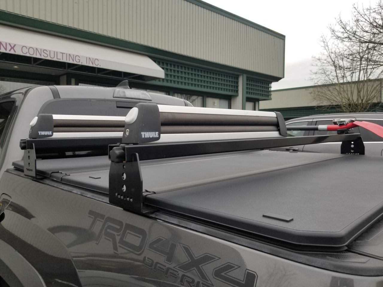

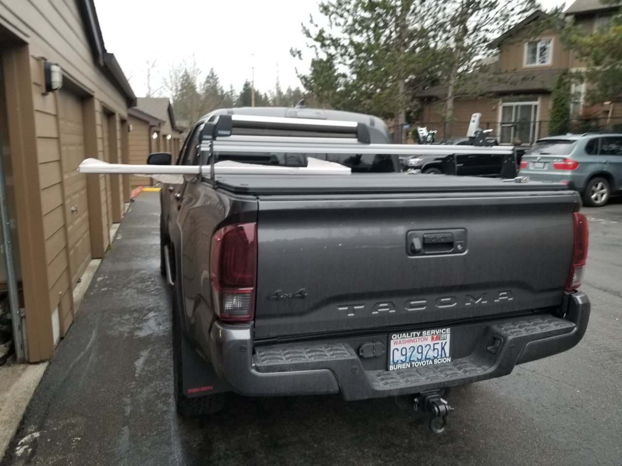

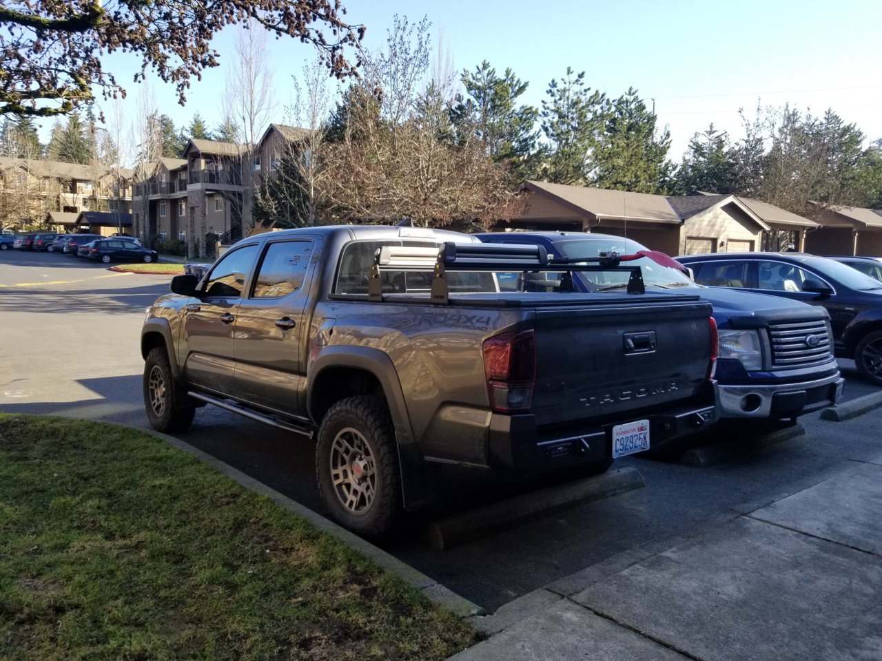

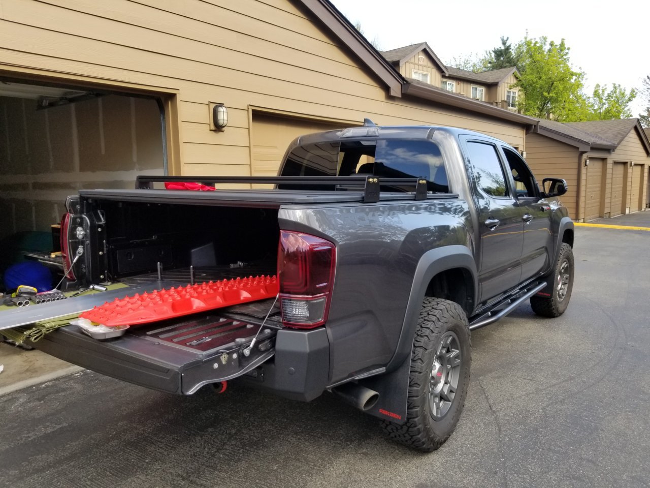

    I originally had some KB Voodoo Hi-rise bed bars that I really liked the look of. However, they started rusting on me, in less than a year.

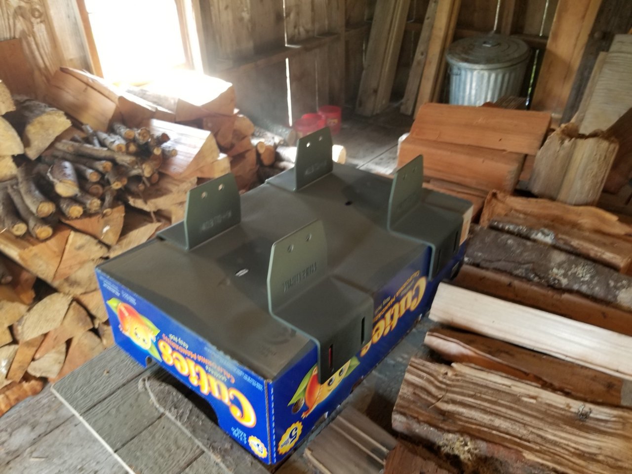

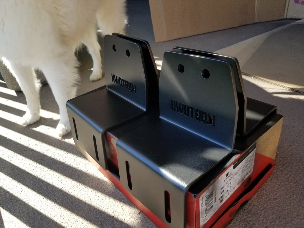

    So, I bought a set of Mobtown bed bars. I figured, if they started rusting, it would only be the vertical uprights, as the cross bars are aluminum, which, I could easily repaint.

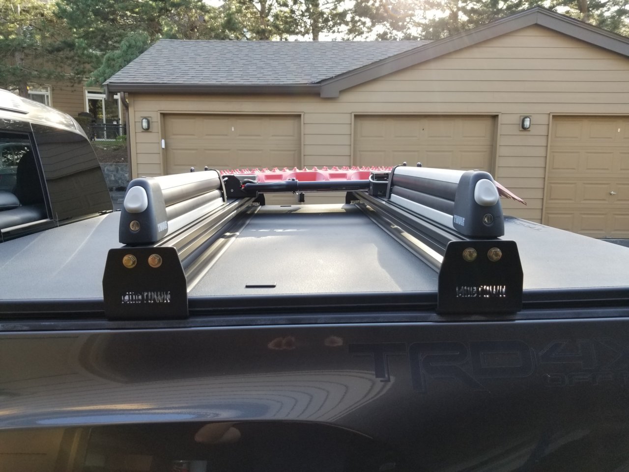

    Wasn't quite happy with the style of the Mobtown bed bars that I bought. I thought replacing the silver cross bars with black anodized bars would help. I ordered a set of bars from 80/20 and swapped them out.
    I still wasnt happy with them. Ultimately they were way too tall, and the cross bar was too skinny. So I chopped the vertical plates shorter, drilled new holes for the cross bars and repainted them.

    Those look much better chopped. Nice job

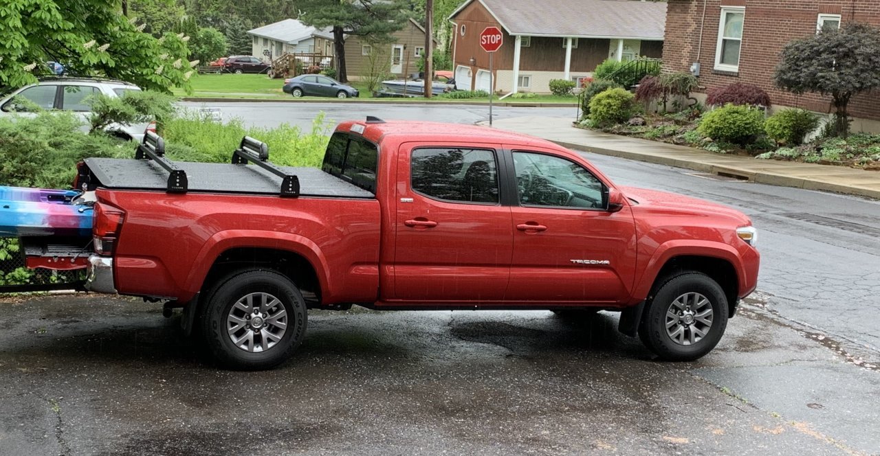

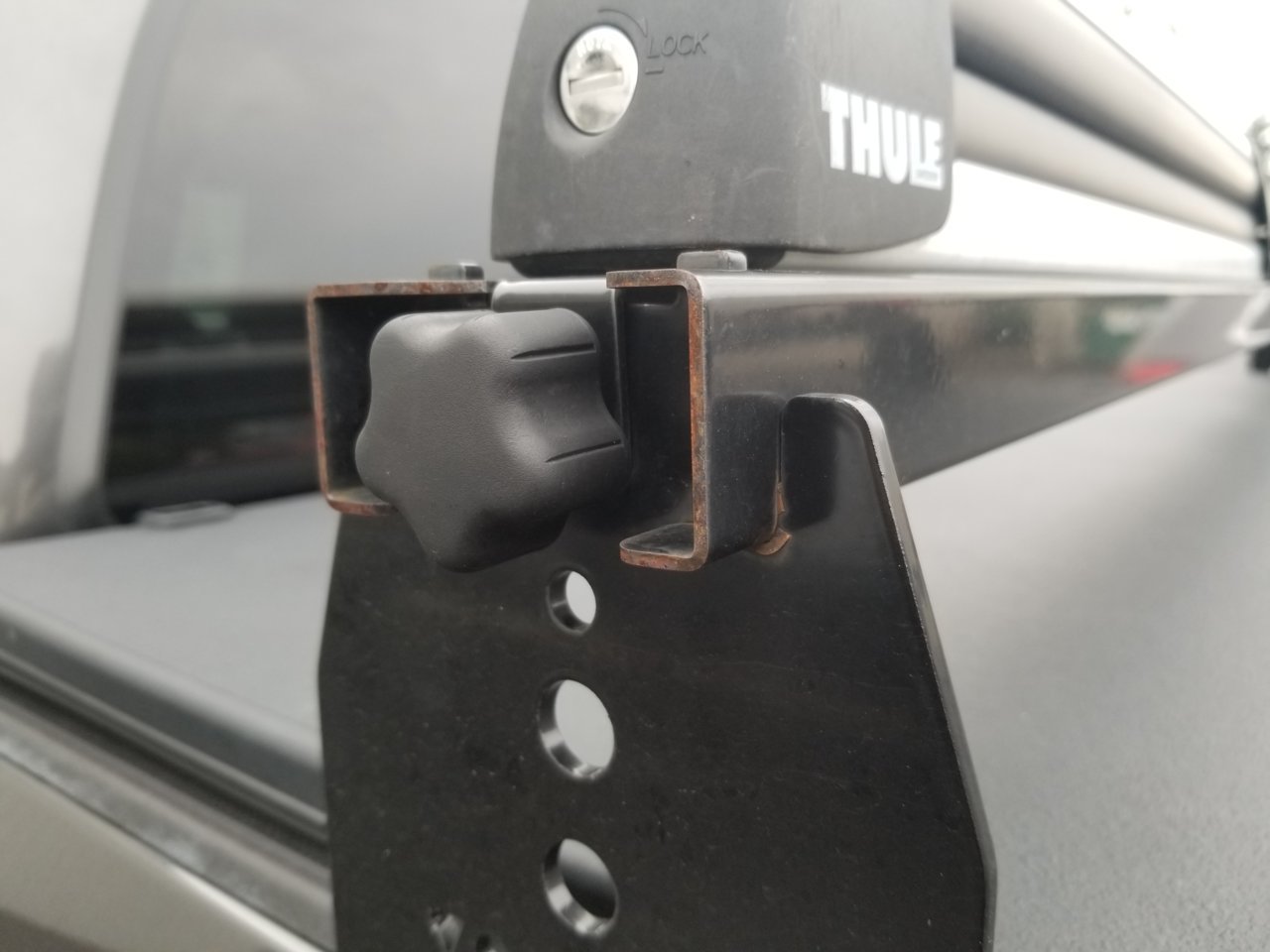

    The silver bars is why I didnt go with the mobtown ones (and i didnt really love the jdea of having to use T-slit bolts for everything).
    Did you look into getting the KB Voodoo rails refinished?
    Ive only had teh KB rails on for a day, but love the way they look. Hoping they dont rust. The finish in mine looms different than ive seen on other KB rail pictures, so hoping they really did fix the powder coating issue.CEF86163-17ED-4A2D-AF20-488A1978D951.jpg

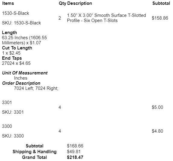

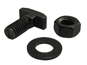

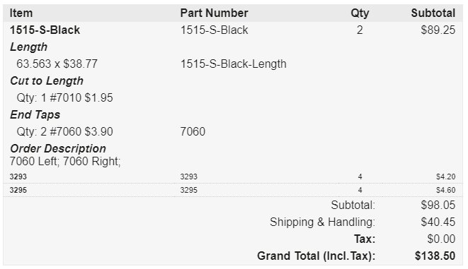

    Here is the invoice for the black horizontal bars (1.5"x1.5"). These are an exact replacement for the Mobtown bars, just black. I think the stock Mobtown tap size is 5/16"-18 (7060)
    Here is the invoice for the wider black horizontal bars (1.5"x3.0") that I used after I cut the Mobtown vertical supports. Note that the length changed, as I no longer "saddled" them in the vertical supports. I also increased the tap size to 3/8"-16 (7024) due to the larger shear force.
    Hope that helps!

    My man. This is cool. Thx, I may take a stab at it whenever I get the time. I assume 3301 and 3300 are bolts for your T slot accessories?... or were these pieces needed for something crucial to your install?

    Yeah, 3301 and 3300 are just the T-slot studs that 8020 sells. You can use a standard hex head bolt, but it just takes a little trickery to get them to work. You need to maintain tension on the bolt, so the head binds in the slot. These T-studs are an easier/lazier solution.
    Good luck!

    Think there's any decrease in carrying capacity to be noted with the non-saddled configuration Bert (like loading an averagely sized rooftop tent)? With the 2 larger diameter bolts in your setup, seems like it would still be sufficiently stout, yea?

    I would think there is probably less capacity, as you're relying on the shear force of the hardware and not the compressive force of the vertical uprights, but I'd suspect that it's still plenty of capacity to hold an average RTT. I probably wouldn't mount the larger Rainier or Denali CVT RTT's, but that's just me being conservative.
