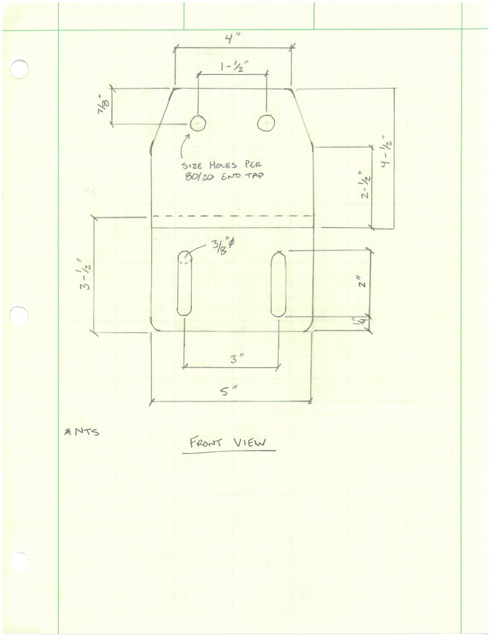

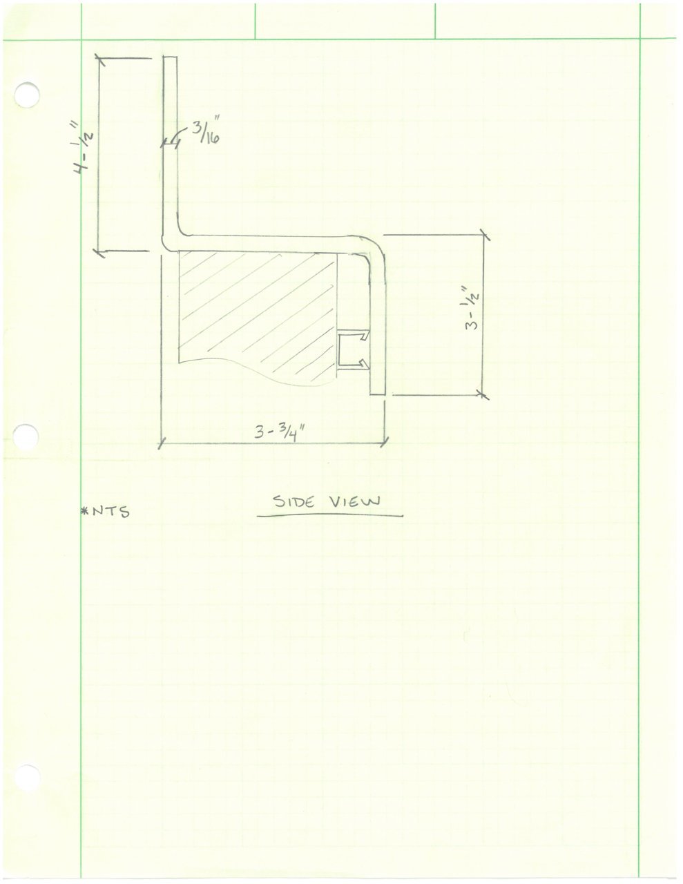

    Sorry to restart this but I'm interested in doing the same thing. Has anybody been able to buy just the low-rise brackets from @Mobtown Offroad to modify and purchase the 80/20 on their own? I sent an email last week but haven't heard back.

    I think you'll have better luck tagging them on the forum, than emailing them. @jowybyo @Mobtown Offroad
    That aside, I can also measure my uprights and post the dimensions. It should be a pretty easy/quick piece for a fab shop to cook up. That way you can avoid chopping up perfectly good parts.

    That's not a bad idea either if you wouldn't mind taking a look. Sent you a PM

    Hey Ryan,
    Below are the dimensions for my uprights. Feel free to modify the dimensions to best suit your needs. Good luck!SKM_C360i20041510150_0001.jpg SKM_C360i20041510150_0002.jpg

    Awesome, thank you!

    I see you completed this project. I saw your truck photo in another thread and was like "hey! that's what I did..."
    Nicely done, sir!

    Thanks, they look great! I meant to do a little write up on how it went but haven't gotten around to it.
