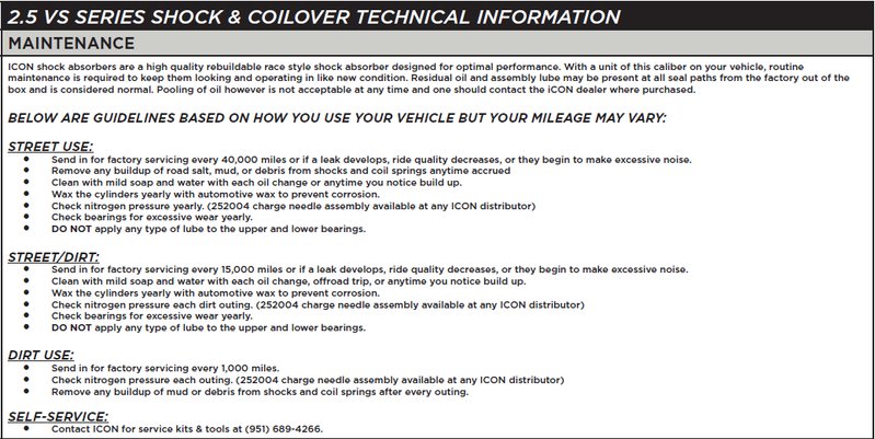

    @icon_rep what service interval do you guys recommend shock rebuilds? Is there any way a bit of a break could be cut if all 4 shocks were being done at the same time?

    We usually recommend service the shocks around 40,000 miles but can vary quite a bit depending on how they are used @digitaLbraVo . Here's a snippet of our recommend service intervals from our shock install instructions for a reference.
    We don't offer any package deals for shock service but there a lot of shops that can service shocks these days, some may offer discounts for multiple shocks. You'd just have to check around.
