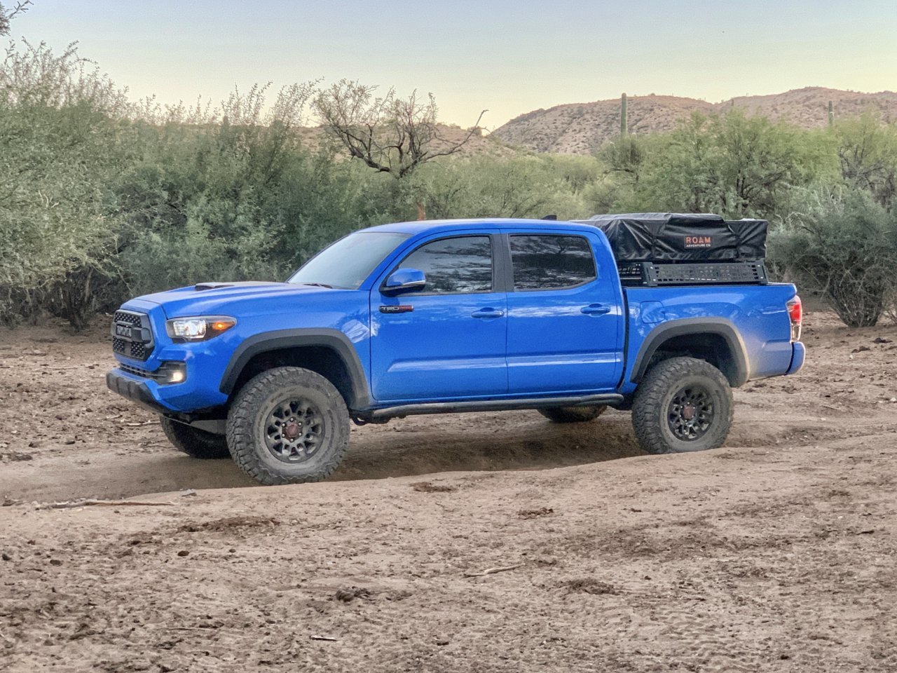

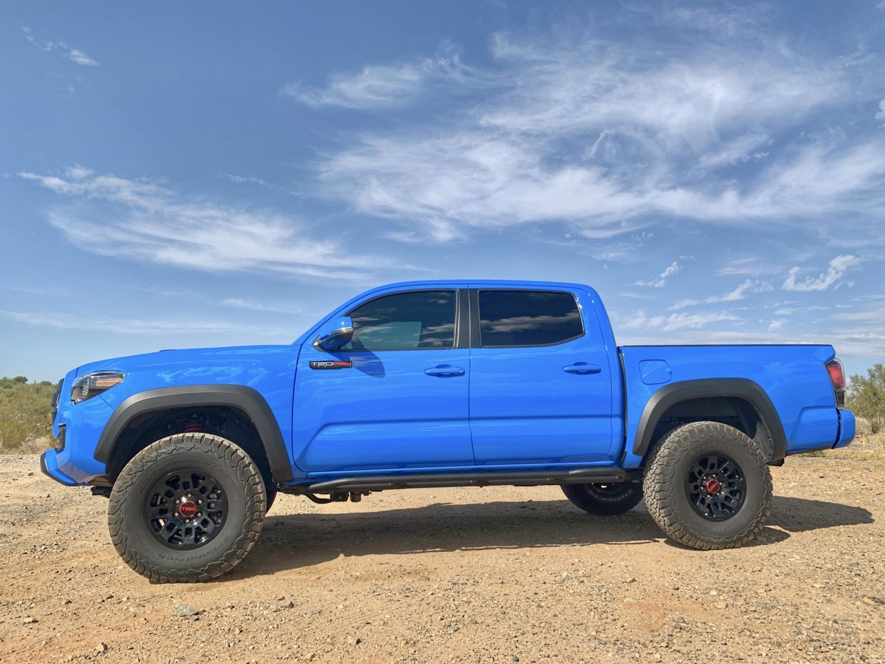

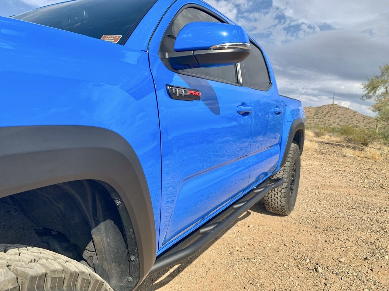

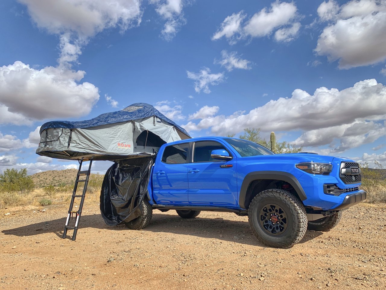

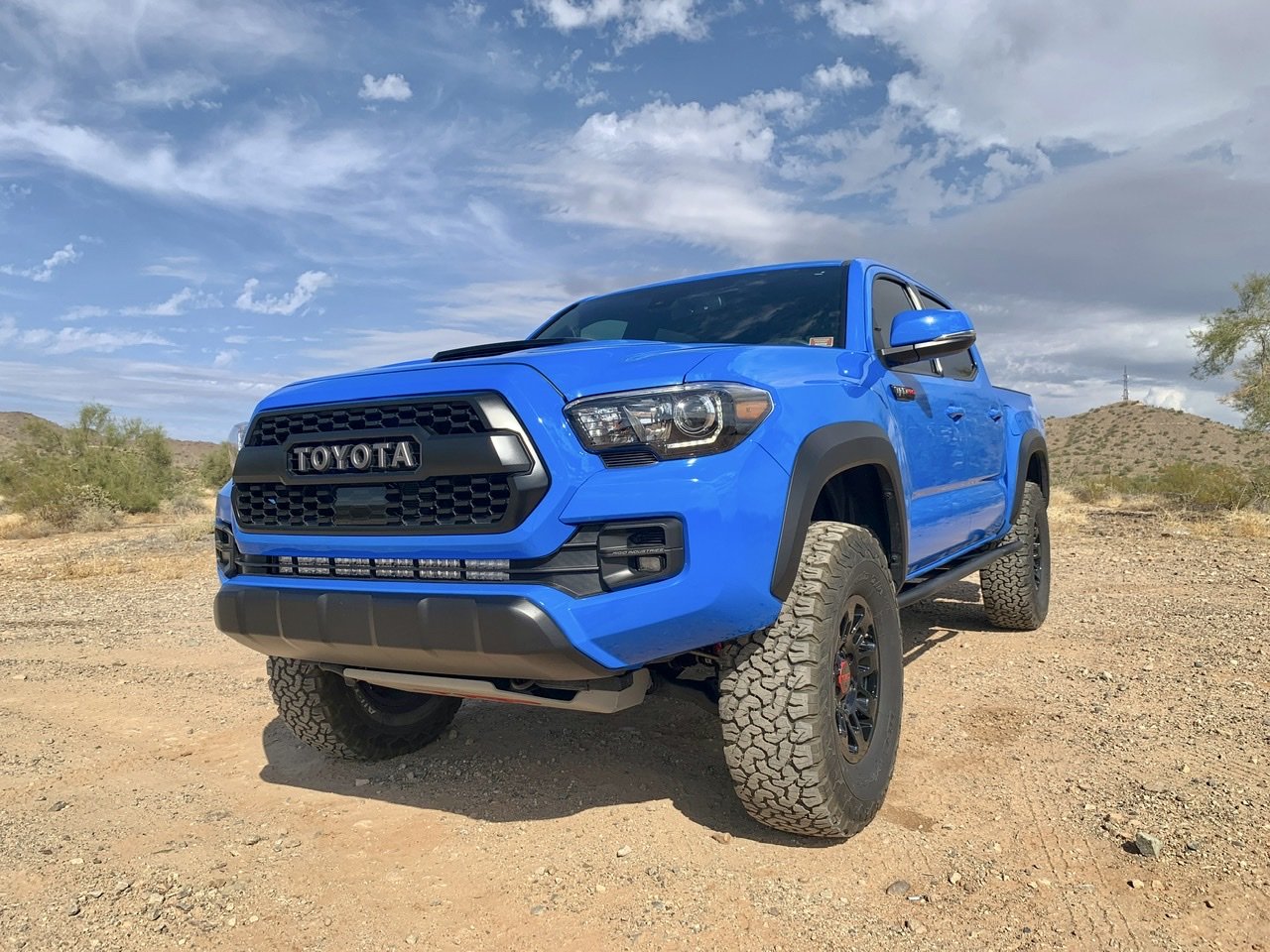

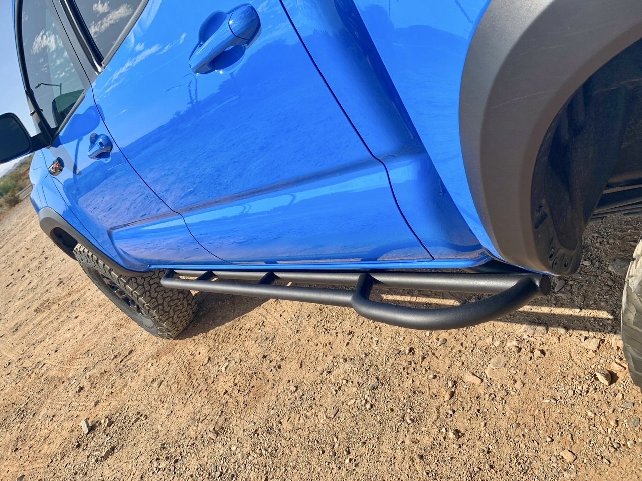

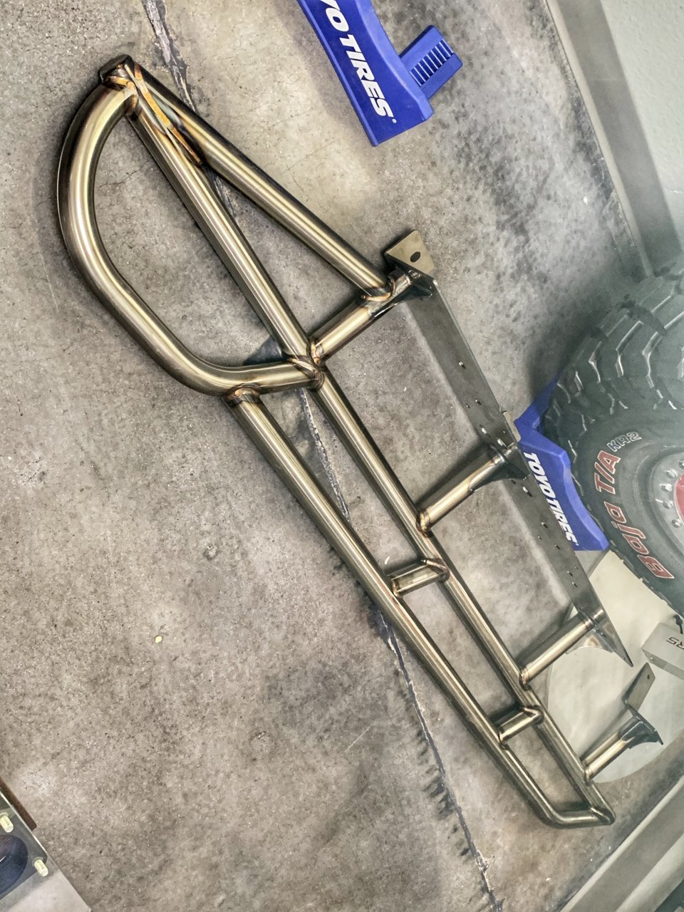

    Westcott sliders installed! Man those welds are so nice and almost makes you want to run them not powder coated black. I had them made with 20 degree angle to keep it clean with body lines. That paired up with the Westcott TRD Pro lift is money! If you haven’t checked out there stuff definitely do! They have a roof setup coming out soon and it looks awesome.

    Jeff, you think shorter folks can safely use them as a step or are they not meant for that purpose. Love that blue truck, man! So sharp! -Richard

    I used then yesterday as a step, it’s easier in the back then the front. If I wanted to use them as a step all the time I might go a little less the 20 degrees. With the 20, you can get the front part of your foot on easy but not much more. I wanted it curve with the body more.

    Those welds are gorgeous! I just ordered their TRD Pro lift kit. Is that what you're running? Your stance is exactly what I'm hoping to achieve! Any difference in ride quality? I ordered the front kit only, because I plan to install a progressive AAL in the rear to stiffen the OEM spring just a little (to account for a 180 lb. roof top tent mounted on top of a Diamondback HD tonneau cover). I'm actually hoping the front gets a tiny bit more firm than it is now, as I'm also adding some weight to the front end (10k winch and a low profile bumper insert).
    For those wondering about the differences between the 2017-2019 kit and the 2020+ Pro lift kits... - apparently the 2020 and onward version of the TRD Fox coilovers has a different coil spring than the 2017-2019 models, and therefore a different design on the lower spring perch. I didn't know which kit I needed to order, because I have a 2020 TRD Off Road (not a Pro), but I am installing TRD Pro suspension components from a 2019 model. I spoke with Jeff Westcott on the phone yesterday (super awesome guy, by the way!), and he explained that the new lower spring perch is "stepped" on the bottom, vs. the old one being a flat surface all the way around. He said that the very late production 2019 models actually have the new spring/perch design, too. Turns out mine are the "standard production" 2019 run, so they have the coil spring that is flat on the bottom and I needed the 2019 kit.

    that is the kit I am running. I will say it rides the same at stock, maybe slightly better but it’s hard to say for sure. It definitely doesn’t ride worse or anything like that. In my opinion it’s the perfect solution for Trd Pro’s that want to add a little more height without any beg benefits. Westcott makes some really really nice stuff as you can see from the welds. Worth every penny!

    Nice! I am digging that support bar from the last leg to the back of the slider. Look great on the truck too

    Depends on options, posted Link to store in org post . Mine were $950 basically with powder coating

    Nice looking rig Rukus. Seems well balanced and aggressive without being overstated. Stock wheels and tires or are those 33"? I've also been considering the Wescott lift and sliders. It seems like a nice solution to a complete suspension upgrade. Do you have any concerns (JFanaselle) with the suspension handling the added weight of the sliders, bumper, and a winch? Has Jeff with Wescott commented on that at all? Much appreciated.

    Those almost look too nice to beat up.

    Thanks, I am running 285/75/16’s so 33s on stock tires. I am running rack/tent setup now with no issues or concerns
