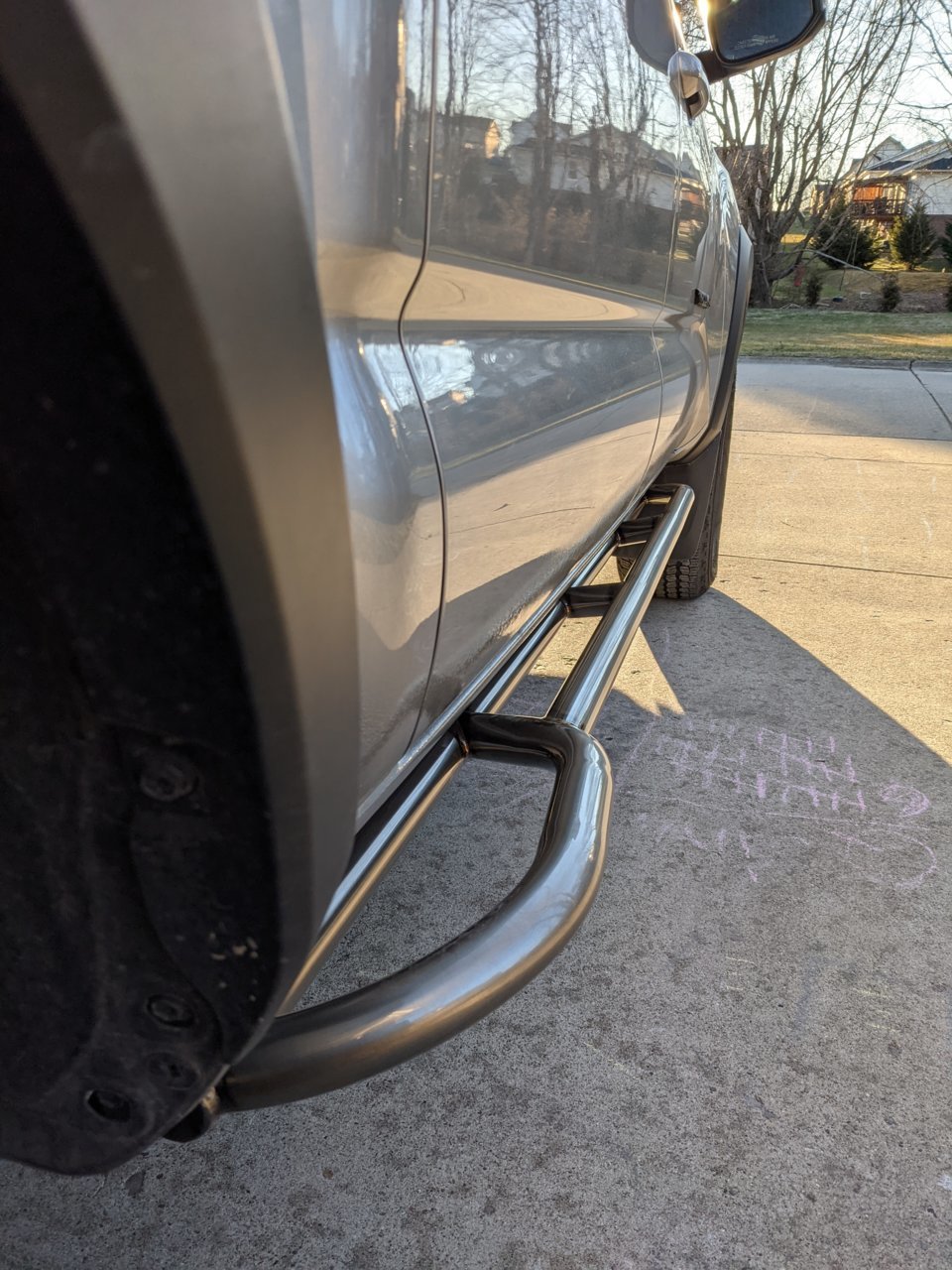

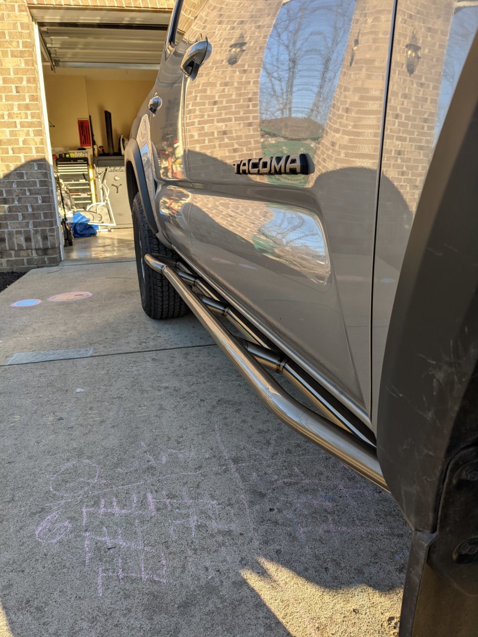

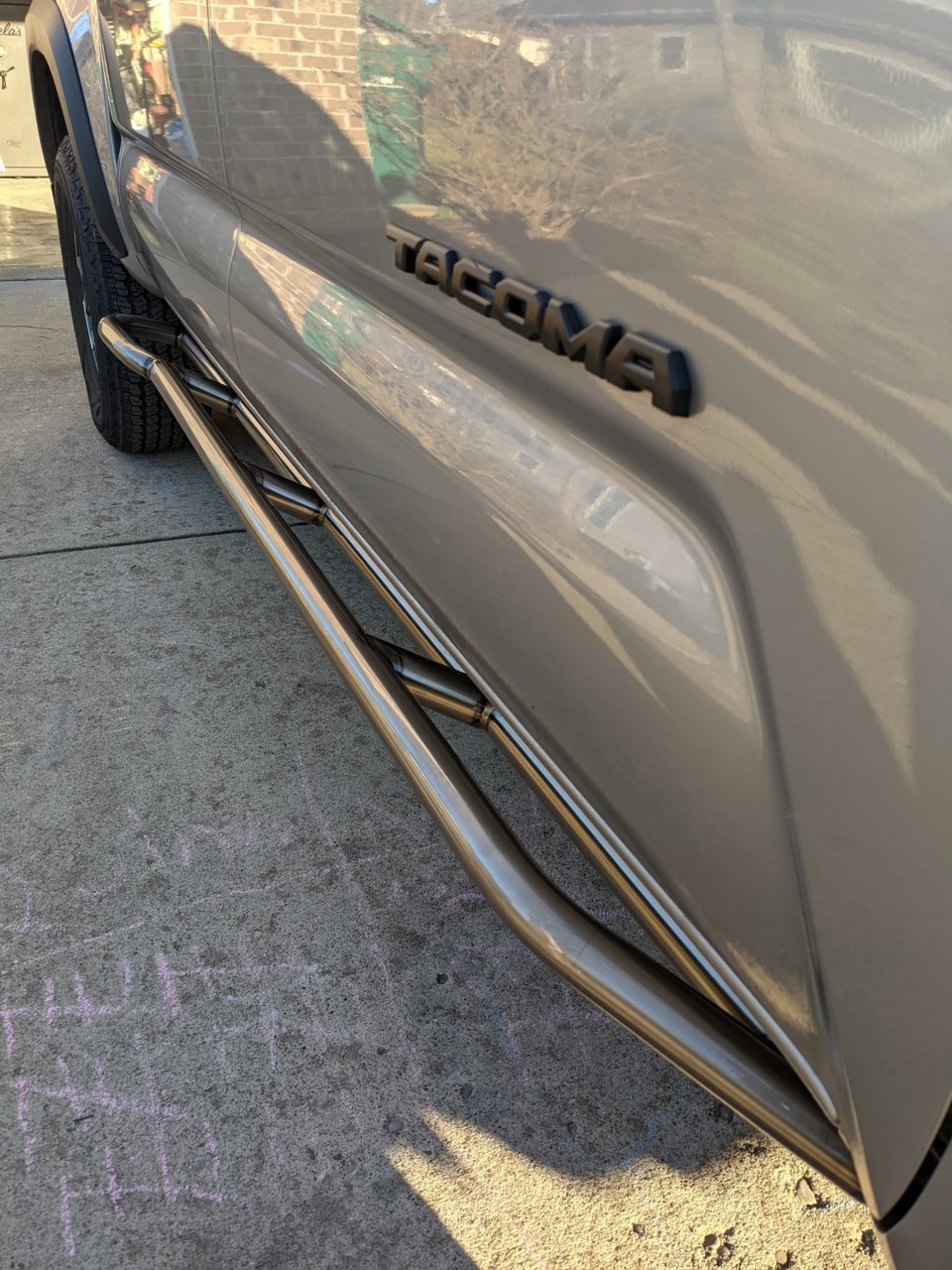

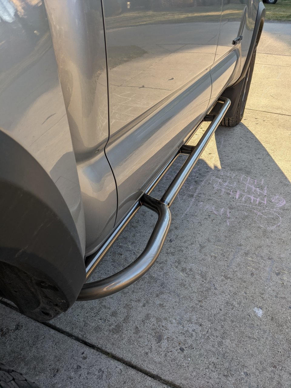

    Finally installed mine today..I didn't get many pics but here are a few. The quality of these are amazing. Money well spent.
    I went with the 20 degree because that seemed to fit the body lines better. I opted for clear powder coat because the welds are too nice to hide. :eek:

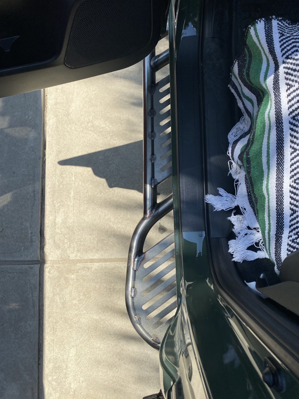

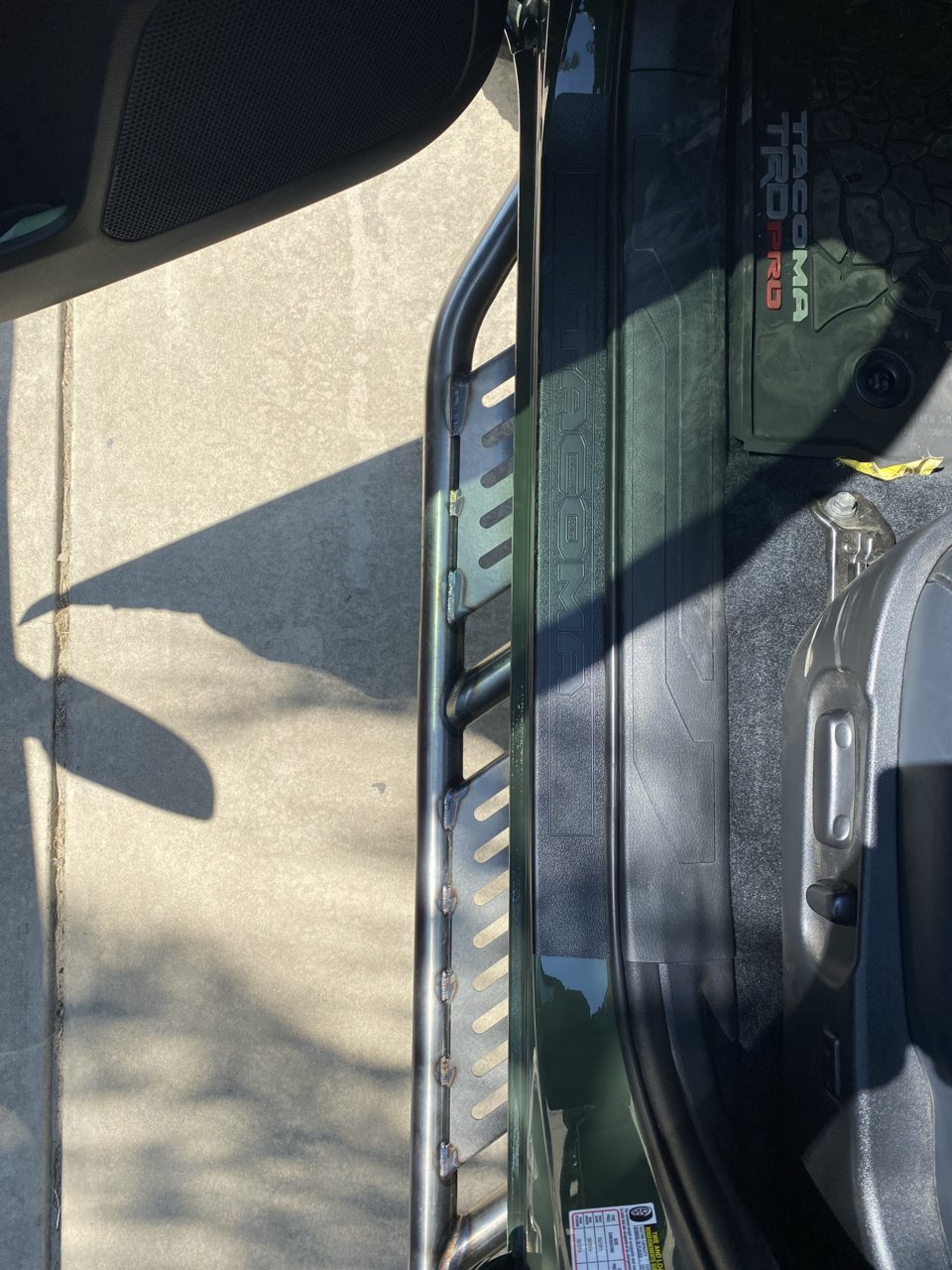

    Are these the 0 degree, or the 20?
    If they're the 0 would it be alright to get an over head picture with the door open to see how far out they sit?
    Thanks.
    galito[QUOTED] likes this.
  8. Jul 11, 2021 at 10:55 AM
    #48
    galito
    galito Well-Known Member
    Aug 4, 2020
    #336622
    261
    Edgardo
    Army Green TRD Pro 2020
    they’re The 0 degree set
