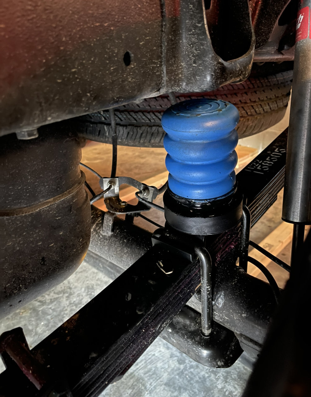

    Also check out sumo springs. They can combat sag when u have a load. I run them. It’s just a nice bump stop - there’s some videos on YT as well

    Was wondering if anyone was going to mention these. OP, Talk with their customer service to figure out which to get for your setup and planned use
    On my truck I had a fiberglass canopy stock suspension- in a year my rear sagged noticeably. I added a 3 leaf and the sumo springs and it raised me back up (plus a little extra). Perfect for my use and now I have no worry of extreme sagging loaded with the sumos and by extension prolonged leafs

  19. Jun 15, 2023 at 5:19 PM
    #19
    btiptacoma
    btiptacoma Active Member
    Feb 16, 2023
    #418084
    33
    Halloween likes this.
  20. Jun 15, 2023 at 5:24 PM
    #20
    Halloween
    Halloween Well-Known Member
    Nov 8, 2022
    #410220
    522
    Steve
    Toyotas a plenty
    Yes do this what btiptcoma said….
    looks like this except I went with blue (softer ones)
