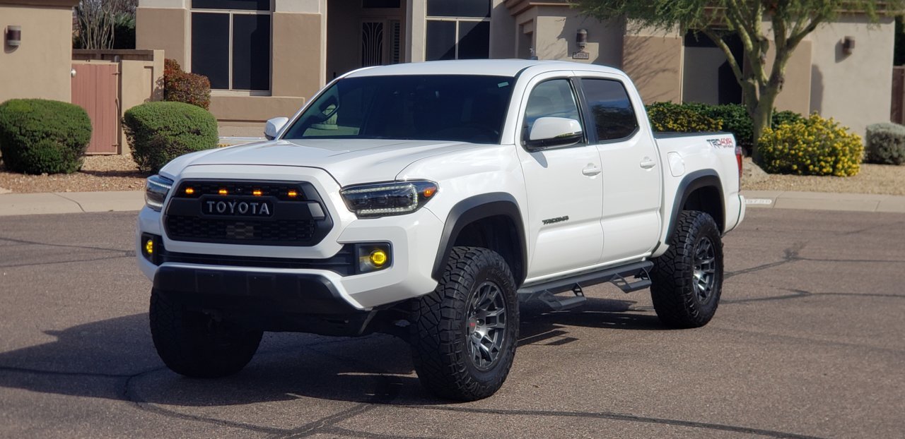

    As promised -- Here is how the kit looks installed.
    I still have the OEM TRD Pro UCAs installed. Notice their kit includes the spacers in the spring pack. Quality made, and they make them from aluminum pucks in house with a computerized lathe system. It was fascinating to watch how the machine makes them and then they powder coat them in house.
    This was how my truck looked before the kit was installed:
    This is afterwards... The Westcott TRD Pro Lift with a rear add-a-leaf, and Westcott 20-degree sliders DOM TIG Powder coated.
    Its subtle but a functionally substantial upgrade. I didn't want a Kona lift or anything overly aggressive. One of the key reasons I upgraded from my 2016 TRD-OR to the 2021 TRD Pro was that I wanted the TRD Pro Fox Shocks -- so it was worth saving up for 2 years to get the Westcott upgrade done.
    The kit didn't change the personality of the way the truck drives or steers. It is very smooth on the highway and very capable on trail roads. Eventually I will upgrade to Goodyear Duratracks that are 285 wide when my OEM ones wear out.
    Make sure that if you install the kit yourself that you've got a good shop you completely trust to do a fresh alignment. That was one of the key factors for me to make the 3 day whirlwind trip to Phoenix and back is to have the guys at Westcott do it professionally, and most importantly, right.
    Sam was my sales guy, Frank is the shop foreman, and Jeff is the owner of the company. All three guys are super nice, professional, and provided me some of the best customer service I've ever experienced.
