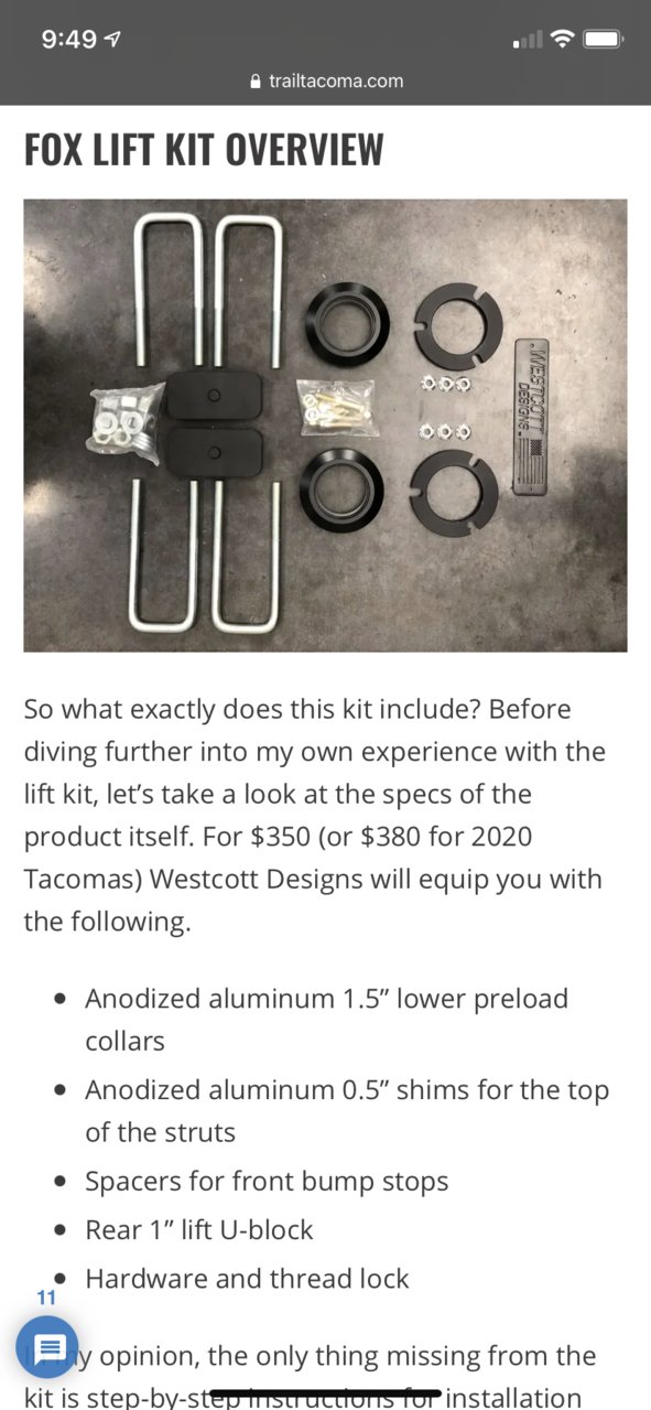

    Just did a read up on this westcott pro ‘lift kit’...
    “The preload collar at the bottom of the spring acts like a coil-over without the ability to adjust the height. In my discussions with Jeff Westcott, the owner, he shared the details about why this is not your typical spacer lift.
    A spacer sits on top of the strut, putting all the added stress at the top of the assembly. According to many forums and several conversations I’ve had, a spacer lift could lead to future damage to your Tacoma. The Wescott Designs kit incorporates an aluminum collar that seats perfectly on your strut assembly, giving your front suspension a boost. For the rear, there’s a simple lift block for the leaf springs.”
    But it IS a spacer lift... lol. Whenever you see the word ‘preload’ involved in your suspension you know that component is going to be limiting the travel of your strut or compression of your coil, or both. And after the article clearly states ‘a spacer sits on top of the strut, putting all the added stress on the assembly’, one of the four components in the kit is ‘Anodized aluminum 0.5” shims for the top of the struts’. Shims are spacers lol.
    Westcott is trying to say their Spacer lift kit doesn’t have any negative impact because the main 1.5” Spacer is going on the bottom of the coil as opposed to the top, and a smaller .5” spacer is going on the top of the strut.
    Revolutionary...

    I have 5100s on the front with Eibach coils, my rears leaked, replaced with 5160s - my buddy has run a spacer lift since 2014 and he is still on the original Toyota shocks.
    The Wescott kit lifts from the bottom of the coil like the collar on a 6112 does and it includes the front bump stop spacers, OP will be fine running it.
