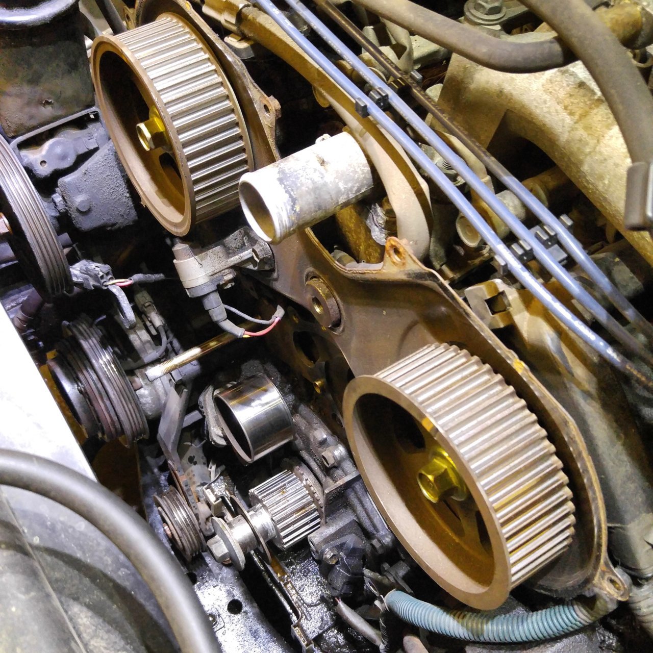

    Last one I did in my 1997 T4R

    Yup that’s what I have to look forward to. How was the job overall? Everything I read sounds like the bolt is pretty brutal.

    Probably the biggest pain in the ass of the whole process. I just use a big chain wrench and a big 1/2" breaker bar. Overall it's straight forward, might as well do the waterpump and thermostat while you're in there, check the cam and crank seals as well. I bought an Aisin kit off of rockauto since it would be OE parts

    I have a full OEM kit that multiple people on the T4R forum recommended including cam and crank seals. I’ve done a bunch of work to the truck up to this point, timing chain/belts just make me nervous. Off a tooth and you’re in a little trouble haha

    I think the 3.4 is a non-interference motor if I remember right. Let me know when you want to do it, hopefully indoors. Took me about 4 hours to do last time
