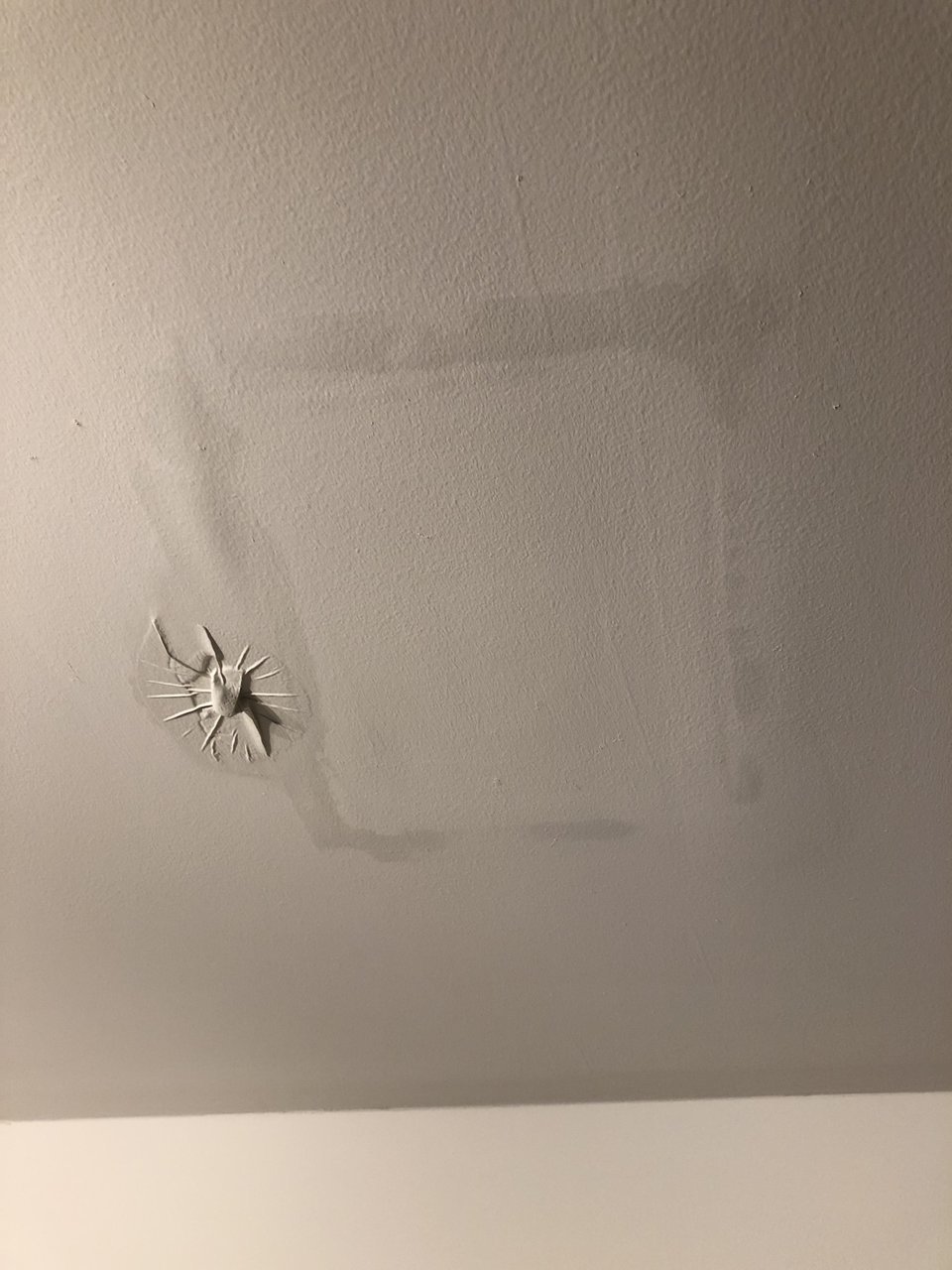

    Well took 4 loads of furniture and stuff to my daughters new house yesterday . They decided to spend the night even though they don’t have the CO yet . They filled the garden tub in the master bathroom and ............... this is the ceiling in the breakfast nook directly below the tub :mad:

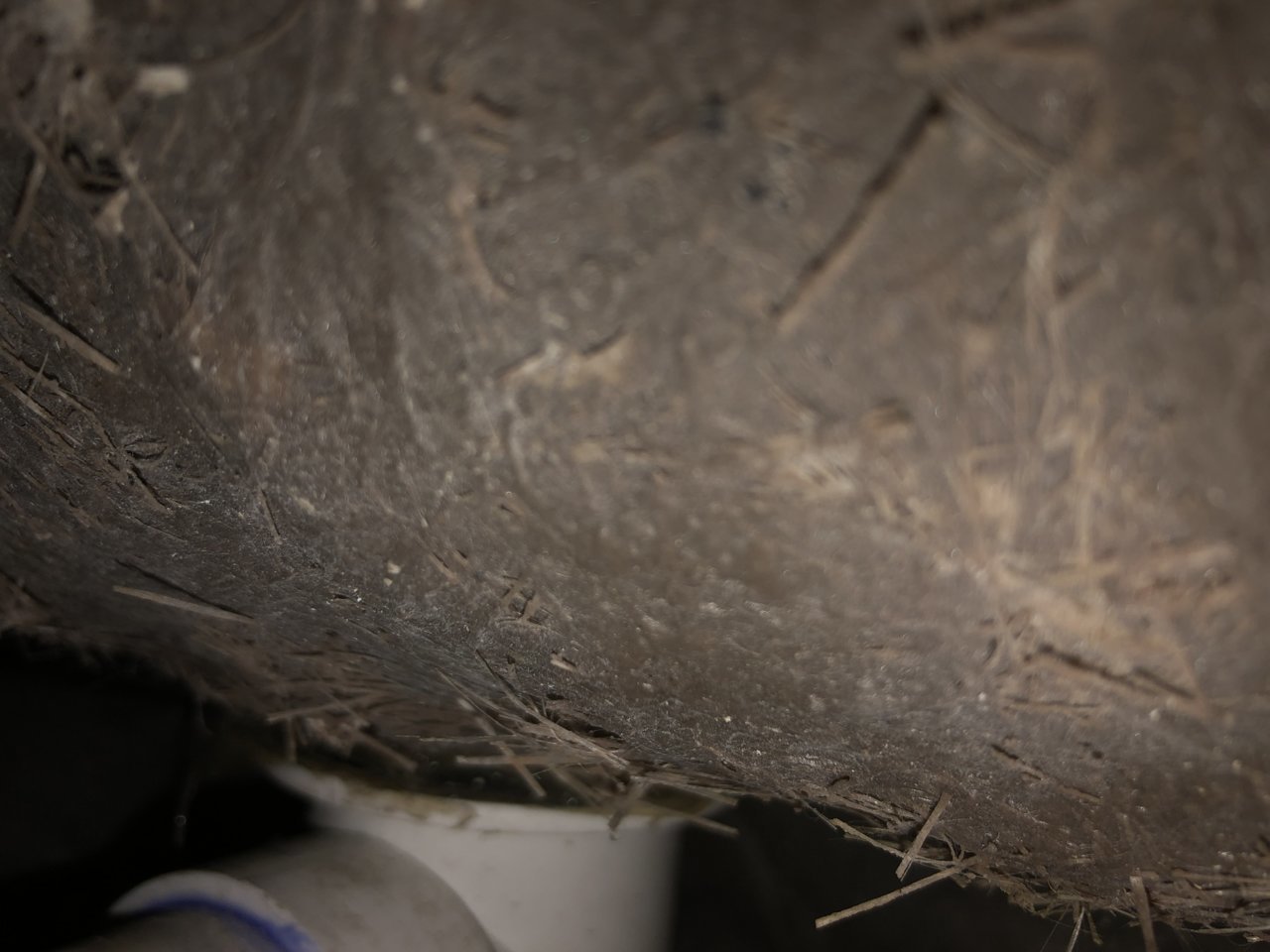

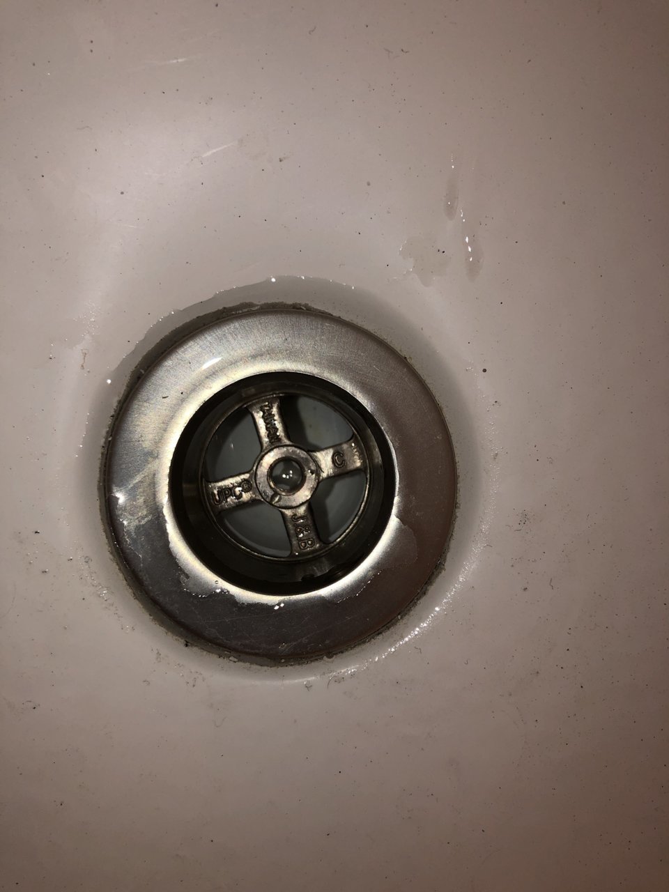

    Drove over 830 last night and removed access panel for tub and discovered a drip at the drain . Not enough plumbers putty :mad: from the factory. Unbelievable :annoyed: So I will be pulling drain out and doing it correctly. Bottom picture is where the drip is coming from . Right up tight on the bottom of tub where drain pipe enters .

    I guess when the plumbers checked for leaks they only ran the tub but didn’t fill it and let it sit .:mad:

    Damn drain in tub was 3/4 turn loose . Snugged it up and no leak .Glad it was that simple .
