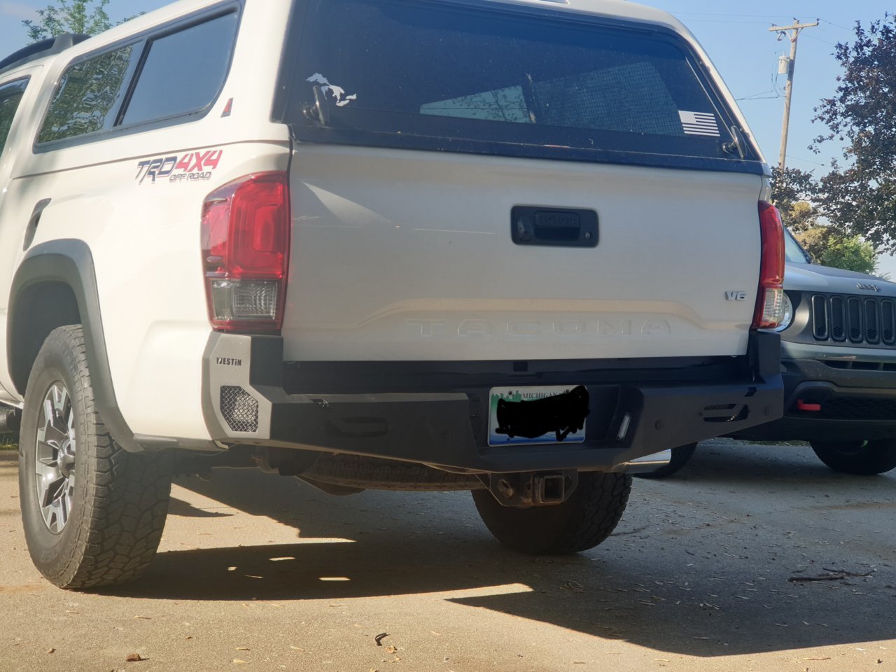

    Installed the bumper. Love the look. Bsm being a fickle b. Anyone have experience in adjusting and or recalibration to get it working?

    Talked to westin and they recommend i have the dealer calibrate but the dealer says the mesh is metal and thats the cause. So they recommend i cut out the mesh. I'm waiting to make a decision as I don't mind not using it for now. Backup sensors work fine and the bumper looks great.

    I was actually looking into the same bumper last year and found some documentation online that the wired mesh had to be removed for BSM to work.

    I posted a pic on anther thread,” BSM and aftermarket bumpers.” I did not have to remove the hitch. The bumper sits on top of the hitch. The bumper sits a little higher than the OEM bumper, and it is a lot better looking. The Westin bumper was a grand shipped. I read a thread on this forum saying the metal mesh interferes with the BSM radar so I went to a machine shop and had them remove the mesh before I installed the bumper. There is a bracket for each BSM in the corners of the bumper. Install the BSM’s before you mount the bumper. The bracket swivels so you can try to get the orientation right before you mount the bumper. The bracket can be adjusted with 2 bolts underneath the bumper. The BSM’s must be mounted horizontally at a 50 degree angle plus or minus 3 degrees and 90 degrees vertically. I bought a digital compass to help me get it right. When you remove the OEM bumper, be careful removing the parking spot monitors. They are very delicate. I had to cut a lot of the factory zip ties to stretch the cables to the BSM’s. I also had to buy an extension for the electrical connection for the hitch. The Westin bumper comes with 2 LED license plate lights. Of course, the connectors don’t match the OEM ones so you have to cut them off and wire them directly. Turn the BSM switch OFF on the dash until you are ready to road test. If you have them oriented correctly, I think you can avoid a trip to Toyota. At first, I did not research the required orientation, and the BSM system faulted within 30 minutes of driving. Once you get the BSM Unavailable message, only Toyota can clear it with their Techstream software. An OBD will not clear the fault. I initially replaced a corner cap and bracket, which was cracked, that held the BSM, and everything worked fine, but I decided I needed more protection. On the OEM bumper, a thin piece of plastic is all that separates the BSM from an expensive repair. That’s the reason I sprung for the metal bumper. The good news is I have a sharper looking bumper and have retained the functionality of both the BSM’s and the Parking Spot Monitors.
