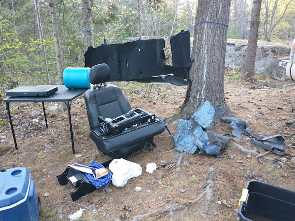

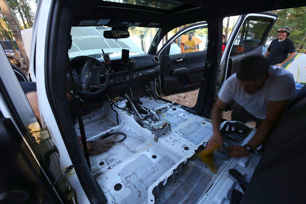

    If you plan to flood the truck on a recurring basis, replace the foam underpad insulation under the carpet with waterproof foil insulation (Noico, Dynamat, etc.).
    These pictures are from a trail run last spring. One guy got a couple of inches of water in the cab. We stripped the interior at camp and flushed the carpet in the lake, then hang it to dry. Bolted the seats back in on bare metal floors. He finished the trails the next day and drove 300 miles home with no issues.
    AL9nZEUEallzSjoy_tqXjGKhS06Jtp767cZ1KUar_7419671c3d5fca0874a28f9aae5b36a3080a7a2a.jpg AL9nZEWpI628bnAKpk4Uw_GzSOAceoYn_NMgQyEW_bc6fdbc9dc0c64709b65f093eebf9da67ce800f3.jpg
    There's no need to pop the drain grommets on the floor because the doorsills are level with the floor on our trucks.
    Carry a spare engine air filter on the trail in case it gets soaked.
    Have a spare starter at home. Once the starter gets soaked, chances are it'll die within a month.
