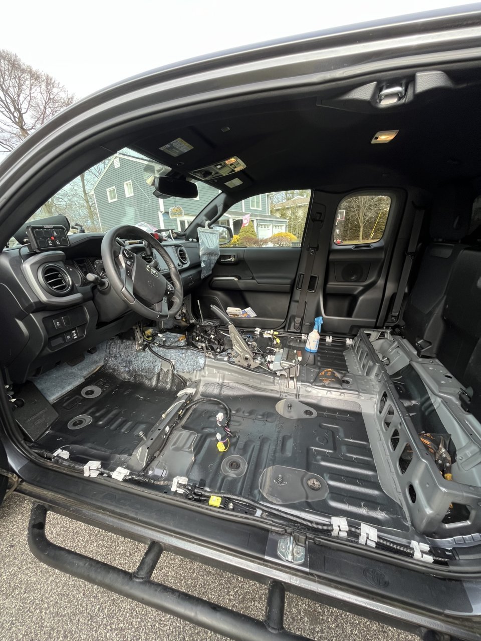

    I have flooded my truck 3 times (had a leak in the cab). Only way to dry it out is to remove all of the carpet, and take the insulation padding out and let it air dry. It takes about 24-48 hours for that stuff to dry out properly, and you’ll need to cut it to get it all out. It’s a huge effing pain but it’s the only way to properly dry it out. Mine stayed wet for 4 months before I found out the source of the smell

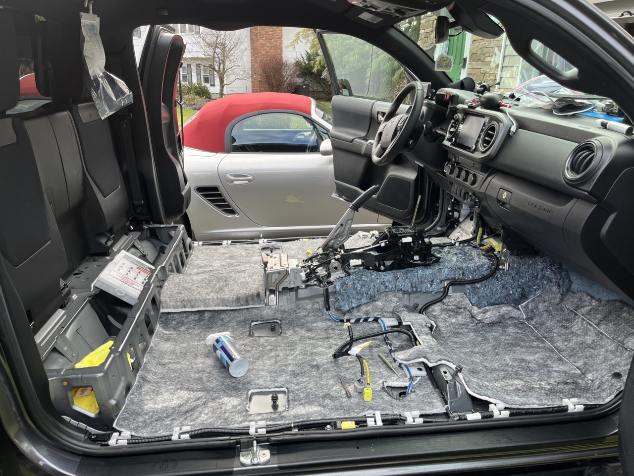

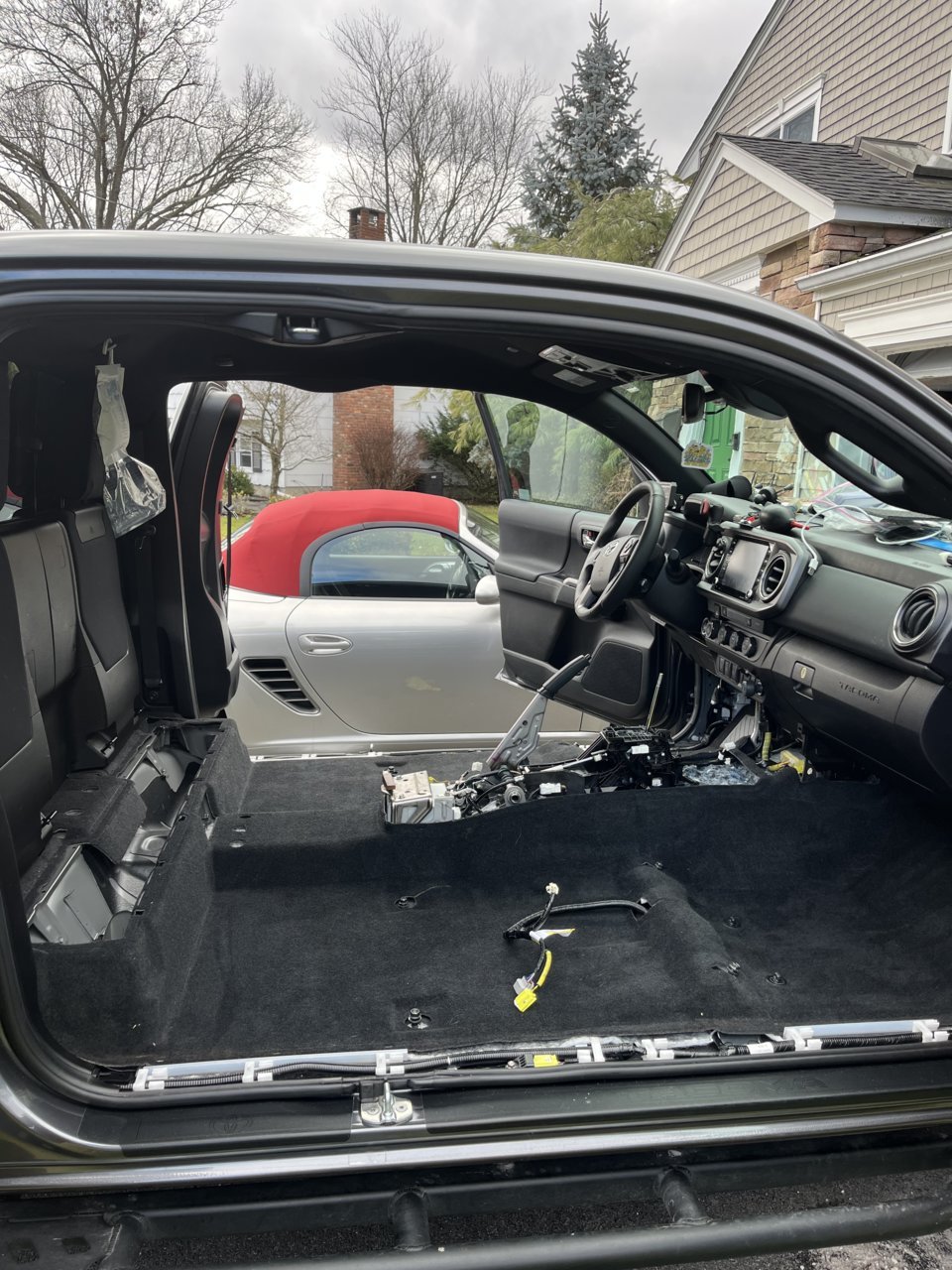

    Little update for everyone: I ended up pulling the interior about two days after flooding it. I was able to save the black carpet by drill brush and extracting it in my basement. The under carpet was saturated with mud so I replaced it with Boommat Under Carpet insulation. I don't really notice any difference in cabin noise but at least the interior isn't wet.
    Before reinstalling everything I checked all of the connectors for water, cleaned the floor with detailing spray, and ceramic coated all interior pieces. It smells and feels like a new car now. Thanks for all the help everyone!
