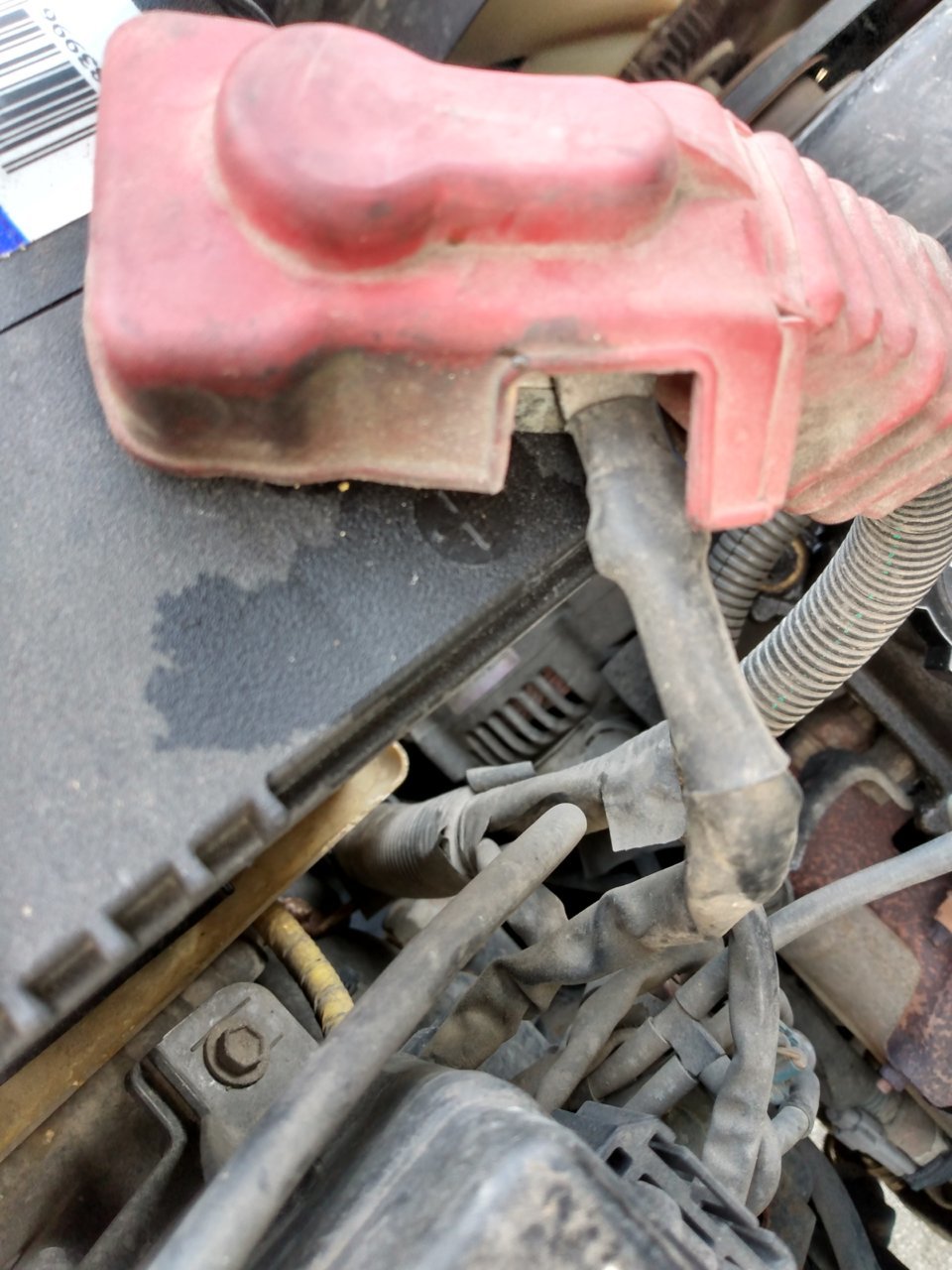

    I had recently disconnected the battery to work on internal electrical. Would overtightening the bolt cause this?

    It's less Tacoma and more mod
    Wet cell batteries leak sometimes, they're not a perfectly sealed design, to avoid any damage make a mix of baking soda and water and clean the terminal and around the terminal with it, that neutralizes the battery fluids.

    Keep in an eye on things an over charging battery tends to push out acid

    Over-tightening the clamp bolt won't cause any harm, but if you crank down on it you stand a chance of loosening the post where it goes into the battery and that will cause a leak.

    Agreed with Zane on this one. After cleaning it, if it has filler caps pull those suckers off of there and see if the levels are low. Might need to add some distilled water.

    Unless you need to physically remove the battery for your work, disconnecting the negative cable is all you need to do.

    Overfilling or overcharging can both cause leaks. Its also possible if you really crank on a post.
    A leaky battery isn't necessarily a dead battery - but it can start wreaking havoc on any metal it touches if you don't clean it immediately and regularly. Let it go for too long and you're going to have to start replacing clamps and/or cables. Ask me how I know.
