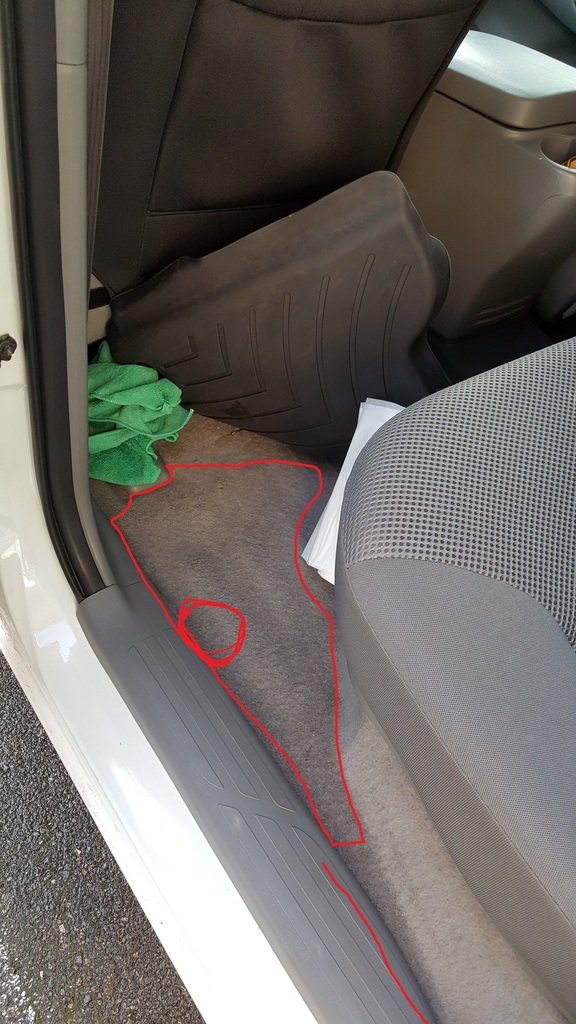

    Last year : I smelled a little bit of musty smell when I got in my truck. First thing I thought was wetness somewhere. I felt around my carpets and right behind my driver seat it was soaked, from bottom left of where my seat bolts to the floor , over to the door entry protector and up the side of the floor to base of back seat.
    I got up under my truck and noticed a shitload of small holes right under where my driver seat is. I got up and looked under the carpet of my backseat and sure as shit there were 6 holes in 4 different spots (24 fucking screw holes) under the seat (99.9% positive he had an amp mounted, unmounted, mounted, etc over and over again under there) so i figured that might be it.
    I filled the holes with silicone and called it good. To make sure, I put the truck in the garage in the dark and put a worklight under the truck to see if there were any other holes I missed where light might be shining thru. I looked under carpet and holes were filled. Then I saw about an 8" gap in my pinch weld underneath the plastic entry cap that had light shining thru. Filled the bitch with silicone until whole thing was filled up. Put entry cap back on and called it done. I extracted the water out of my carpet and shampooed it and all good.
    I checked it after 2 late spring rain storms and everything seemed fine. Then summer hit and I didn't worry about it.

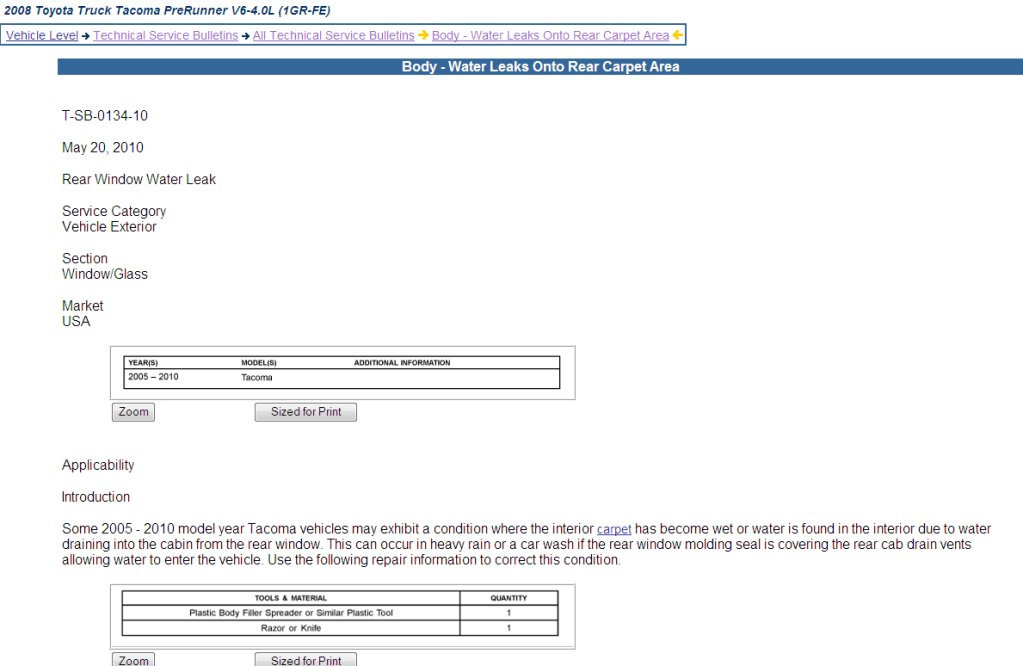

    So onto this fucking winter: Last week i smelled the musty smell again so I checked that area and it was fucking soaked (THE RED CIRCLED AREA IS THE WET PART in pic and the small red circle area within the red circled area is the wettest). I got under truck to see if any body plugs were missing and they were all (from what I found)in and looked fine. I took off that plastic entry guard and there was a little water coming down from back seat area (THE RED LINE ON PLASTIC ENTRY GUARD IN PIC) which led me to believe a leaking sliding window???

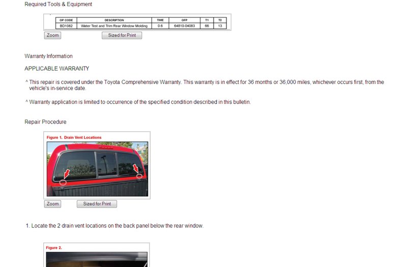

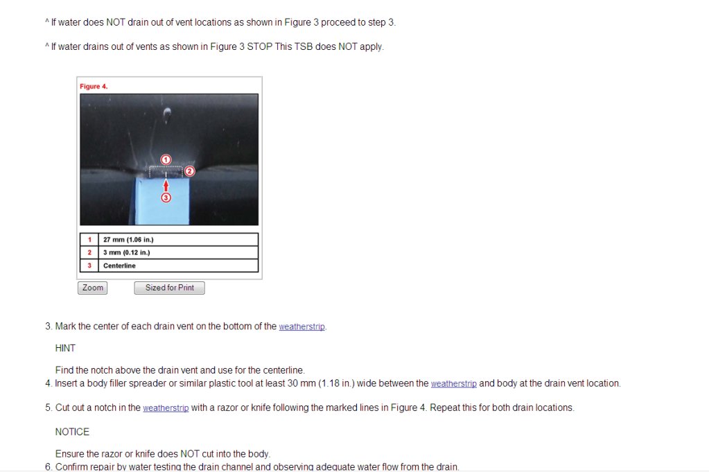

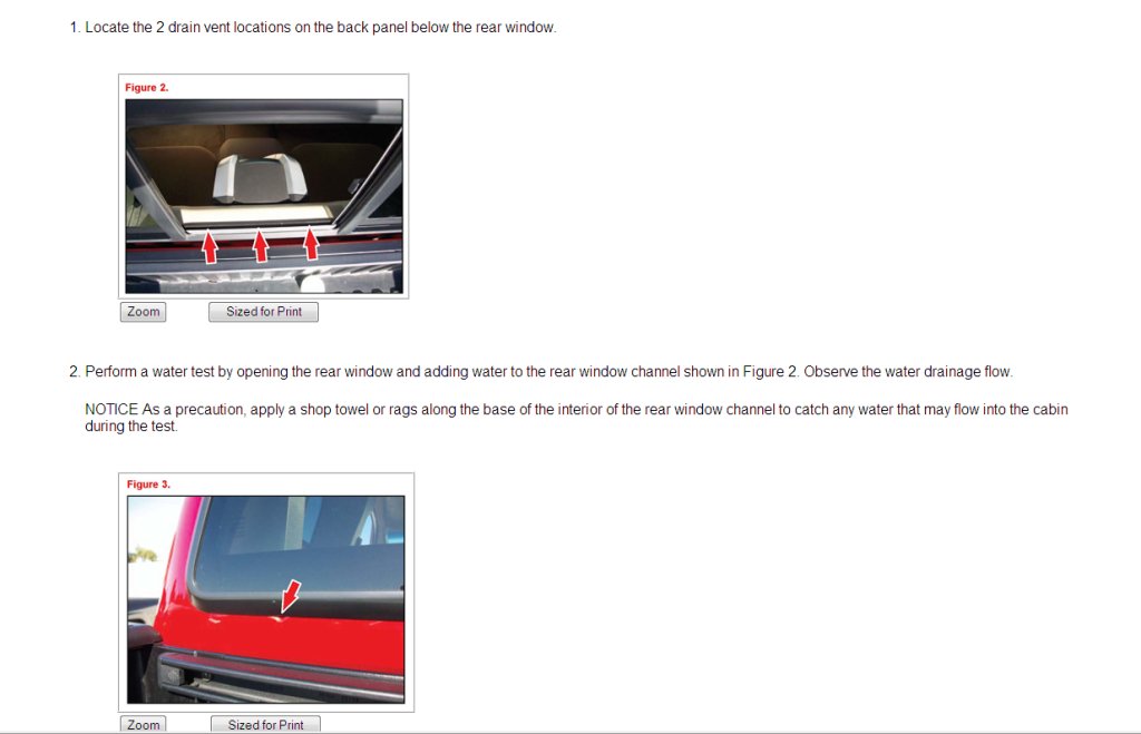

    I did more research and what I found was a TSB from 2010 that Toyota did not
    send me!!!!!:mad:

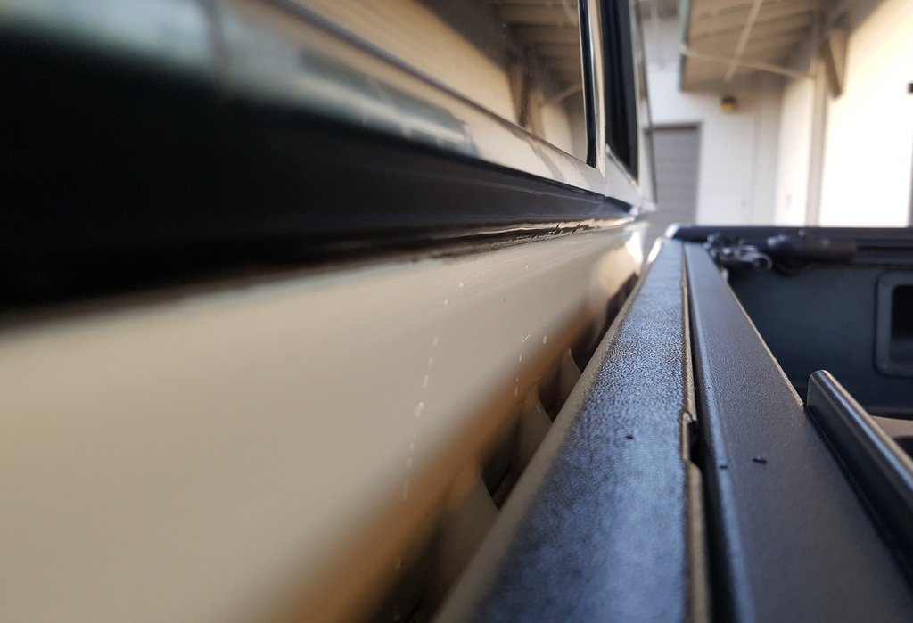

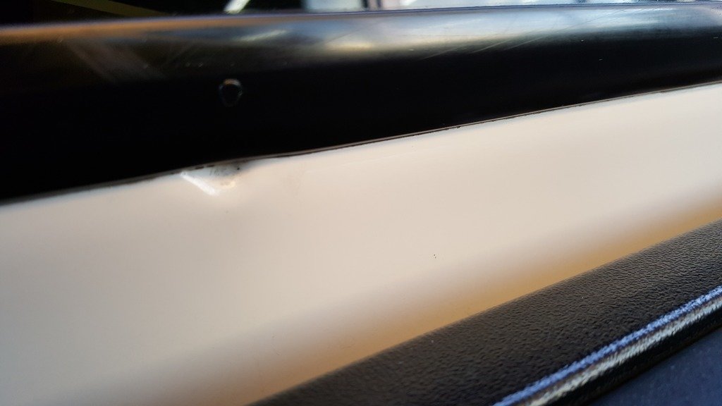

    I put a Q-Tip in each drain hole under back window and moved it around in there. I then did the TSB water test and poured water into channel. Nothing came out of drain holes.
    I noticed water coming from under the window seal to the left of the window though:mad:.
    Went out and looked just now and there was a small trickle coming out of left side drain hole but not much. Right drain hole bone dry.

    Had the same problem as you on my 2010. New rear window seal installed under warranty though. No problems since.

    ^^^This is what I needed to hear. Thanks man. Guess I'll get a new window seal.
