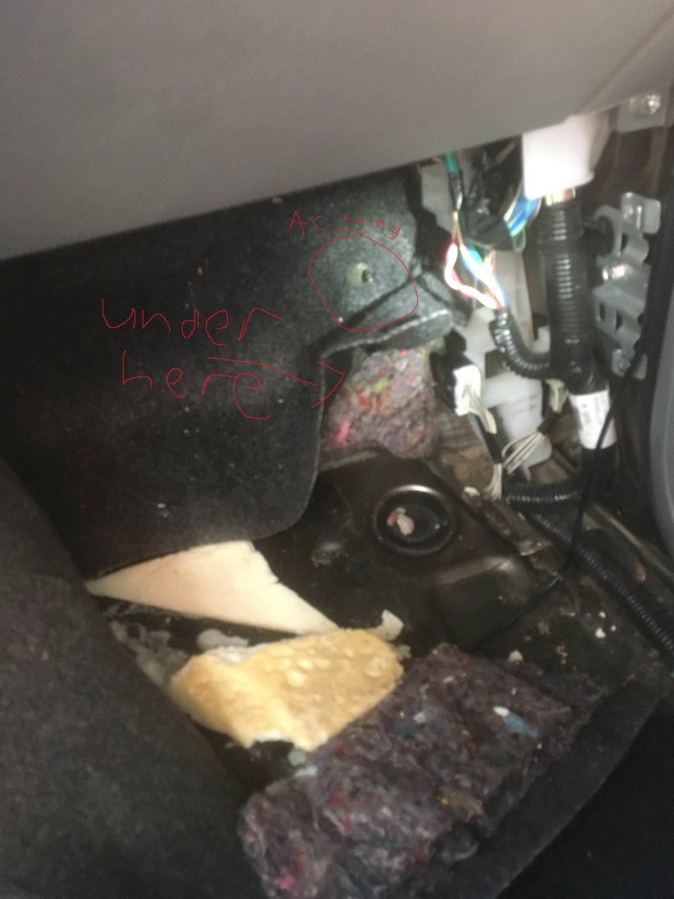

    @R490 ima have to check that as well, it did rain pretty good here for a few days in Cali

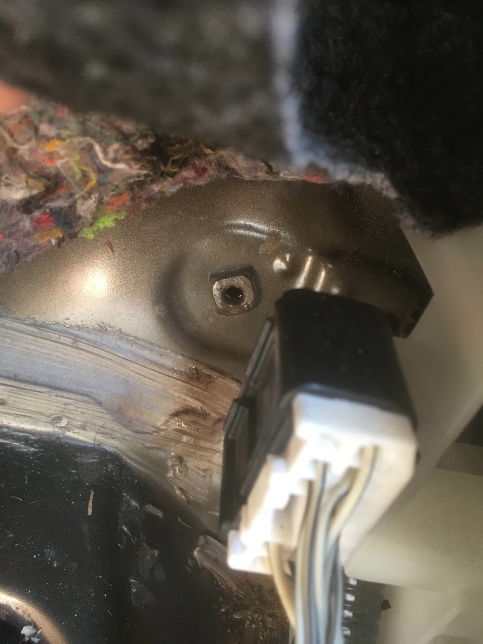

    Just in case, this is where the hole was.

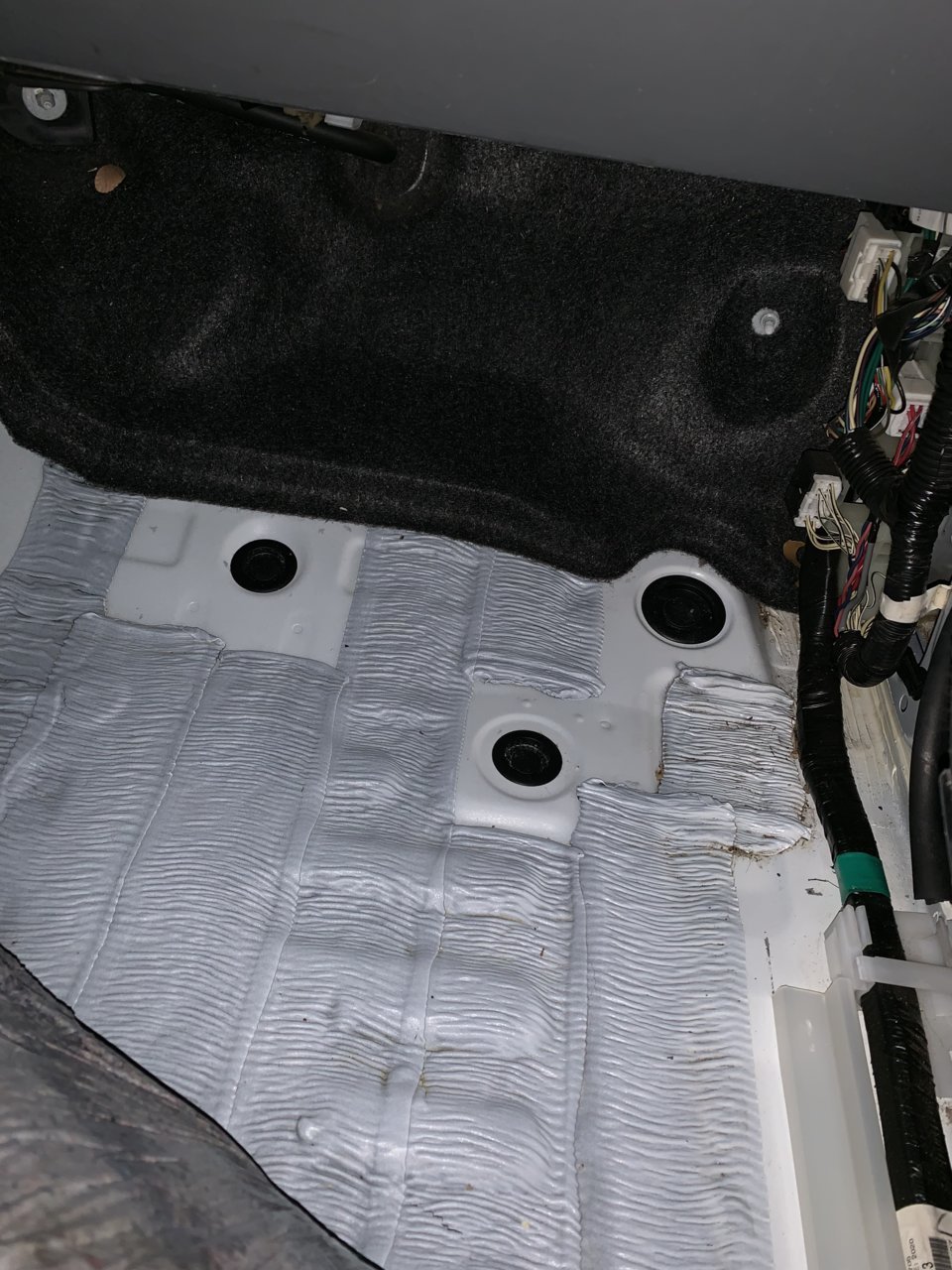

    @R490 see all that top area is bone dry
    The bottom is soaked

    None
    Top is bone dry and bottom is soaked
