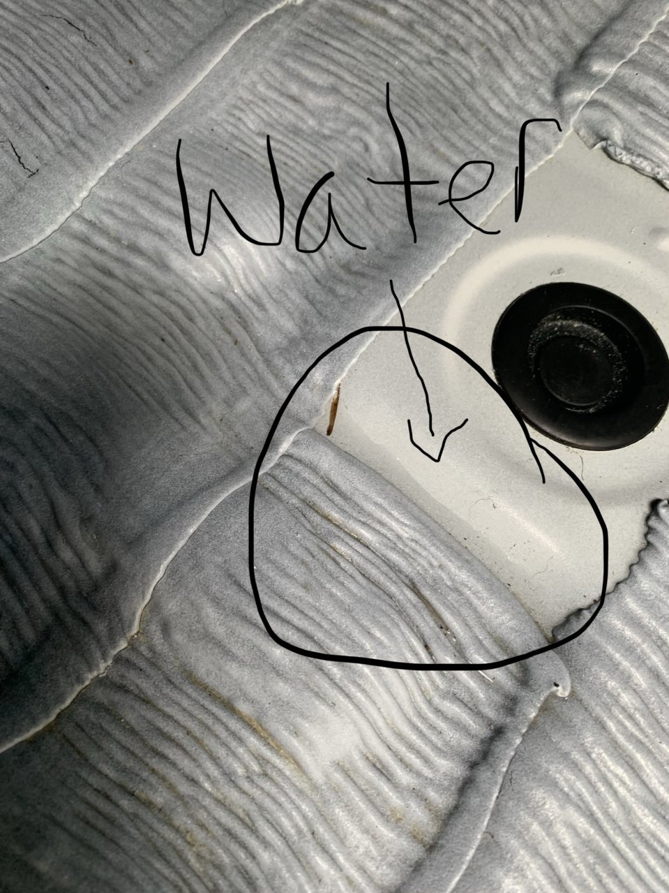

    So update on my wet carpet. Since it’s been raining here in So Cal, i think I’ve found out where the water is coming from. Any ideas what i can and should do?

    Anybody with a 2005 to 2012 Tacoma and a water leak should have a look at this (after the A/C drain is checked).

    @Troyken i believe it’s the air intake curb sealant failure. The photos are of the passenger side floor board. I’ve checked all other possibilities. Washed my truck few days before it rained, and nothing, no leaks or water puddles inside cab. I’m assuming it’s my tires kicking up the water to the undercarriage and into the floor board.

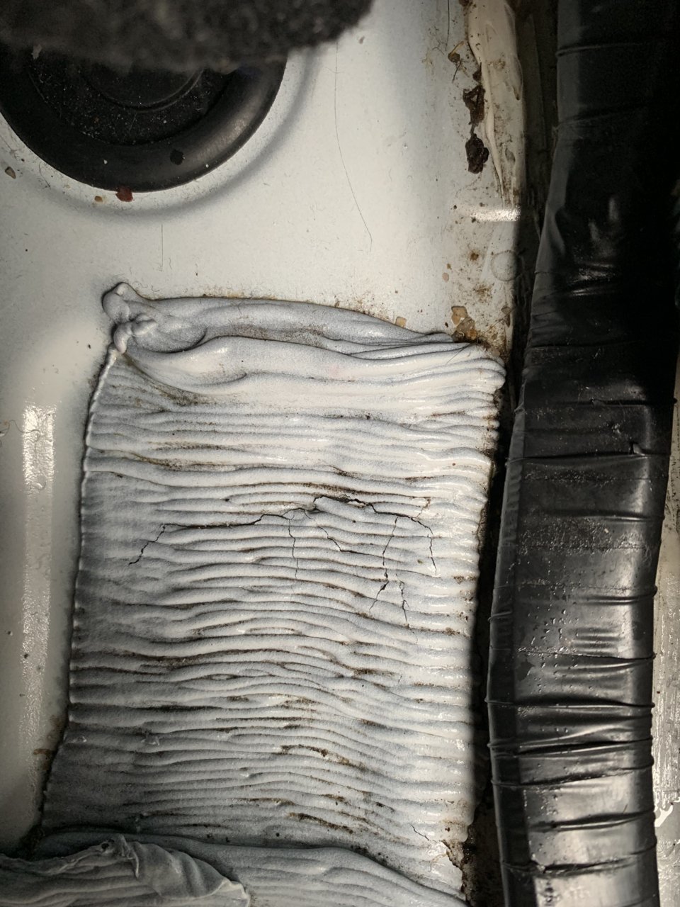

    Where is that crack exactly. Hard to tell from the photos.

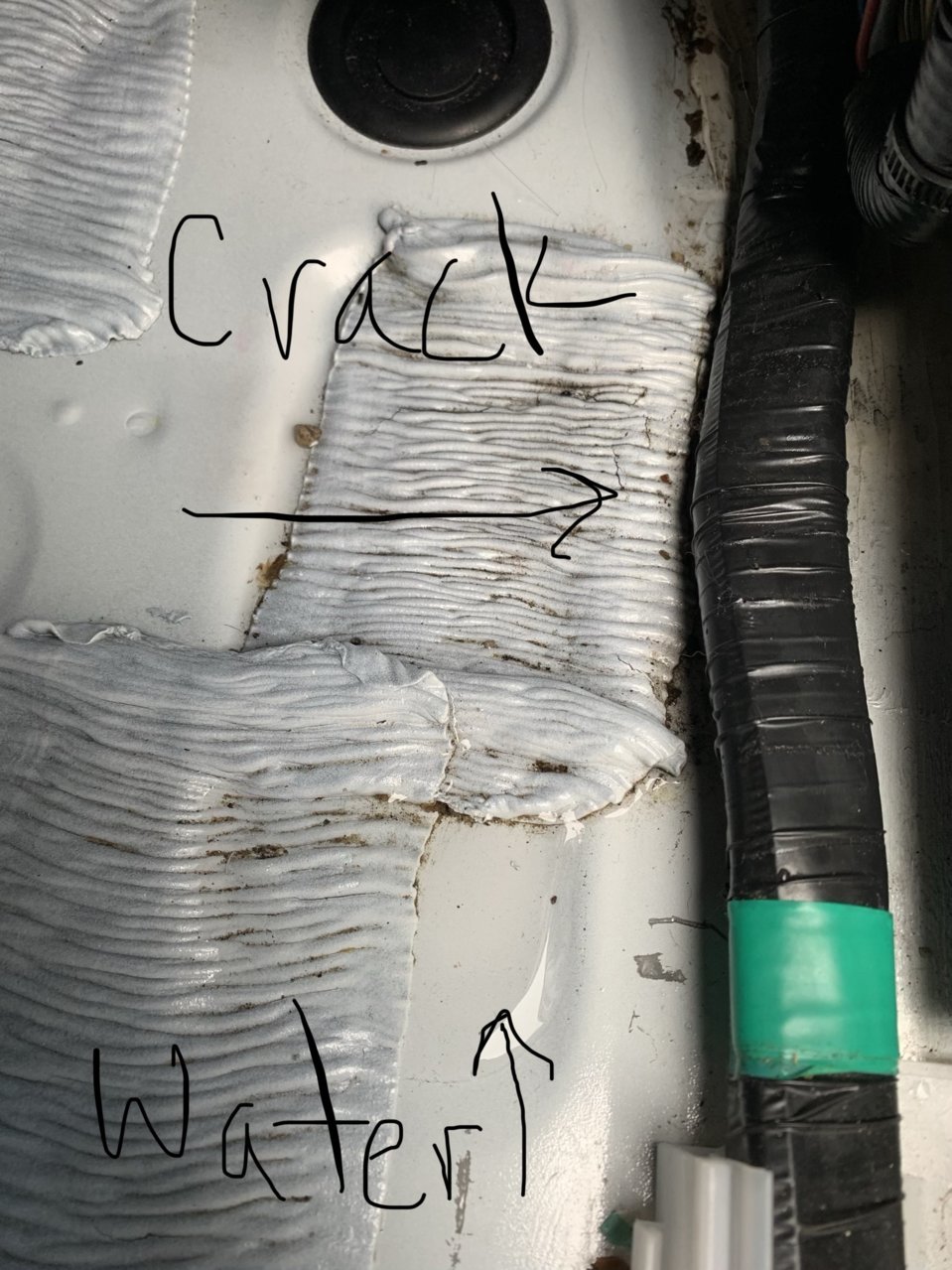

    @Bagman heres a better photo brother. If i poke at that spot water comes out and that JB weld stuff is a bit smooshy

    So where the door sill meets the cab? Or is that up on the firewall?

    @Bagman where it meets the firewall brother

    I've seen cracks like that before and no water leaks. I've had many interiors out during my time as a technician. The cracks are from the sealant shrinking (I think). It's not enough to cause water to enter. If there was no sealant there would be an issue. Water is coming out of it because it got into it, from another location.
    Too bad you weren't closer. I could probably find the leak in 5 minutes.

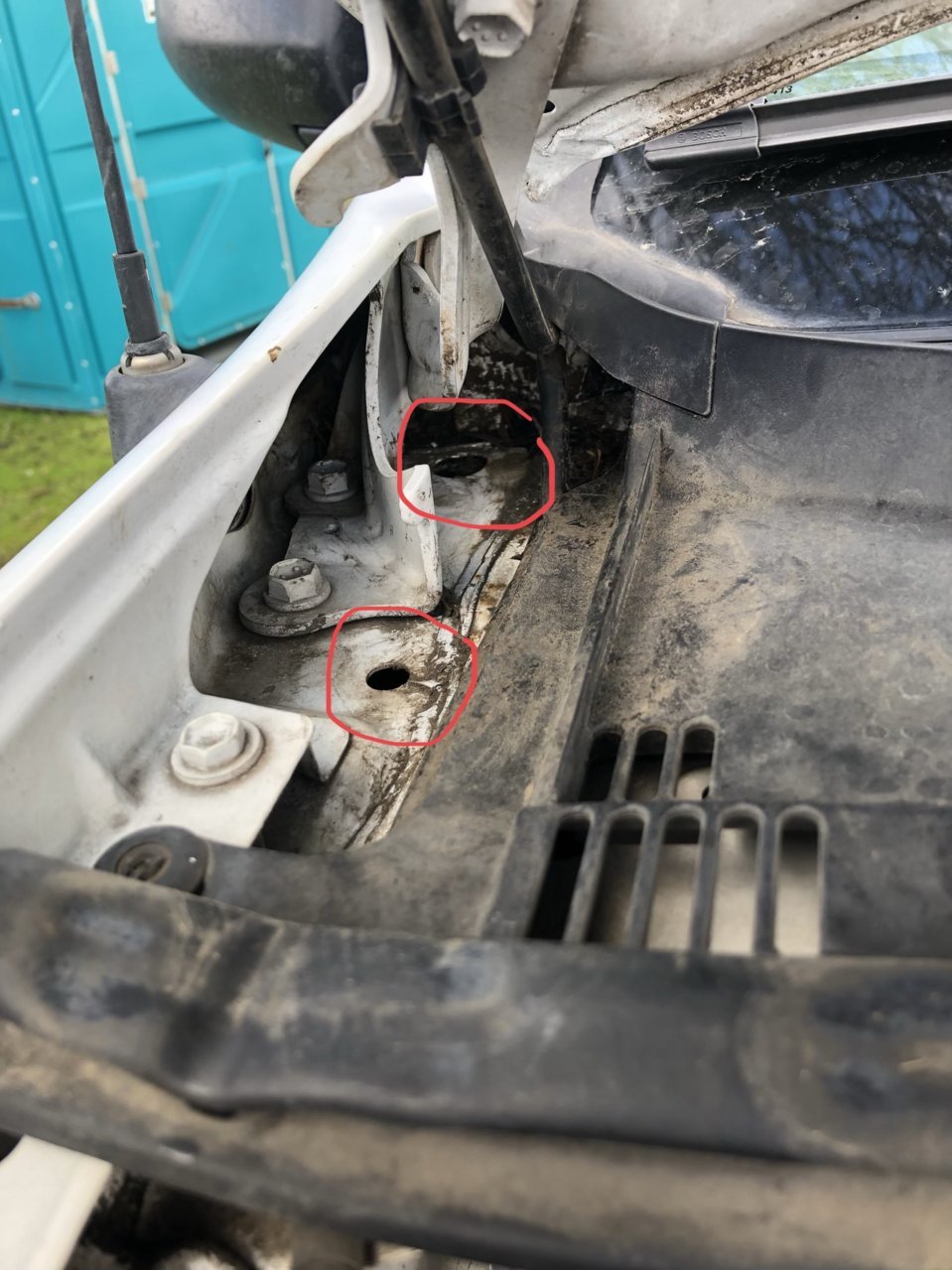

    This may not apply to you guys but I had the same problem and the cause was a drain hole plugged with leaves and decomposing organic matter under the hood hinge. I cleaned it out and the passenger floorboard carpet stopped getting soaked during rains.
