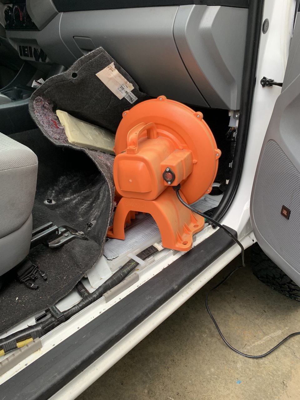

    Current situation. Using my sons bouncy house air machine to dry the carpet

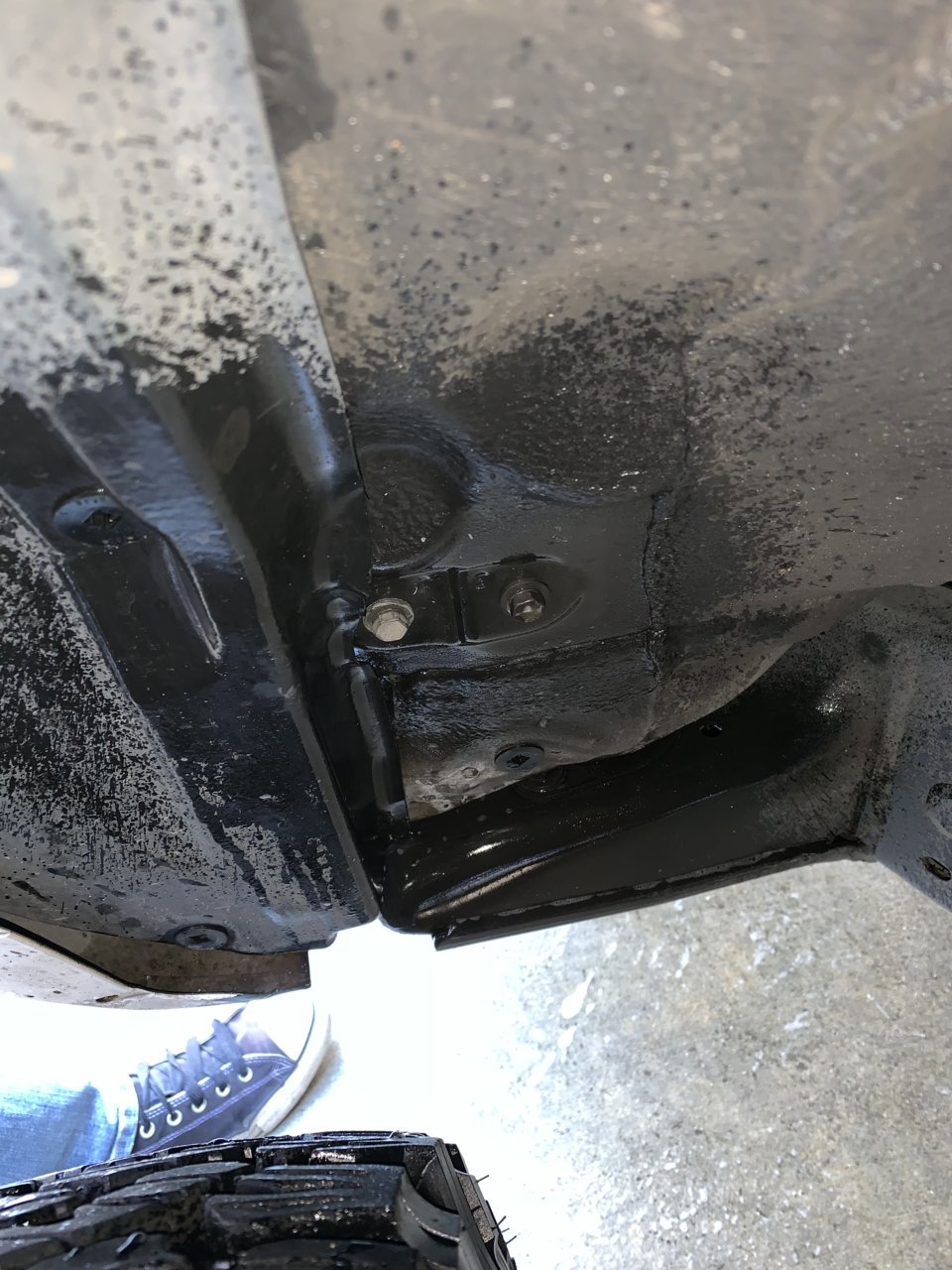

    I think i found the mother effn problem y’all!!! So after scratching my head for the last few days i thinks it’s this
  5. Feb 4, 2019 at 3:30 PM
    #65
    LUNCHB0X66
    LUNCHB0X66 [OP] Well-Known Member
    Aug 19, 2015
    #162234
    85
    Eric
    2012 Tacoma Prerunner
    None
    These two 10mm boots were a bit loose (don’t know why) but i sprayed them with some simple green (for color) and wouldn’t ya know, it leaked into the floor board of the passenger side of my rig.

    I ran out and checked mine. I have a bolt in each of those holes and they seem tight. Damn it! I'm gonna pull the tire off tomorrow and get in there and double check.

    @Bagman gave them a hand tightening and sprayed the inside with some flex seal. Gonna buy some black flex seal for the outside.

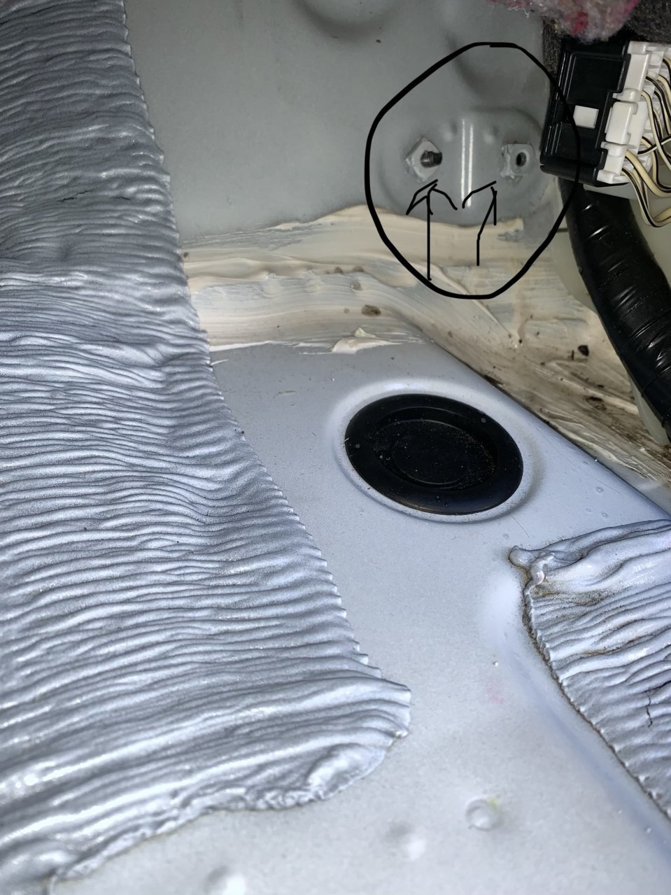

    Another guy here had that bolt missing. He put in another one and his water problem was solved. I don't think my '13 had those bolts, I looked for them. I'm not sure what they fastened.

    Anyone know what these bolts are for?

    I knew a guy that had a Jeep CJ type in the mid-eighties that had such bad leaks in the floors that the dealer sent it out to have the whole belly heavily undercoated. That isn't the case here but that bolt has to be in there or the water will come right through and soak the carpet.

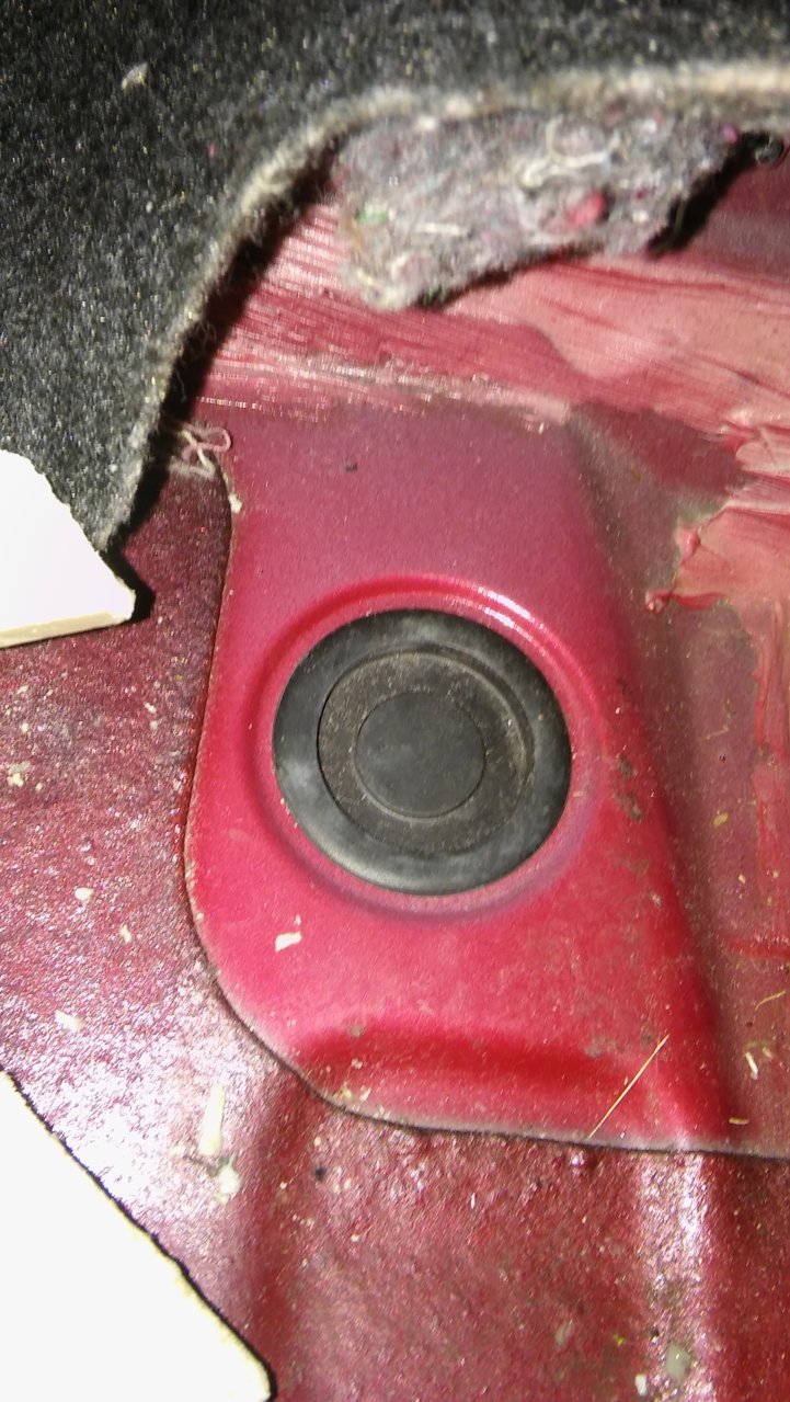

    20190204_191239.jpg One thing I haven't seen mentioned in this thread is cleaning out the space between the inner-fender and outer fender. Don't have a great pic but there's a little rubber flap covering it. Just below the front door hinge. Leaves and junk get trapped in there and I'm told, could be a cause for water inside. Move the rubber flap to the side and see what's in there.
    Also, what about this rubber seal on the floor. Mine seems tight but I may just silicone that sucker as well.

    I just washed the salt off yesterday Bagman. That lower fender was loaded with road debris and I flushed it out with the hose. I'm not sure it will leak in but it will rot the fender bottom.
    You could seal that plug for peace of mind but it probably is ok.
