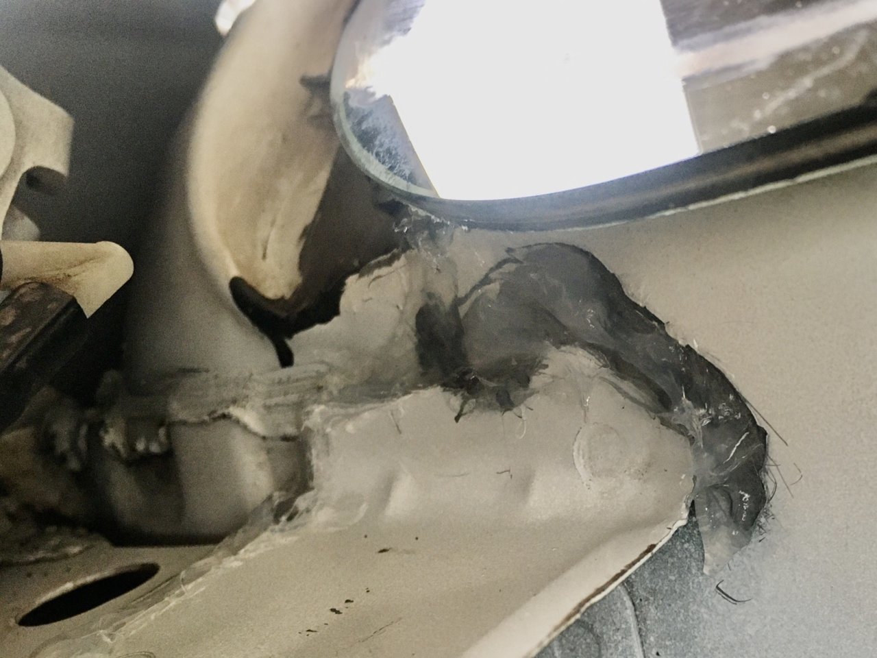

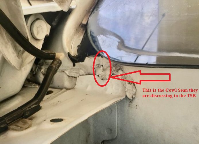

    Any chance somebody has found a video on this? Or maybe a picture of what exactly they mean by left front cowl seam / left lower front cowl seam? In my case the seem to be an awe full lot of holes/cracks. I’m really hoping I won’t have to take the fender off
    Here some pictures:B9357309-60CB-462A-8EF1-E62DDA498D6C.jpg 6C2165DF-BC95-48B1-B53B-8E961585AB96.jpg31F52F7A-8438-4E47-A572-E79E7EBAD5A7.jpg

    Did the bubble test described in the bulletin aaaaand no bubbles up top. Will try the fender part tomorrow. But would really love to see what they exactly mean by seam - I just sprayed the whole corner.

    This is the seam on each side they are talking about.

    Thank you so much. I figured that because of its age that positive cabin pressure test (or the lack of) might not be 100% reliable, so I will reseal it anyway. Will work on that and see if that fixes it

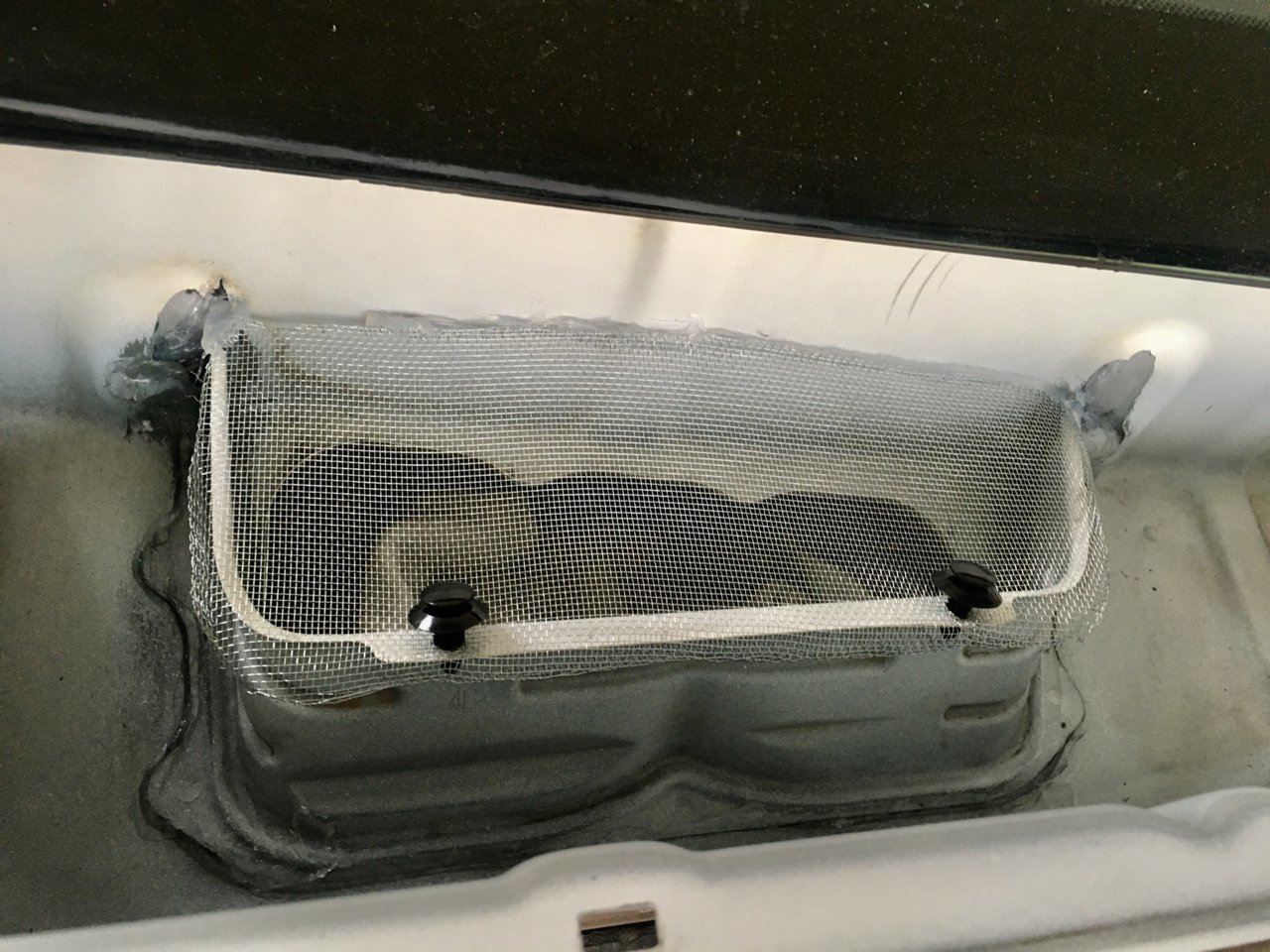

    Great thread, hope it works! Unless TSB cowl fix was done already, while your in there I'd go ahead and make a shroud to cover the fresh air intake. If it's not already leaking, it will be :)

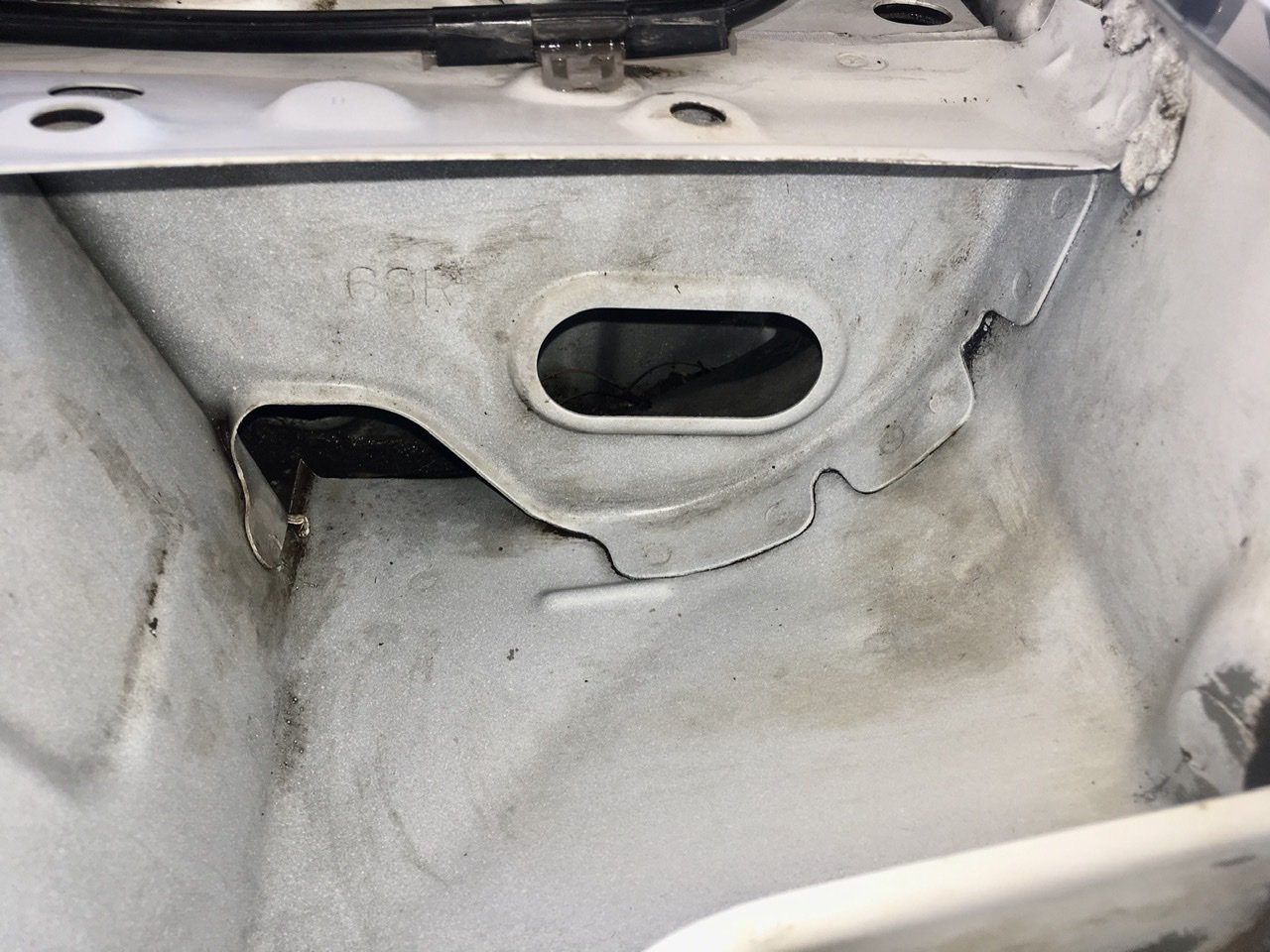

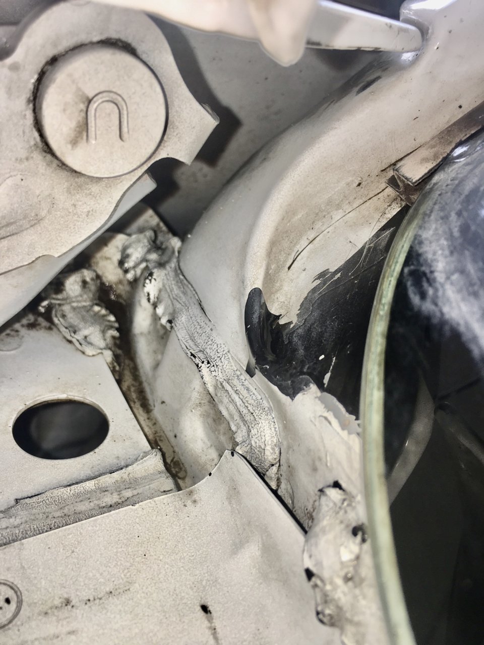

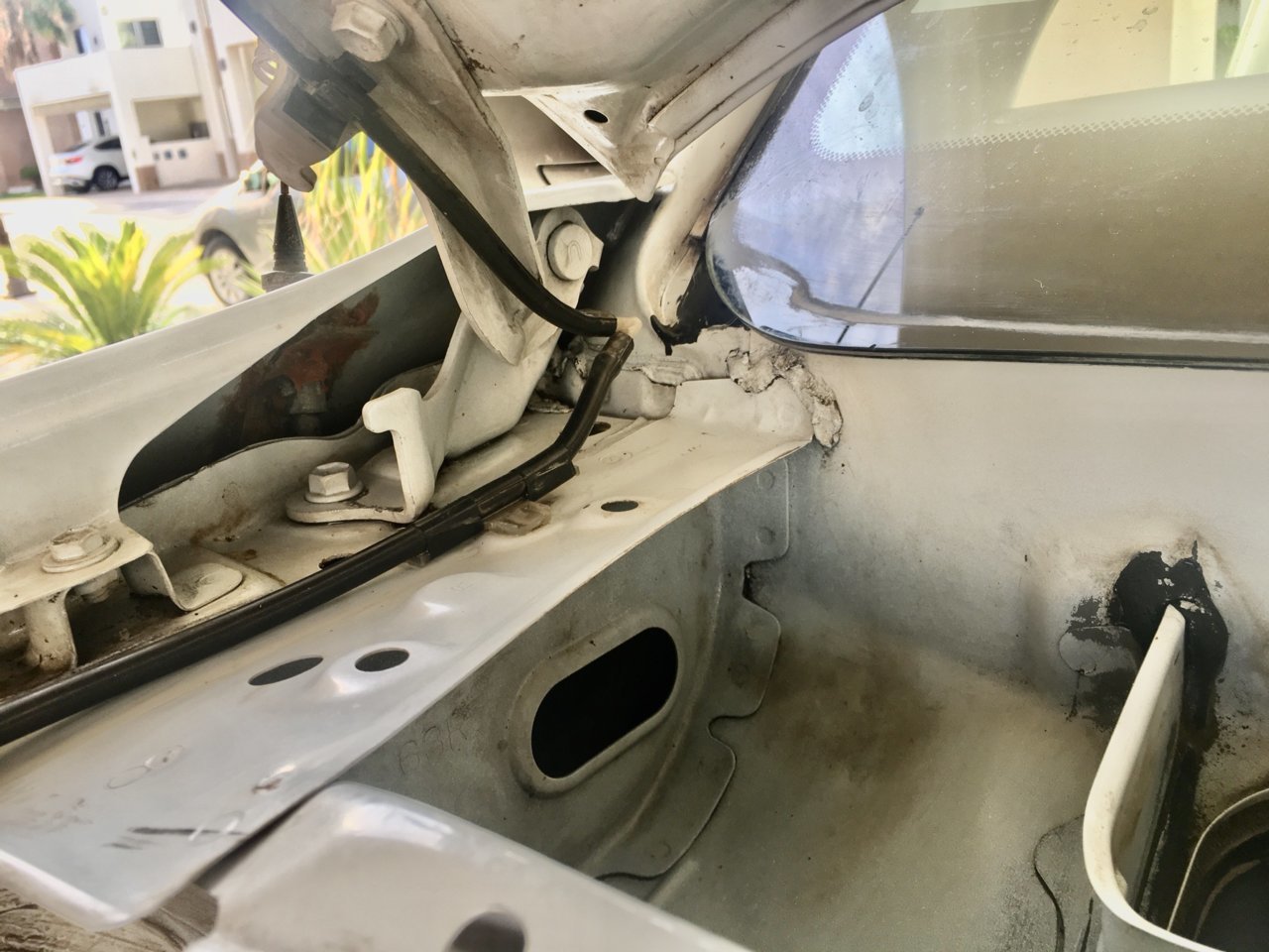

    UPDATE: Had water running off the windshield for 5+ minutes and the inside is still dry
    Thank you all for the quick help, especially you @Jimmyh
    And @jboudreaux1965 , I will. Haven’t been able to find smaller pieces of flashing (I’m currently in Mexico), but might get some tomorrow. Had cut up a plastic Walmart box lid, but not trusting it will stand the constant heat.
    Here a couple of pictures, hope this can help somebody that has the same issues - thank god I didn’t have to take the fender off

    Great job! Lol, I used a Walmart plastic bin as a temp fix once too! :) To really test it, you have to overload it with water, to where the water can't drain off through the vents fast enough and it backs up. The whole channel fills up and over flows. The problem in the design was that once the channel is overwhelmed the over flow went into the fresh air intake. :)

    Cheers man. Had another thunderstorm here since then and both, the plastic lid and new seal worked. Walmart actually had spare lids without a price on them - and they actually gave them out for free. First free thing I've ever gotten in a Walmart hahaha.
    I did reseal the box as well while I was in there and will post a pic once I have the flashing in - even though what I found was way thicker than what I wanted. Not sure I have enough trust to fill up the whole channel though - don't usually get that much rain here in Mexico, so I'll just cross my fingers there.
