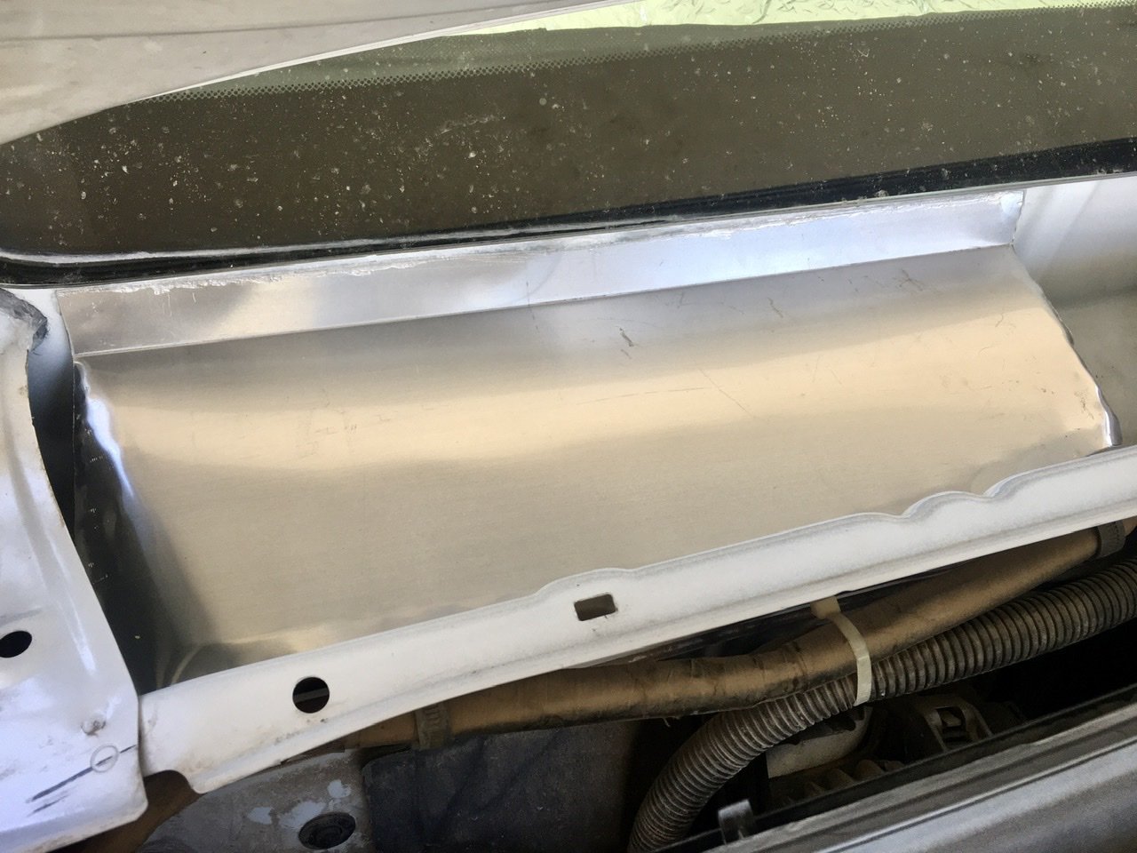

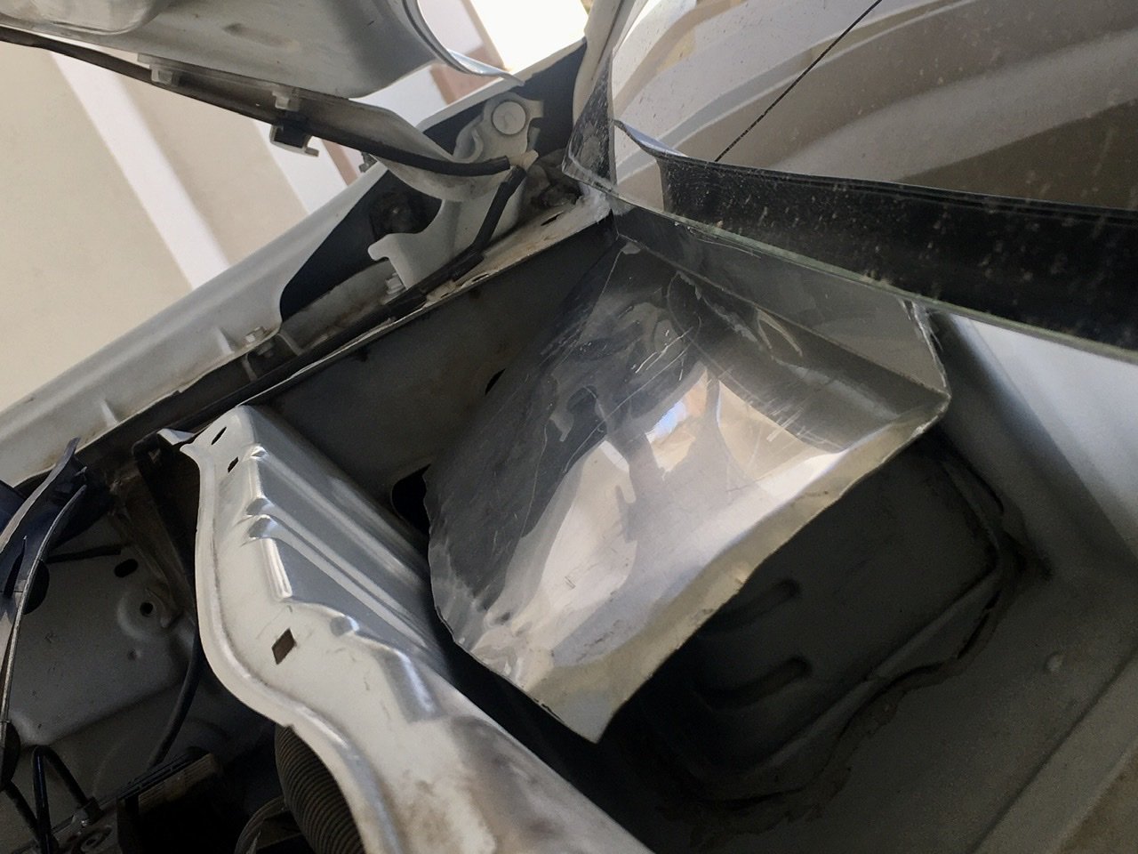

    Alright, here’s the end result. Think it turned out alright, but I guess we’ll have the next proper desert storm be the judge of that

    Just make sure you leave a gap between the top edge of the fresh air intake and the cover that you made so your air condition can still pull in fresh air.

    Got it, I left 1 - 2 inches. Thanks!

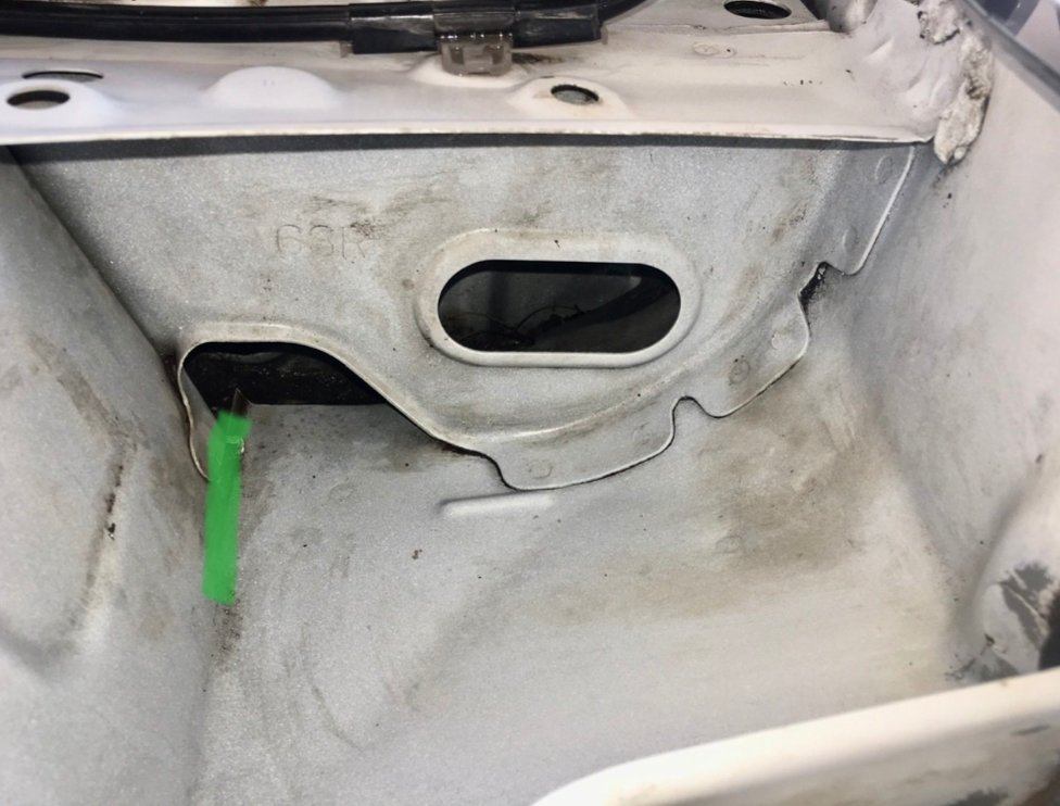

    So I'm back at hunting my rather stubborn water leak. Previously only the passenger floorboard was wet. The water wasn't dripping from above due to floor mats and carpet being dry but below the carpet was having standing water.
    I resealed my windshield cowl area and blew out the drains. That was back in December of 2023. Haven't had an issue since.
    However this morning both Driver and pass. floor was soaked. Same M.O. mats and carpet top are dry. Been drying everything all day even with the continuous rain.
    I'll include a picture, the green highlighted area is where the water naturally drains and floods the floor (both sides.)
    Any thoughts?

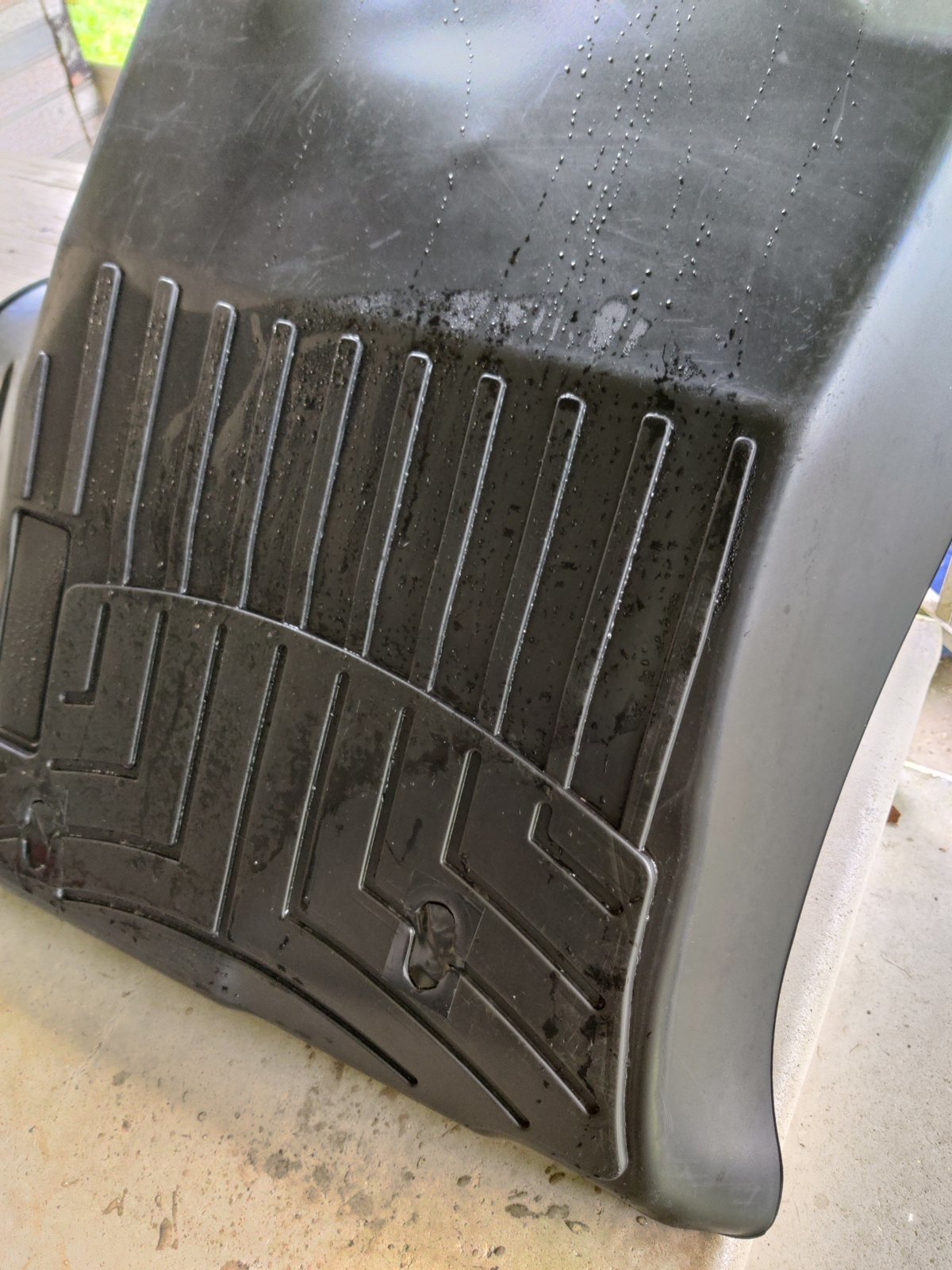

    Slight update with more info.
    Dried the floor yesterday for 16hrs
    Today drove for about 2 hrs in total. It was drizzling out but not bad, no water intrusion via drains. However the underside of my 2 front weathertech floor mats are wet due to sweating. Floor are incredibly hot in the front. I'm now thinking this is due to condensation. The trans tunnel and floor is crazy hot while the backseat floorboard is cool to the touch.
    I'm curious about my cats now, the truck is a 2007 with 125k miles. Wondering if they are dirty\clogged causing excessive heat.
