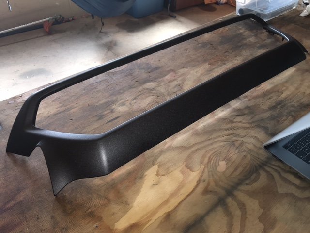

    Okay... the chrome had to go. Used primer, MGM paint, and the clear coat, all Dupli-Color brand.
    I've never wet-sanded before, and not sure how much is enough before switching to finer grits.
    What will the surface feel like when ready for buffing?
    Sandpaper is soaking in water now.

    Right now the surface is rough. I can't even tell there is clear coat on it. Is that normal?:help:
