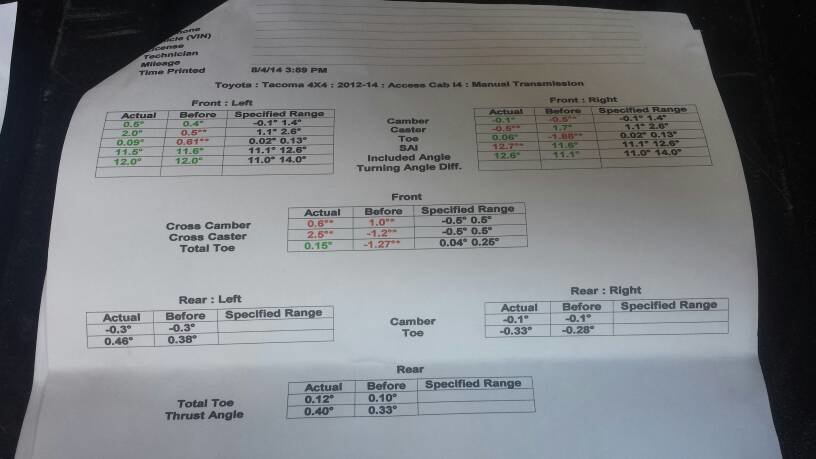

    too much spring and you need new UCA's to even get the caster in the positive with your 5" lift in front :laugh:
    any reason you thought 886's were a good idea on your 2.7L AC ???

    post up the "before LCA bent" alignments specs.

    I don't have any before specs sorry. I didn't keep those. I've only ever had one Alinement since I bought the truck before this mess.

    Could also bee your rack n pinion bent...
    Was your toe out really bad on your pre alignment spec?

    No, no pulling, just the top of the tire touched the UCA, not sure if that was pre lift or after hitting the rock in the mid hole after getting sucked to the inside

    just a recommendation but you should invest in a good set of UCA's

    ^That was the alinement right after the trip.

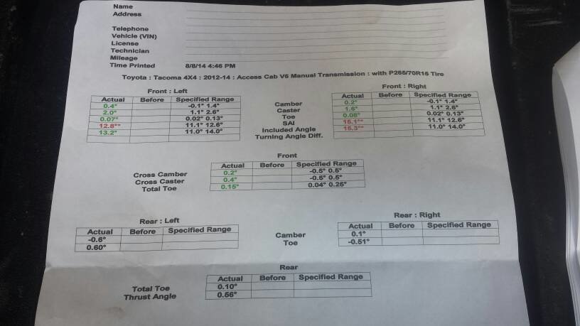

    ^that was the second alinement
