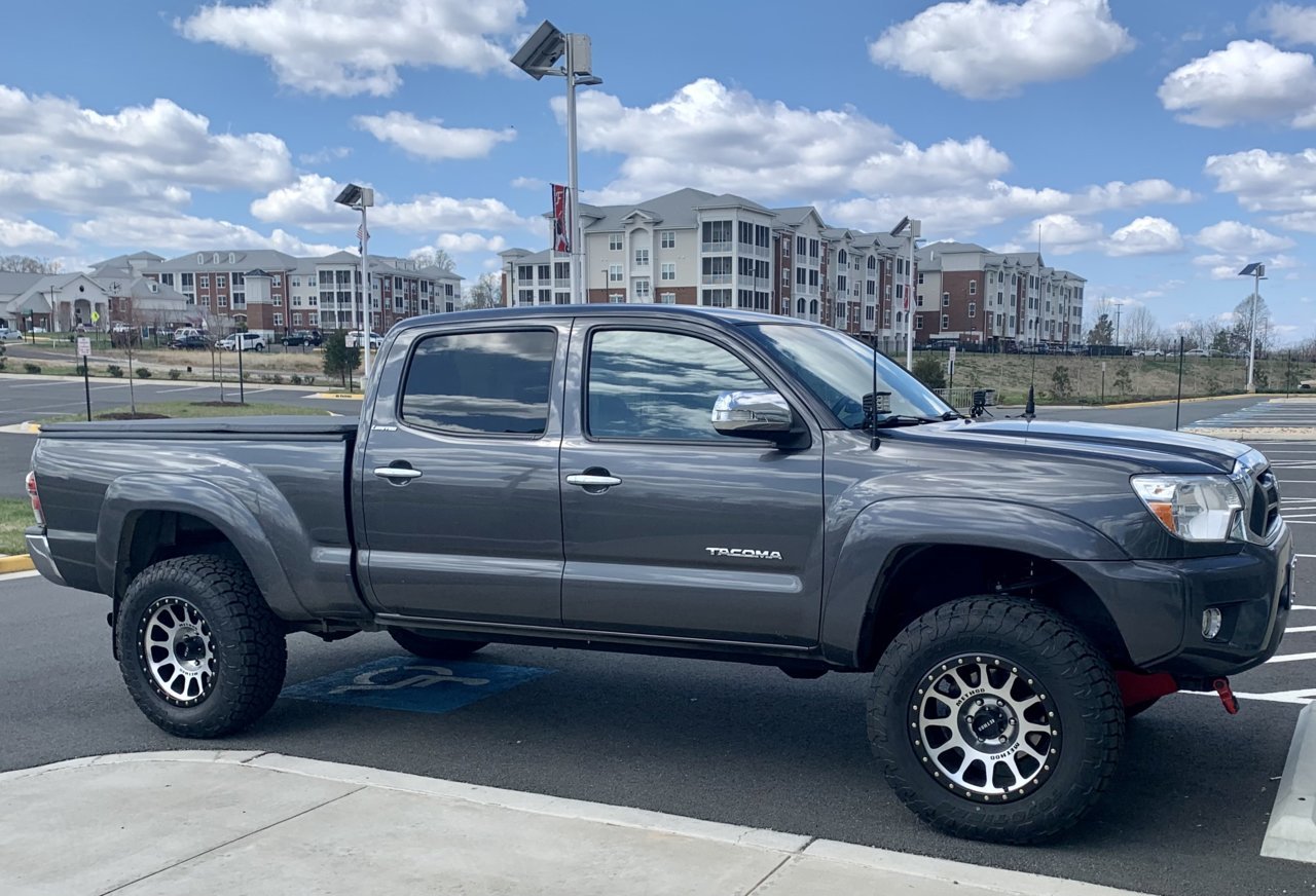

    2014 DCLB 4x4 Limited. 6112’s/5125, KYB Top Hats, SPC UCA’s, Icon RXT leaf pack,
    See my signature for parts. Very happy thus far and is my daily driver. Easily allowed for 32” tires with small back spacing from wheel choice .
