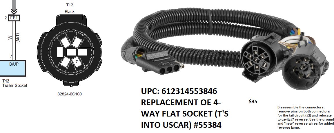

    Trailer harness?

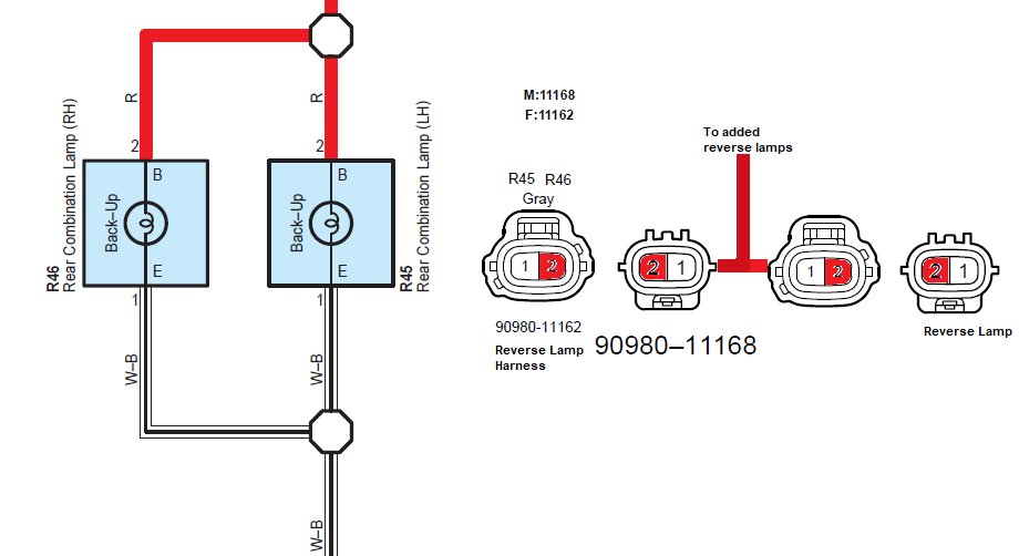

    Actually lemme clarify:
    I have meso’s stage 1 tail light conversion and I’m trying to figure out a way to get my reverse lights back when my hazards are on. So if you know how that can be achieved lmk. Otherwise how should / can I wire up a reverse light that comes on when I shift to reverse?

  4. Sep 29, 2019 at 7:43 PM
    caribe makaira
    caribe makaira Well-Known Member
    Feb 13, 2011
    #51121
    11,785
    Caribbean, Puerto Rico
    05 PreRunner TRD Offroad AutoTrans
    Hood Struts, My version Fogs always ON, Map & Overhead Light Mod,
    Place power tap to reverse OEM wires BEFORE the switchback...then that tap to your added reverse lamp...
    yub and Rujack[QUOTED][OP] like this.
  5. Sep 29, 2019 at 7:47 PM
    Speedfreak
    Speedfreak Member in poor standing
    Sep 22, 2017
    #230756
    4,932
    Dave
    Canada Eh!
    2017 Tacoma TRD Sport DCSB 6MT, Blazing Blue Pearl
    Manual Mall Crawler
  6. Sep 29, 2019 at 7:56 PM
    caribe makaira
    Feb 13, 2011
    #51121
    11,785
  7. Sep 29, 2019 at 7:59 PM
    Speedfreak
    Sep 22, 2017
    #230756
    4,932
    Dave
    Canada Eh!
    Manual Mall Crawler
    :thumbsup: interesting mod that might look deeper into. Obviously an auxiliary back up lamp of some type is something needed with it though.
