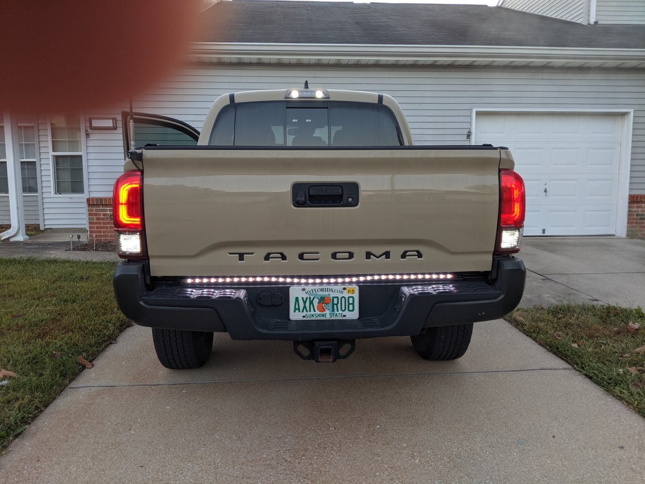

    16,292
    State of Jefferson
    2016 DCLB TRD HELLCAT SWAP
    Look up VLED LPR.
    It’s a stealth license plate backup frame that is very bright. Tap off the reverse signal for an uninterrupted, dedicated white reverse light

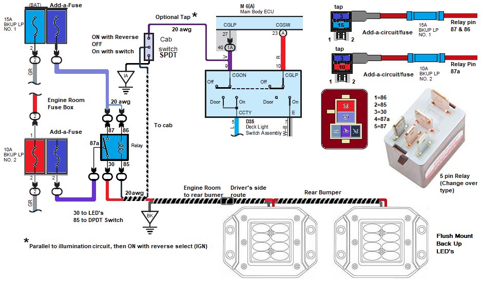

    If you feel crafty...

    That’s actually how I’d like to do it. Nice drawing btw

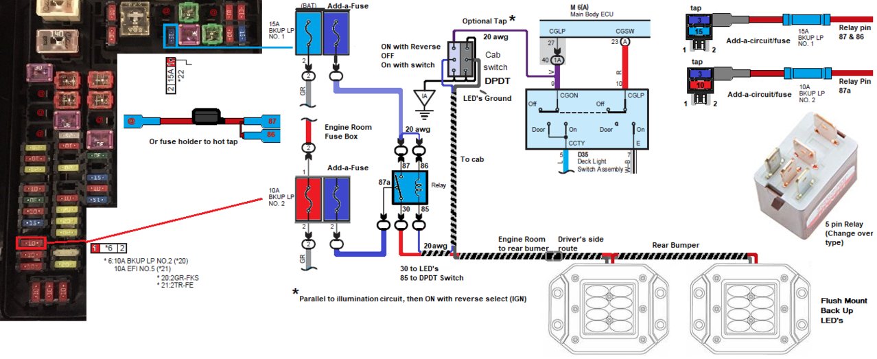

    Less expensive:notsure:
    Non-illuminated spdt mini rocker switch ($5.00)
    2 add-a-fuse and 2 fuses ($7.00 ea)
    mini 5 pin relay ($15.00)
    LED's ($20.00)
    wire & loom, tape, zip ties
    5 female terminals, one ring terminal
    ..over budget:rimshot:
