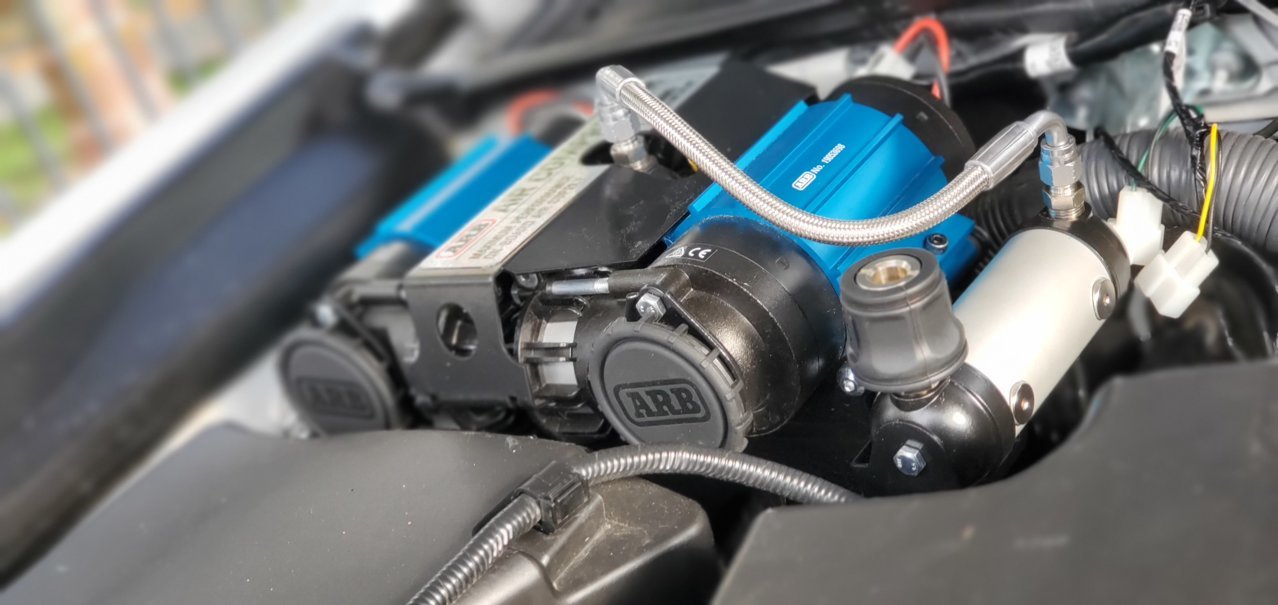

    I have the ARB dual high output compressor installed under my hood to activate my lockers and air up my tires.
    I think ARB are the best if you're going "on board" IMO.
    doc76[OP] and jakethesnake97 like this.

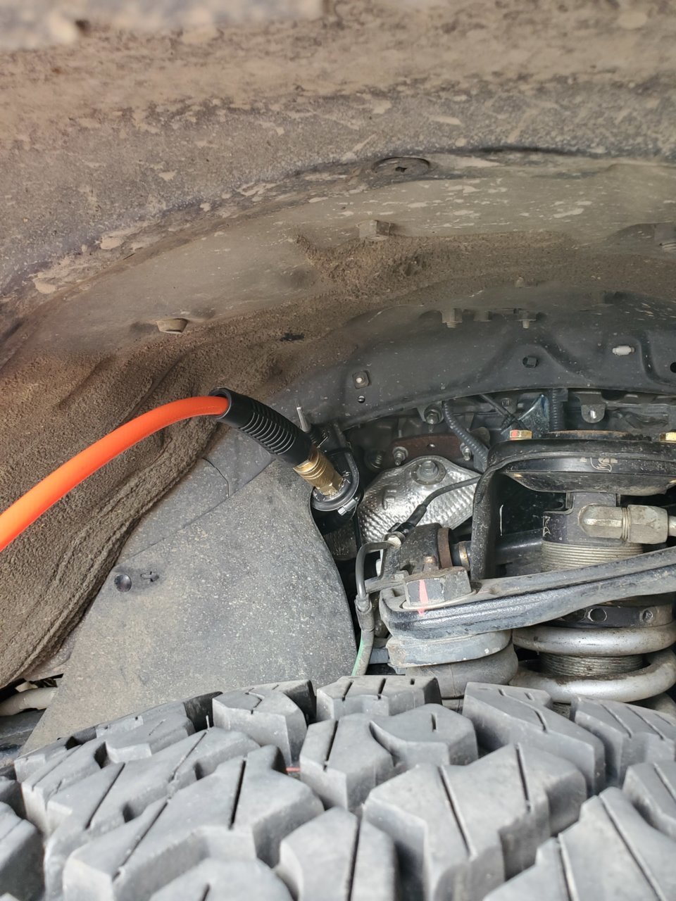

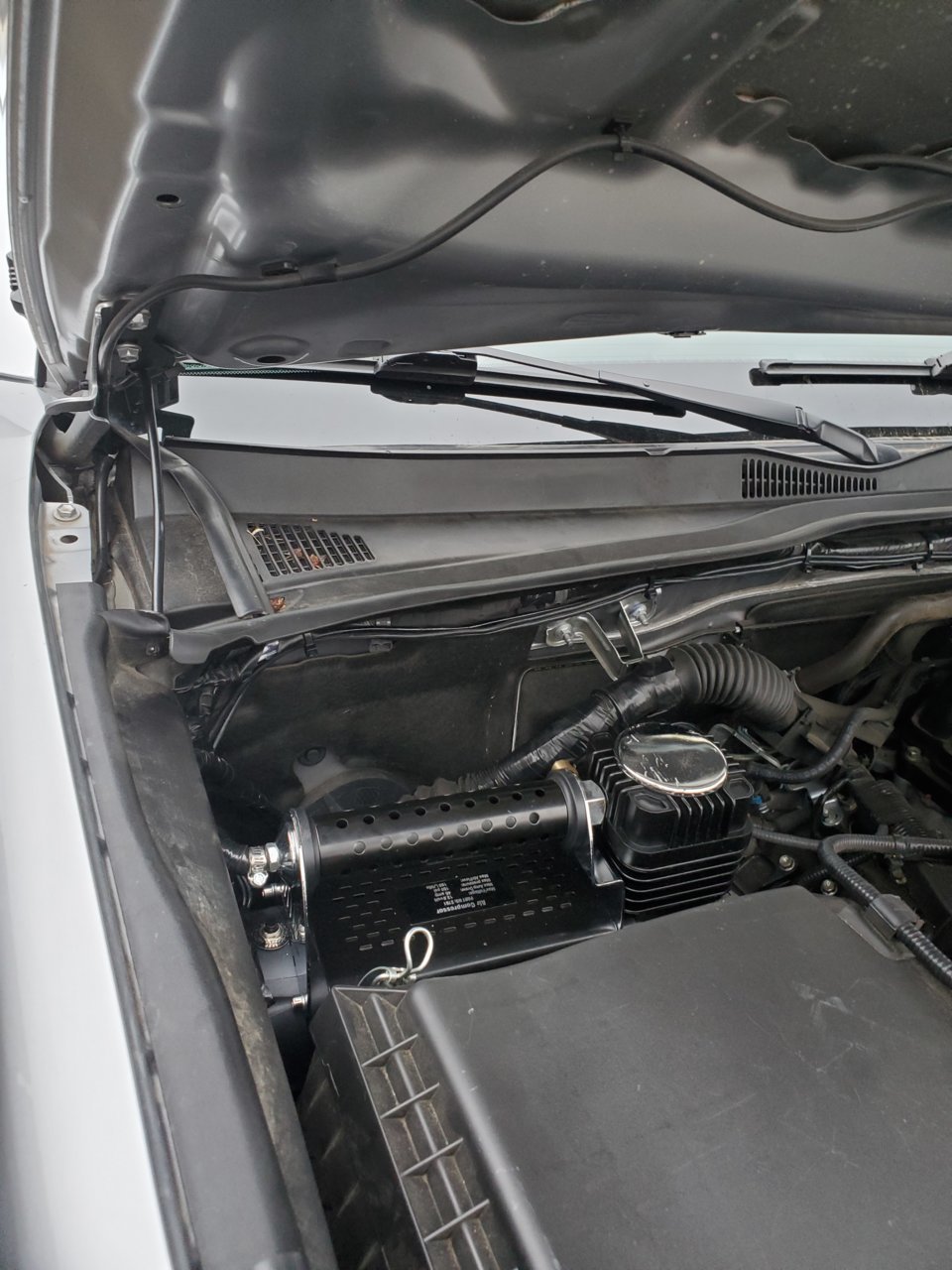

    Smittybilt under the hood, with the connection and switch in the wheel well. Does 5.6 cfm, so fills each 33 from 15-32psi in about a minute and a half. Pretty cheap aswell, and got a 4wp warranty so if it ever blows up I get a new one.20210403_184146.jpg 20210403_155021.jpg

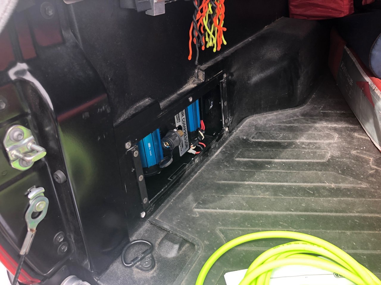

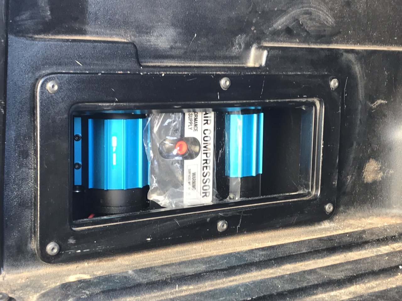

    I just installed a ARB twin compressor this weekend in the left cubbyhole along with the switch... works perfectly and completely hidden... in the picture, I hadn't finished cleaning up the cover plate so thats what you see here..... second picture is nt my truck but the final product sans door IMG_0140.jpg

    Expedition Essentials also sells a version for the right cubbyhole box that retains the inverter
