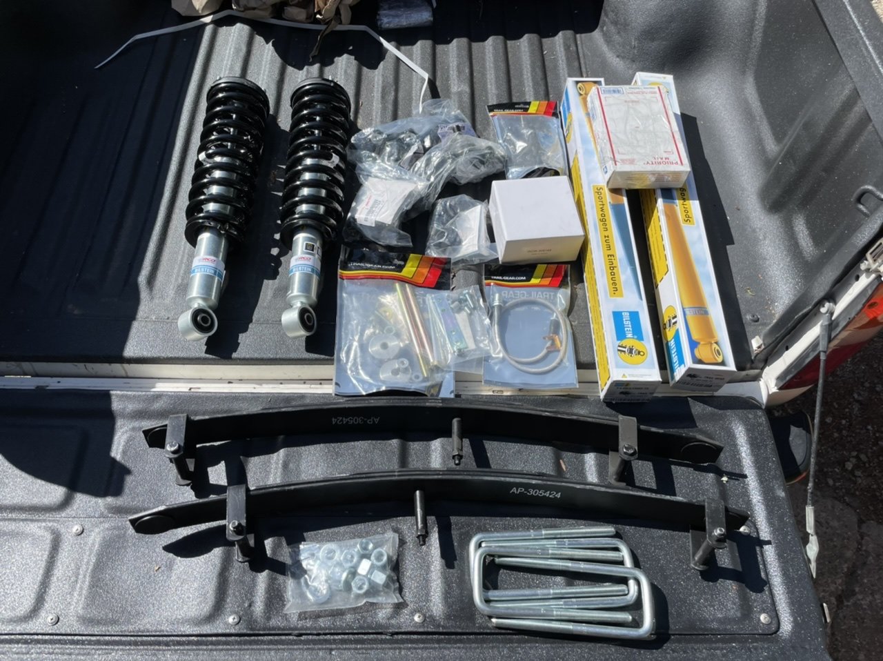

    Bilstein 5100’s pay/have the vendor set the coils on the perch. Tight budget. You can get away with a 1 inch block in the rear.

    Diablo169
    Diablo169 ROKRAPR
    Mar 12, 2016
    #181079
    2,908
    Max
    Santa Cruz, CA
    99’ Bro-Coma’s Revenge 3RZ 345k+
    Stock
    All this was $1,000.
    TACOTU3 and Yota X like this.

    I got everything from Wheelers Offroad.
    I bought everything months ago and it’s still sitting on a shelf :rofl::frusty:
