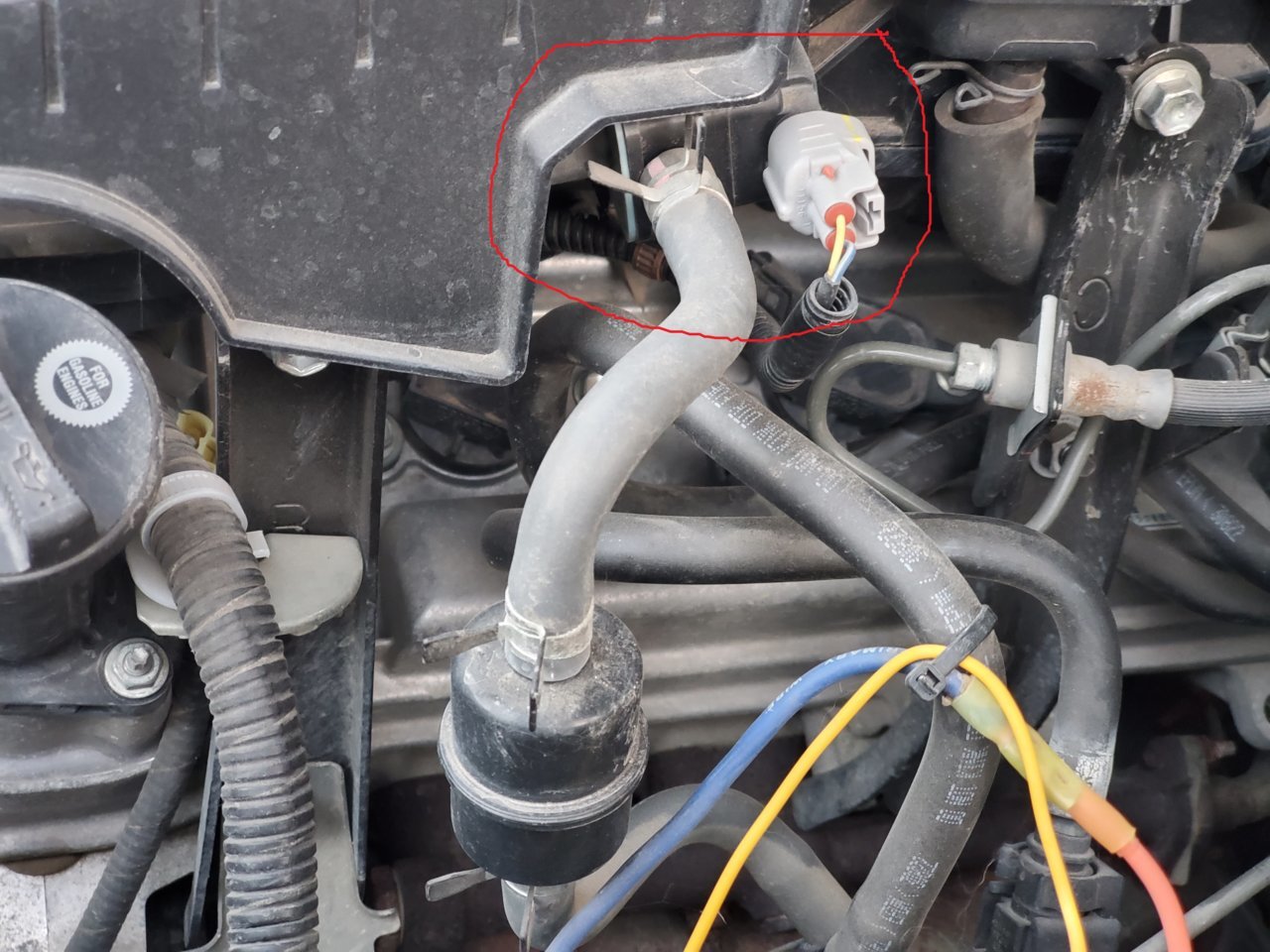

    Thanks All! Do any of you have the part numbers for all four O2 sensors for an 05 Tacoma SR5 4.0 4WD? And would you recommend I exchanging just the one that I’m getting a code for or all of them at once? The codes I’m currently reading are P0420, P0456, P0441. I’m hoping it’s that my fuel cap was loose and the rest is the O2 sensor issue.

    None of those codes likely have anything to do with the O2 sensors.
    The P0420 is for the bank 1 catalytic converter not functioning effectively (if there are no exhaust leaks and the O2 sensors are working properly it's likely the converter is bad)
    The P0441 and P0456 are EVAP codes, the first thing I would check is the Purge VSV on the engine.
    No vacuum should be present at the port with the engine running and the electrical connector unplugged (be aware you may set a P0443 with the valve unplugged), when the valve is commanded on there should be vacuum at the port.
