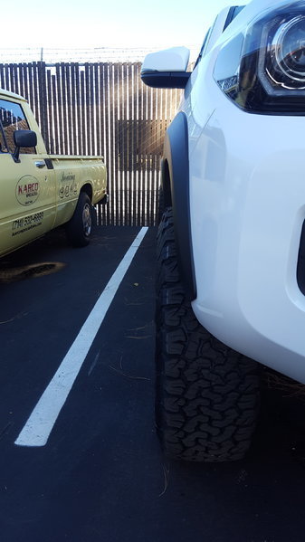

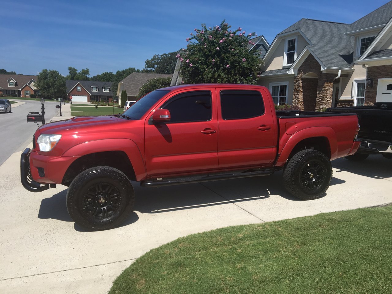

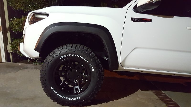

    7B0B946D-BD14-4B83-8628-BFAD055AAE3C.jpg 4B8F50A4-FD04-420F-BF41-F6D18DEF4821.jpg C342EC82-7C0B-4C3B-AE9B-772D1A40A130.jpg I recently purchased a 2012 sport 4x4. It’s got a rough country 4 inch lift. Anyways....it’s got 2.25 inch spacers on it because the wheel won’t fit. I’m looking at buying the trd pro wheels but what is the right offspace and backspace for them to sit as flush as possible with the fenders and not stick out to much? Below are pictures of the wheels I’m wanting buy and how close in I want them to fit. Thanks guys.

    Here is 16x8 with 0 offset and 265/75 tires. They sit just about at the outside of the fender flares. They will throw water/mud onto the sides of the truck, so they probably stick out a little bit. An offset of -10 would probably look ok too, they would stick out a little more. I’m not a fan of tires sticking out when it’s not necessary.

    Yup. I added to my post, but positive offset will set them in more, negative offset will push them out.

    The ad isn’t exactly clear, it appears these are 7” wide. And if that 4mm indicates a positive offset, these will tuck in more than mine in the pic I posted by a little over a half inch. I would like that look.
