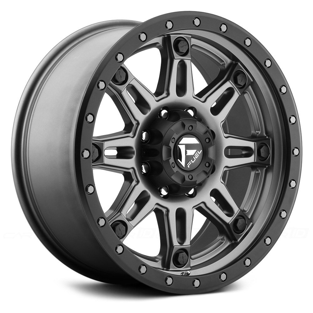

    Ended up getting 18x9 fuel hostage 3’s wrapped in nitto ridge grapplers. 275/65/18 with a 0 offset. Get them put on Friday or Saturday. 2E18BA45-C637-44AF-B39F-2B6C00DAFA86.jpg

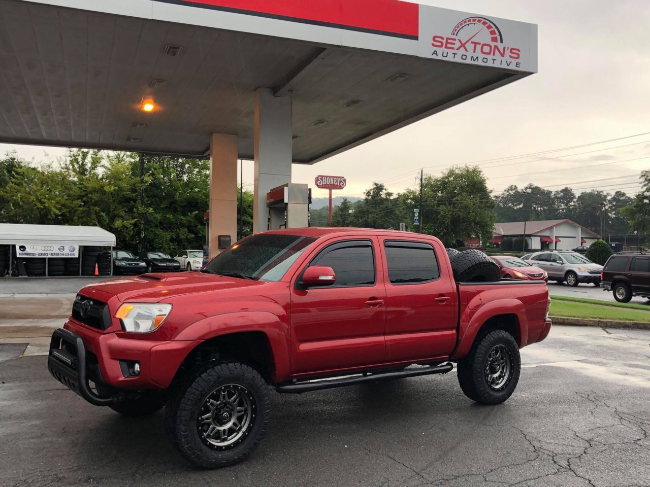

    Got my wheels and tires put on today. Ended up going with 18x9 with 0 offset fuel hostage 3’s with nitto ridge grapplers. 275/65/18. I think it turned out pretty good! Appreciate the help guys.

    Man that's a nice looking truck. Good wheel choice!

    Looks nice. They probably line up perfectly with that width and offset combo.
