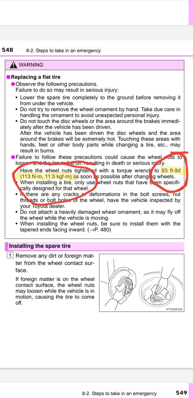

    Torque value for the wheels can be found on page 548 of the owners manual.

    or use the standby German torque value...gud'n'tite! ;)
    (seriously, 83 ft lbs is correct)
