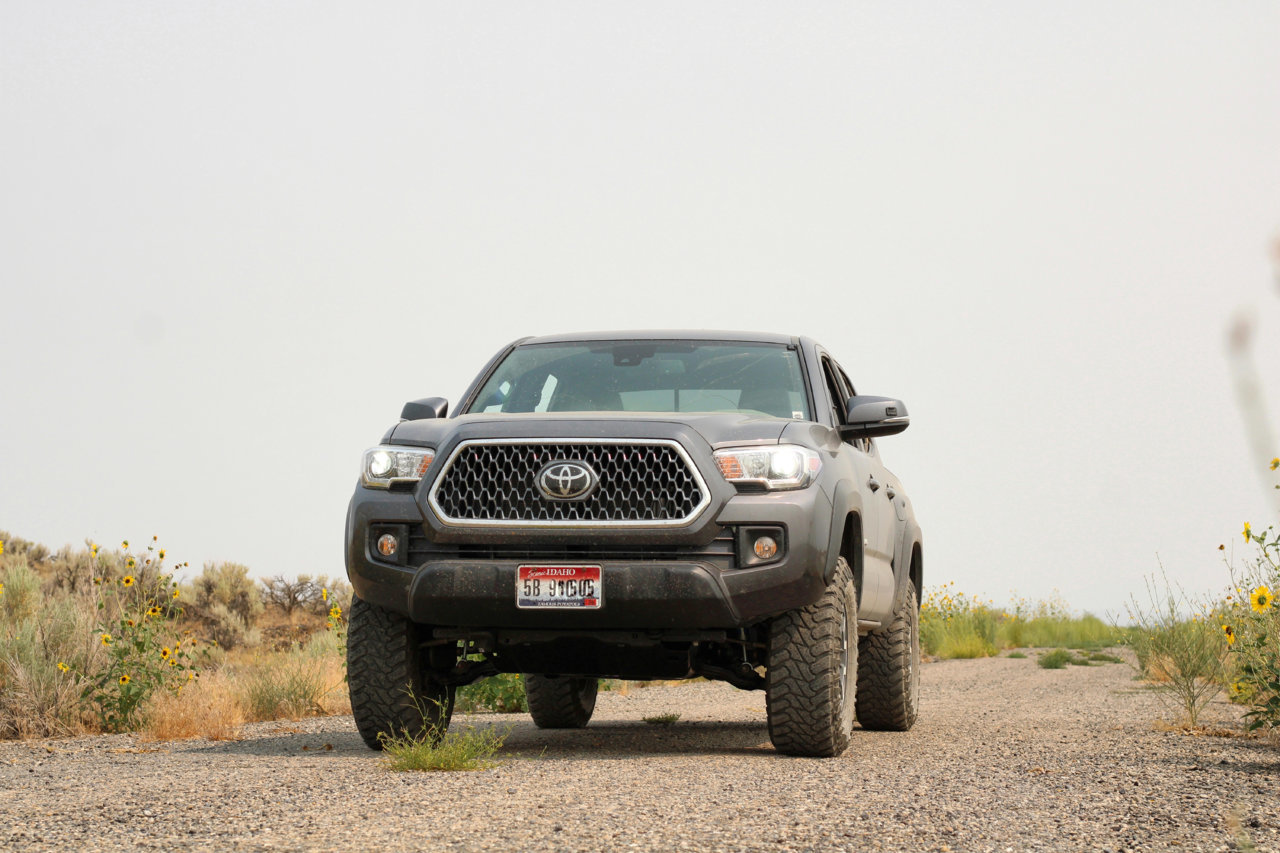

    This is 265/75r16 with Bilstein 5100 2 inch lift in the front. But they didn't rub at all before the lift.

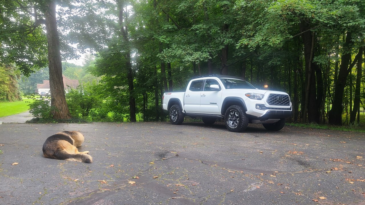

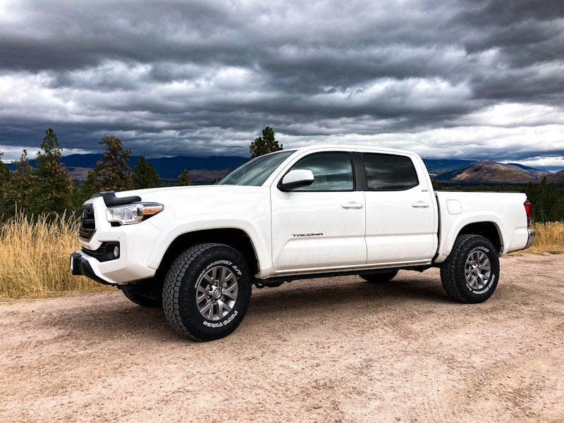

    Here’s my ‘19 SR5 with 265/75r16’s. It’s the perfect size in my opinion for these trucks. No rub and it’s a straight swap with the stock tires. I love these Toyo’s.

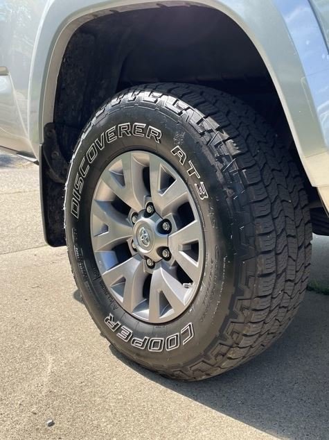

    I put 265/75R16 Cooper Discoverer AT on my 2020 SR5. Kept the stock dark charcoal wheels too because they look good with the Cement paint color. 3,000 miles and no issue. maybe lost 1 mpg

    I just bought the AT3 Cooper but havent mounted them up yet. Would you mind posting a pic so I can see how they look.
