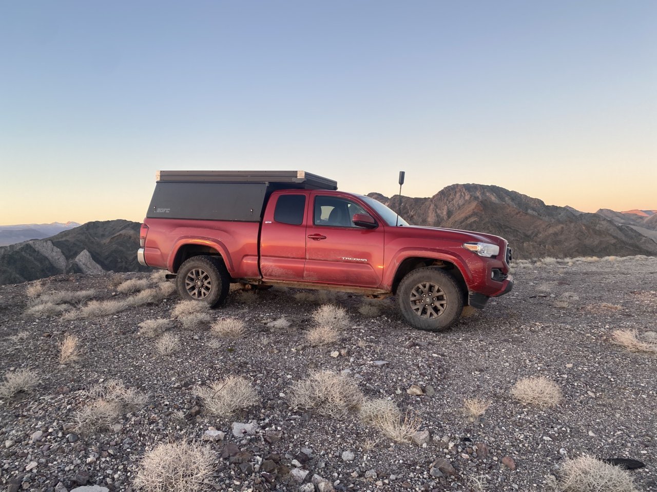

    I upgraded my SR5 stock tires to LT Coopers 265/75/16 and they look great, perform great, but the MPG hit is painful. Probably worse for me than most because I also have a GFC, which dropped my highway MPG by 1.5 on the stock tires.
    But luckily I work from home so my DD needs are the 2 miles to the grocery store.

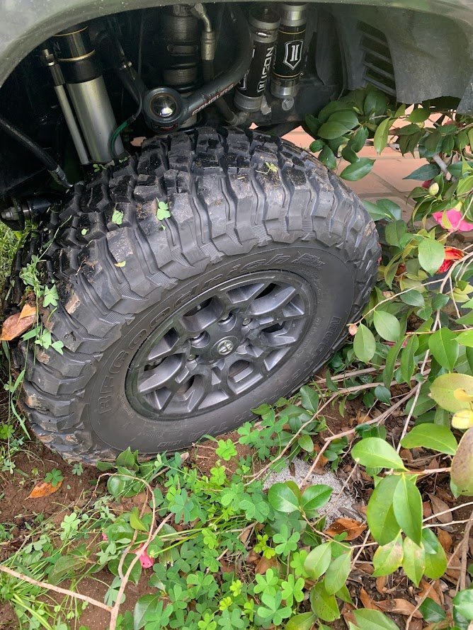

    Well the good news is with the 245 tires you get better millage . When I first got my sr5 it was around 20 combo with 24.5 highway.
    running BFG km3 265/75r16 now and the millage is 17/21 . Obviously perfect off road tire with no rub
    KN4Aee8ds_EKh6fQmxGA-2XaKB69H99GvHo4mfVY_4a5c25993d15e93f3580e0ddfa6382a2e7493851.jpg

    Yeah they fit fine on the stock suspension. :thumbsup:
    Drove them hundreds of miles off pavement in Death Valley and no rubbing.

    The upper and lower control arms are stock length (camburg) so the stock geometry / clearance is the same. Everything cycles just like stock, no rubbing as the suspension cycles or with turning

    Angel . That’s the suspension fully dropped out under articulation.

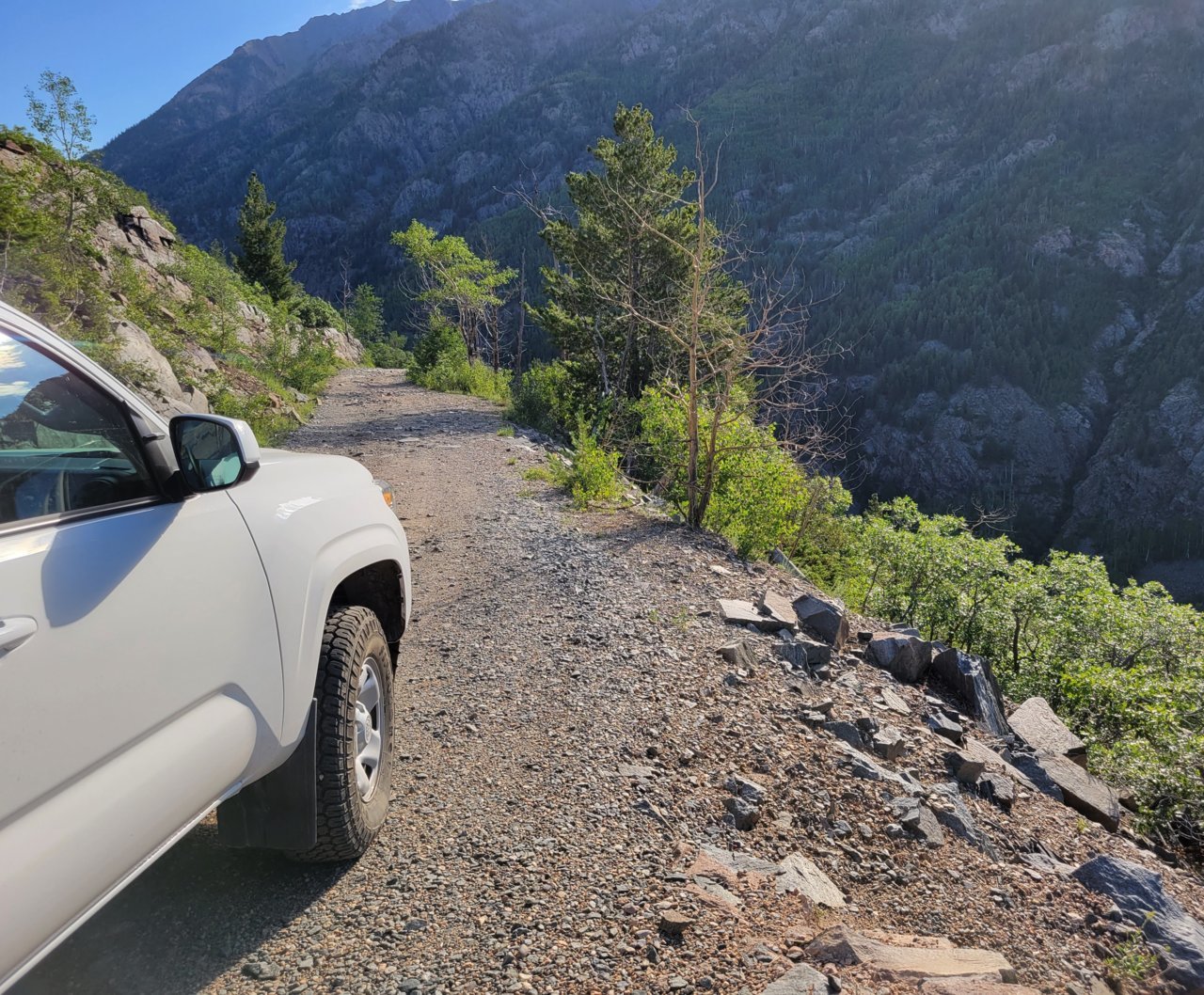

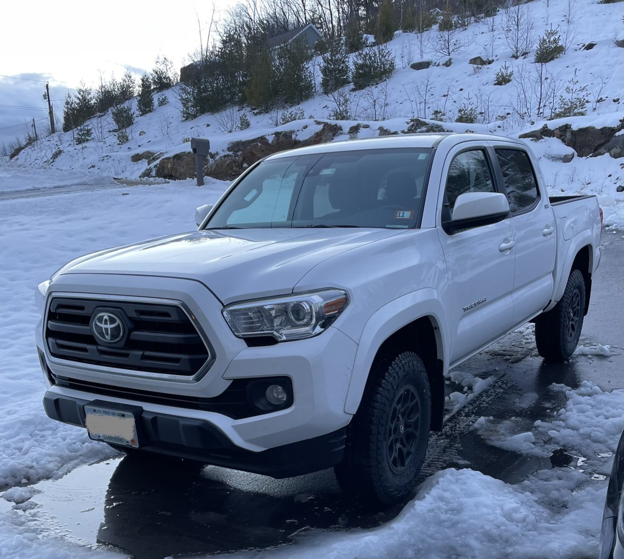

    Just replaced the stock tires on my SR5 with these Falken Wildpeak AT3Ws. I went with the 245/75/16s, but now wondering if I should have gotten 265s. Everything on my vehicle is stock, but i’ve been leasing for 3 years and buying it out so now it is truly ‘mine’. Does this tire size look alright on the SR5 or should I try to swap for the 265s?

    Looks badass. Did you do a 2 inch level in the front? What wheel and tire is this?

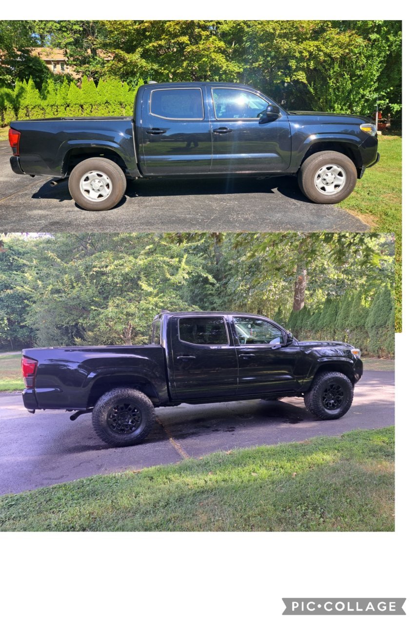

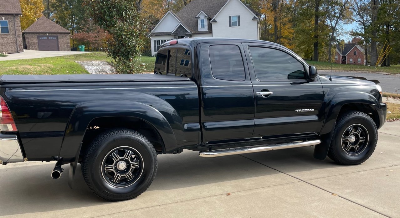

    Just got my 265/75/16 on yesterday from stock245/75/16
    Toyota OEM TRD wheels
    Fit right to the fender line , no rubbing but gas mileage already had a hit67B7DF33-4CA0-4E8F-B5C8-7F9DEC952F59.jpg

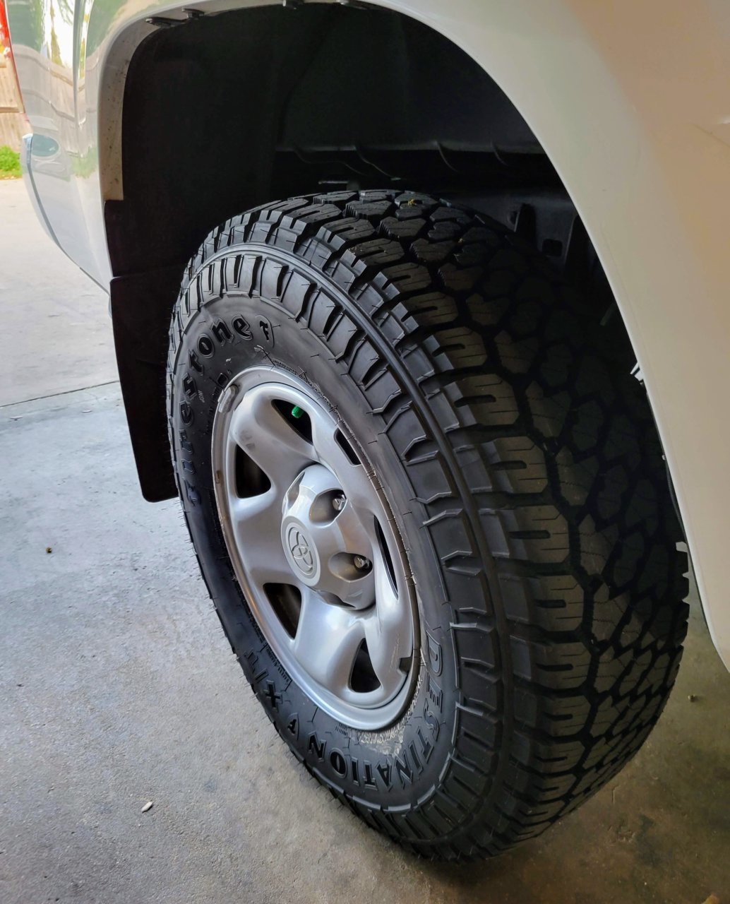

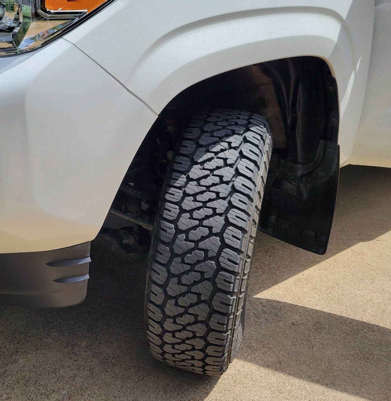

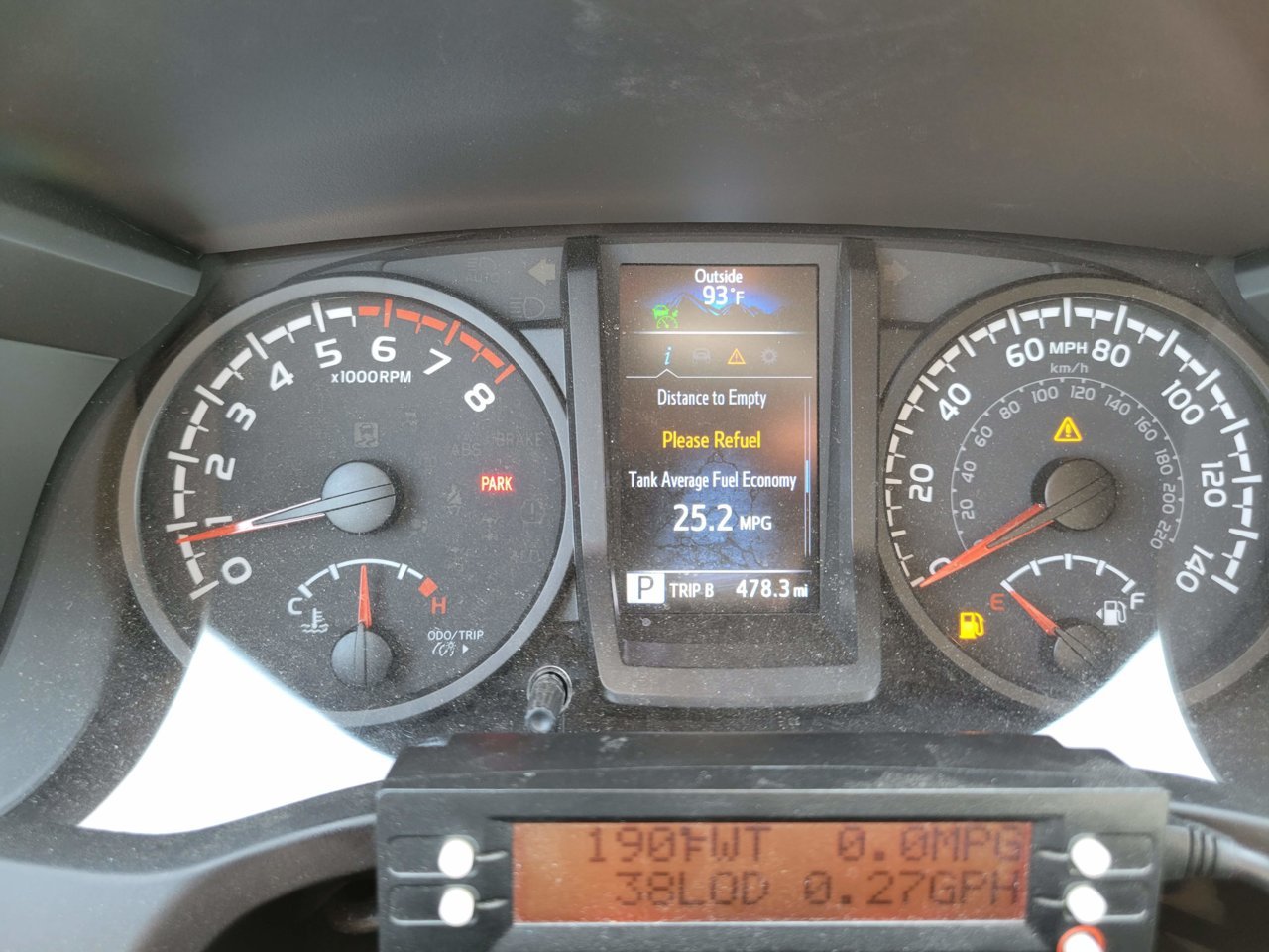

    I am kind of obsessed with MPG so I put the lightest E-load tire I could find on my 2.7 SR 4x4, in the stock 245/75-16 size: Firestone Destination X/T. They weigh 39 lbs and I only lost about 1 MPG on the highway (like from 26 to 25 MPG at 65-70 MPH). They look substantial/beefy enough, IMO and were plenty capable on a bunch of easy/moderate rocky passes in Colorado.

    Found out that if you don’t tow or haul a lot of weight, you dont need E rating. SL would be fine and remove added weight and help MPG
    Looks good though
