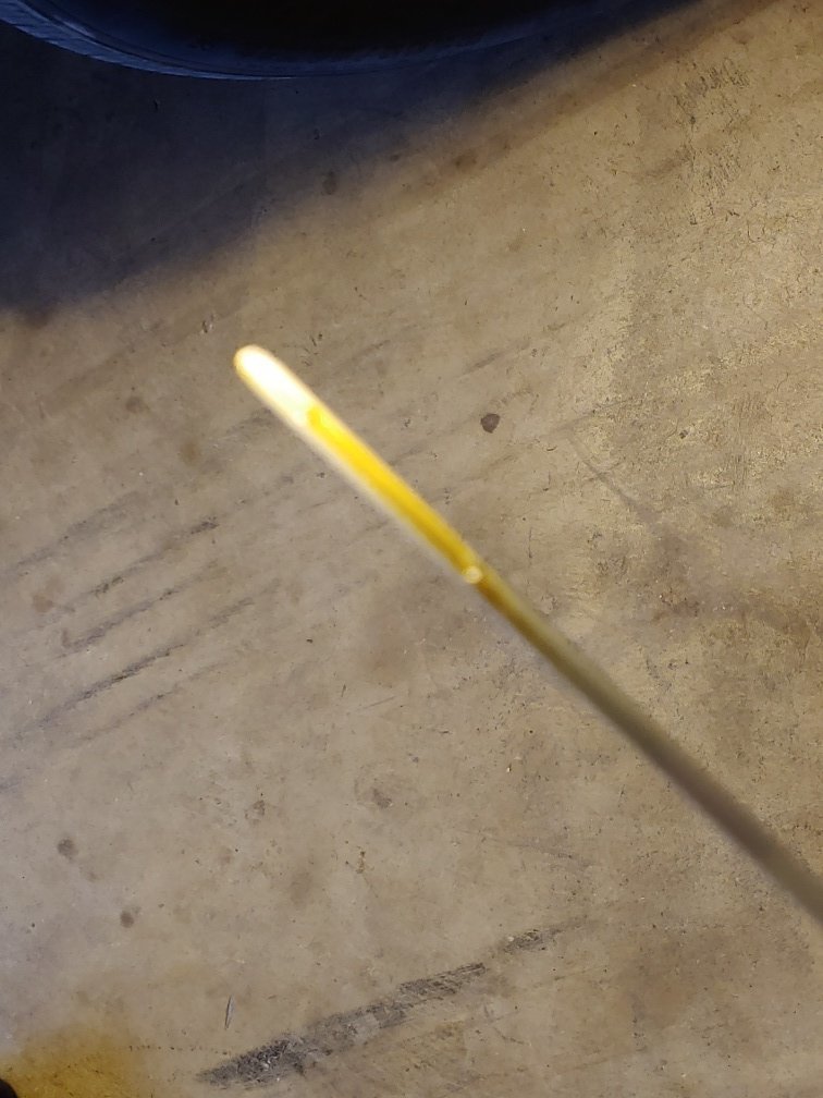

  11. Aug 28, 2019 at 2:26 PM
    #31
    MidCitiesMildMan
    MidCitiesMildMan Well-Known Member
    Dec 21, 2016
    #205391
    1,154
    2017 Toyota Tacoma Limited
    Stock and staying that way
    I pulled a trailer for 500+ miles on my last oil change. It was a 10k mile change (30-40k). It was visibly very clean when changed.
