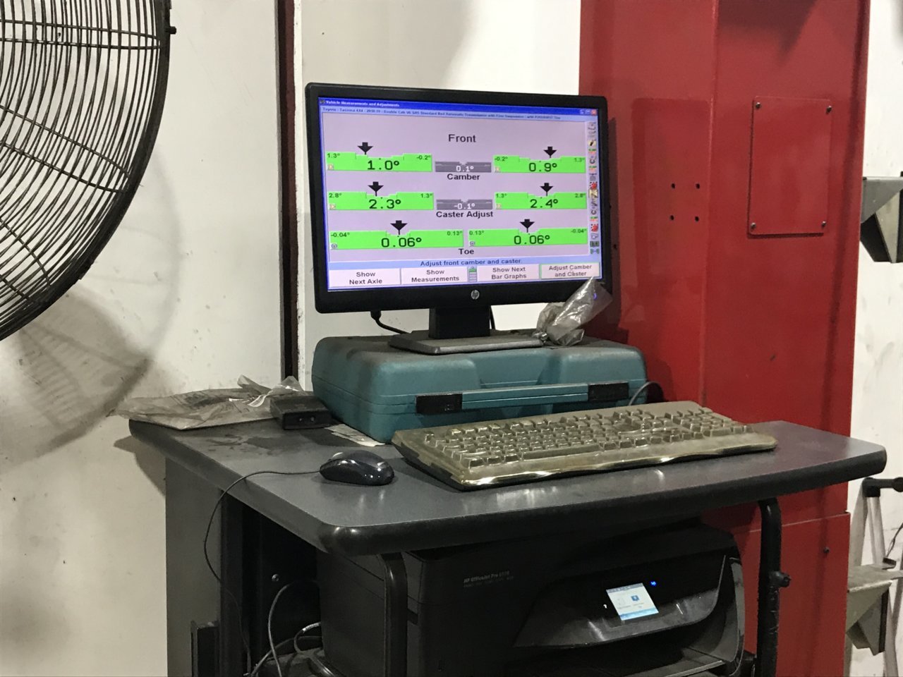

    Toyota says it’s normal and I don’t know what I’m looking at. These are my alignment specs after an Eibach lift. Am I OK?BF73584B-5DAD-4BCC-A77A-B09A6ACE7D50.jpg

    It’s only 2”. Don’t think many here have used aftermarket UCA’s with this kit. The tech said it looks off on paper because of the lift, but he assured me it was within spec. Just doesn’t make sense to me.

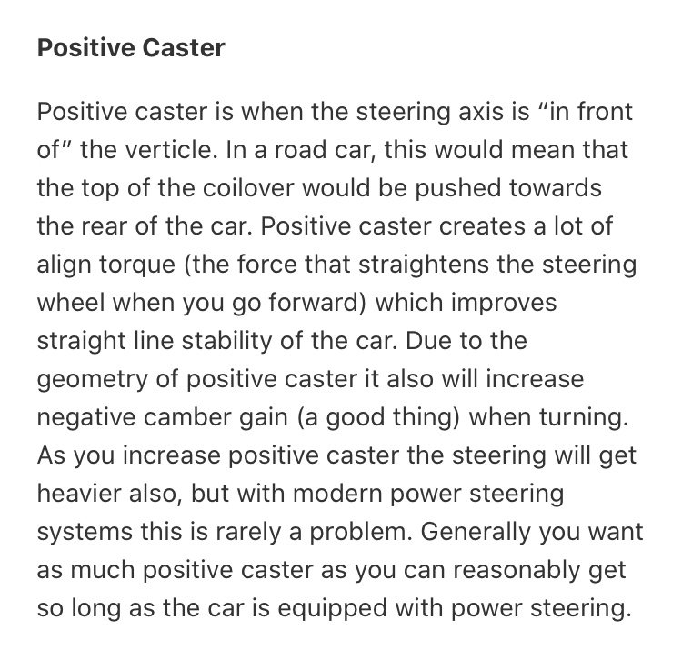

    it's also true to say that caster isn't simply for clearance. low caster affects driveability, moreso as speeds increase. as a high speed driver the value for higher caster is big over here. 2 absolutely sucks compared to 4+ if we're talking about driving dynamics.

    I brought it back to toyota. We’ll see what kind of numbers I get this time around. Can someone explain why I want more caster.

    On the highway do you get a slight drift to the right when you take your hands off the wheel?
    By those numbers I'd say the tech either didn't care , didn't know or there is something real screwy in your suspension...
    My bet is didn't care and didn't know.
    It's not because it's a dealer, it's the tech. So have a look around for an alignment shop or one of the techs that will follow instructions.
    After a 1.5" lift on 8112's with the Med-Heavy springs and stock control arms, I specified;
    0 toe, 0 Camber +1.4+ Caster on left (max it out), Left Caster +.4+ on right side (get as much as you can on both).
    Marked settings on the cams before the lift and set back to that before it went to alignment...
    I had a Toyota Tech that cared and knew what he was doing...
    You'll see how little a 1.5" lift affected the stock numbers on the top readings.
    On the bottom readings you'll see how close a GOOD tech can get the numbers.
    Yes he got the numbers exact with stock control arms.
    So don't let that Toyota tech fool you, and you don't have to have aftermarket control arms to get much better numbers.
    Take it to a better alignment shop, and then see what your best numbers can be before you consider the expense of control arms.

    I'm at 4.1 both sides and yes, this is the zone on this truck, 4-5. on most setups for highway+ speeds... drives like an absolute dream.
    exactly. stock drives like shit. you won't know unless you change it... and are an engaged driver i suppose.

    C21F606A-083F-4948-818D-15897E8E0A58.jpg Just left. The tech was very helpful and admitted that he didn’t try much adjustment the first time because he saw it was lifted and thought it’d be futile. Here’s the current numbers.

    that's good that's he stepped up. this is decent if you just want the stock drive. i wouldn't want that alignment for any kind of good driving or performance, but for a stock drive you're fine. happy new year.
