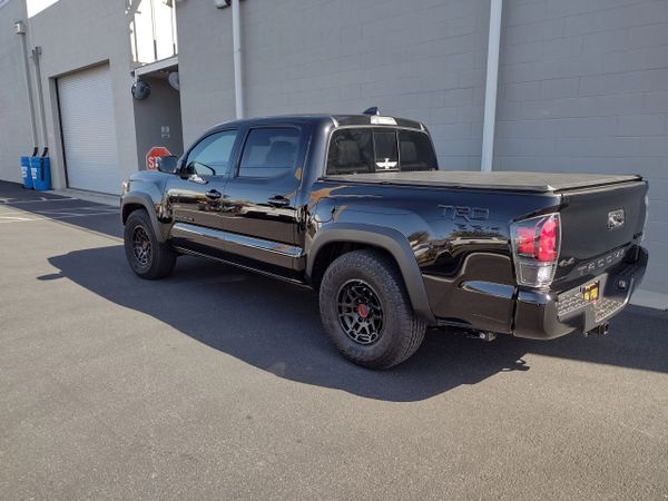

    I'm assuming the cerebral palsy is preventing him from stepping up and then stepping up again to get into the truck. He might only be able to slide in from a lower height.
    Besides the suggestion that @Gatafly suggested, I'm pretty sure the SOS lowering kit is the only one available. Heck, selling the Pro front shocks will pay for the kit.
    Here's a pic from the SOS website. It's already been done. I don't mind one bit if someone buys a Pro, and drops it. It's his truck, and he can do what he wants. "Removing barriers" includes putting a disabled person into a bad-ass Pro, and all thanks to SOS for making that kit happen. It doesn't matter if someone is disabled from cerebral palsy, or if they're a wounded veteran. Rock that truck because you can! :cheers:
