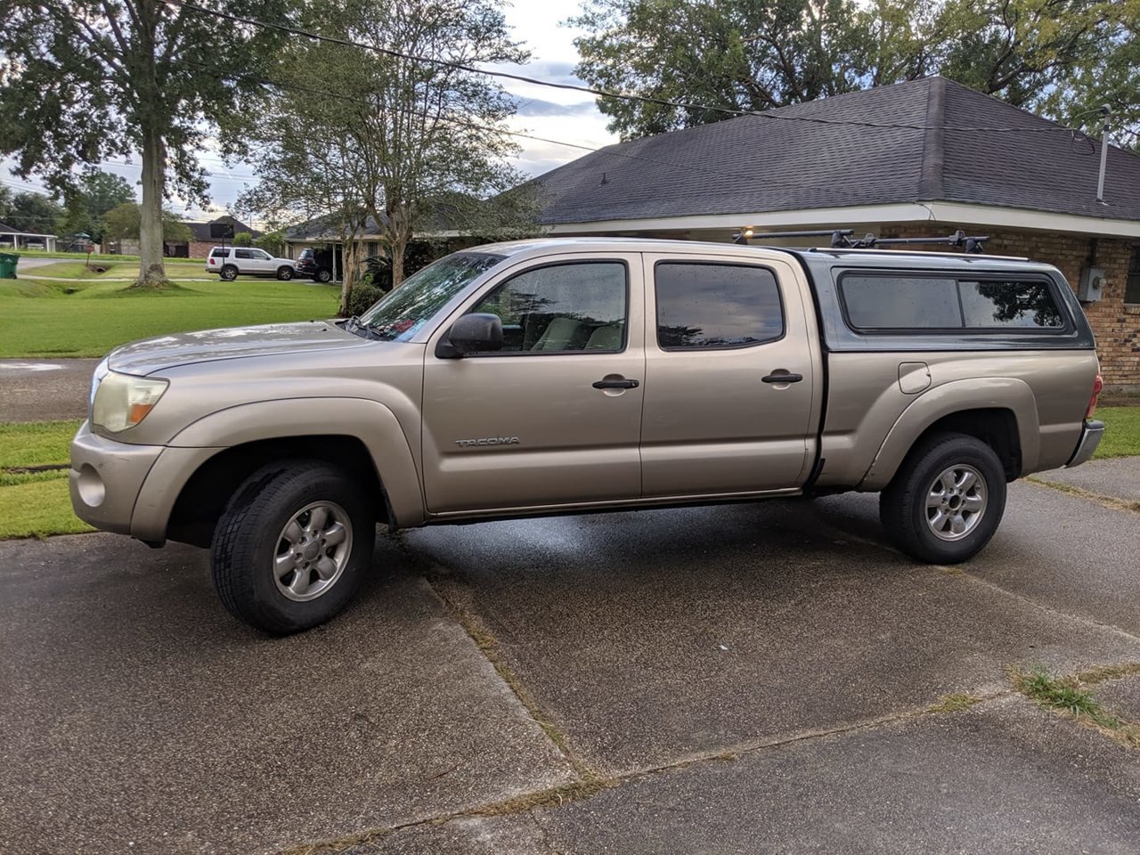

    2006 V6 2wd 6' bed Double Cab automatic trans. 245K miles. Love my truck, knock on wood, runs like new. I do what I can to keep it running as great as possible, along with my buddy who is also a Tacoma man, and fellow amature mechanic.
    Iv been searching for a maintenance schedule beyond the (maybe) 200k miles I could find online and from Toyota. The local dealership service dept. said to just start following the suggested maintenance from 200k as if it was ZERO miles. But I know some parts will eventually need to be changed/replaced/serviced that are not really on that list. From what I could piece together from these forums as well as FB Tacoma World, this is where I am:
    At 200k miles I changed the spark plugs, belt, radiator fluid, brake fluid, new engine and cabin air filter. I do regular oil/oil filter changes at 5k/10k respectively. I did the leaf spring recall (finally) at 240k and they were replaced. I change brake pads as needed.
    Bout to hit 250k (at 245k as of last night). Preparing for the 250k service considering what I did above:
    Was thinking of:
    1) New coils and wires (and new plugs depending on the shape when I check them)
    2) Fuel filter
    3) a DIY trans flush (awesome thread on here for that which I found)
    Anything else I should do/look at/ inspect/ change/ etc?

    09 Dbl Cab Off Road MGM
    Along with all the other service recommendations, I’d suggest painting the cap to match, replacing the missing wheel cap and giving it a full detail.
    Then continue to drive and enjoy.

    794
    A bit off topic,but isn't that truck pretty rare? I've never seen a 2wd long bed with the 4.0
