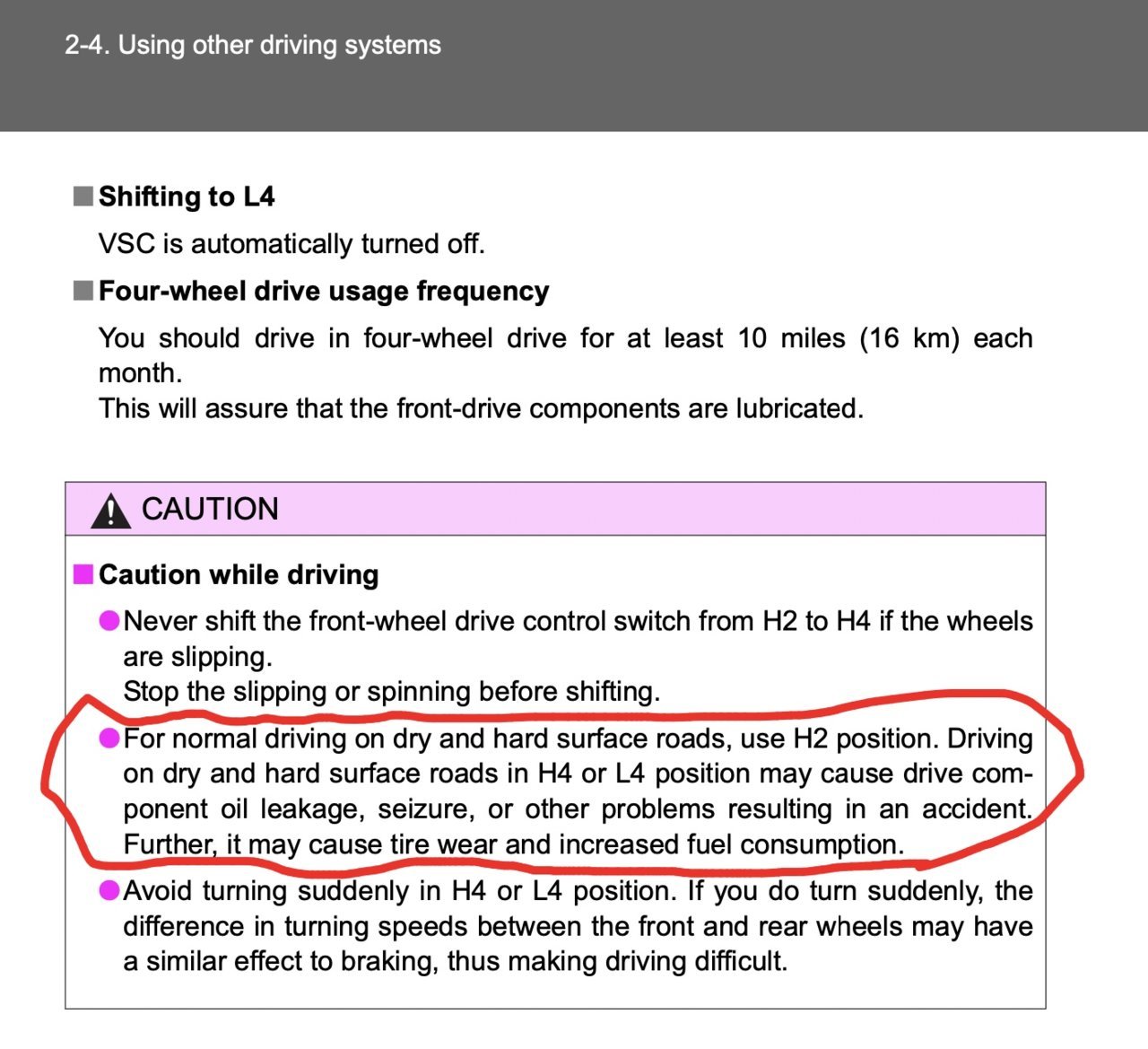

    From page 190 of the 2014 Taco V6 4.0L 4WD owner's manual. Recommends not driving in 4WD on dry/hard surfaces. Drivetrain wear/damage not guaranteed to occur, but it may occur.

  11. Jan 21, 2023 at 3:13 PM

    HAHA!
    These trucks are not delicate flowers, they will be fine.
    Also, the scenario pictured is not dry

    So then I guess for the 4WD usage frequency bullet point there they expect you every month to go find some random "soft" dirt/grass field and drive around in circles for 10 miles? :notsure::rofl:

    Pretty much "yeah."
    I've gone on at length about how I deal w/ this without having frequent/easy access to dirt roads. TL;DR exercising 4HI at highway speed on dry pavement presents no problems so long as it's straight.

    No problem with just common sense you just came off a snow covered back roar still in 4WD on to a paved parking lot the truck will remind you right away if you are in 4WD backup with the front wheel straight and shift out of 4WD no problem. Even driving down a normal road in FWD won't trash any thing snow or not.

    Sure, at low speeds on surface streets or a parking lot, there's plenty of time to sense the signs/feel of drivetrain bind-up & take corrective action.
    I'd be interested to see well-shot GoPro video of the driveshafts & front + rear wheels of a 4HI-engaged Taco doing 55-65+ mph around twisty, bone-dry asphalt highways. Maybe it's all good & the tires just chirp as-needed to release constantly-recurring bind-up. Or maybe CVs or U-joints start snapping? IDK, I've never cared to test that particular limit.
