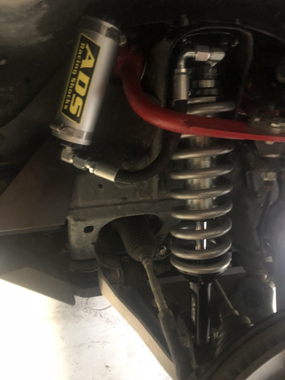

    They are coilovers in a technical sense, but not the kind we are referring to. You want a reputable brand like ADS, King, or RadFlo. Notice I did not mention Icon or Fox and some of the PacSun shopping fanbois in here will swear by Icon and Fox but that’s because they just didn’t do their research. ADS and Radflo are the only brands that sell the same quality product to the public that they put on their sponsored race rigs, King is King and their quality stands for itself. Personally, I am a fan of ADS and have run their stuff on my Tacoma and 4Runner. Fully adjustable Coilovers with resis are the way to go or if you prefer to stick with billies, get 6112’s and put some 700# coils on them.
    These are adjustable ADS Coilovers.
