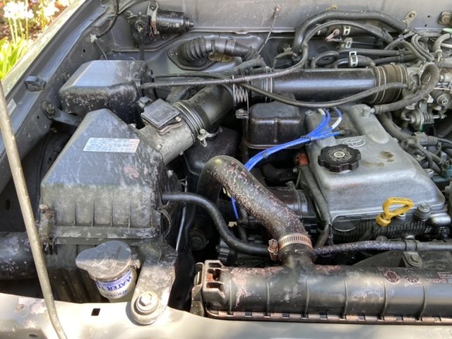

    So I was doing yard work the other day and noticed a small puddle of red fluid under my truck, right below where the power steering pump is…
    opened the hood,
    and what a mess…. Not power steering fluid, but rather I have a crack in the upper radiator tank…. Pink spots everywhere…
    new radiator and hoses on the way, along with a T-stat snd gasket…
    it’s everywhere…. On the firewall, wiper motor, distributor cap, underside of the hood…. What a mess…
    looks like I’ll be spending some time replacing and cleaning…
    Any tips? Looks pretty straight forward but I guess I’ll need to remove the skid plate…

    Good news.
    1) it didnt fail on road. Cause overheat and pop headgasket.
    2) engine bay cleanup is easy
    3) you found the problem and have parts ordered, meaning you can DIY. Always good news!

    I was lucky in this same exact way. Didn’t even see coolant on the ground. I was under the hood admiring some separate handy work, and noticed my coolant reservoir was empty - not a normal occurrence on my truck. Looked around and found a diagonal crack by the neck (original rad w/ 146k on it). So glad I happened to notice the failure when it was parked at home. Silver lining, OP. All downhill now that you’ve got parts en route. Also +1 for the funnel kit with adapters. I would buy mine all over again. Helps with coolant changes/flushes, not just radiator installs.

    Thanks guys, I recently (Feb/March) flushed ( drain/fill/drain/fill four times and then filled with coolant. Afterwards I kicked myself for not replacing the hoses ( original with 150,000 miles). They didn’t feel spongy or cracked, but figured it should have been preventative…
    last time I drove it was a 250 mile round trip…. Radiator still has coolant over the tubes ( but low) and about an inch or two in the overflow

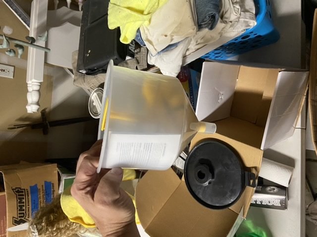

    When searching this site for my previous work I found that funnel set and bought one on Amazon…. I do a lot of my own maintenance and was surprised I didn’t see that funnel set before…

    Oh man that sucks! Simple green concentrate in a gallon weed sprayer works really well in the engine compartment. I spray mine down followed by a good spray with the hose to clean works fairly well. Like others have said much better to find it in the driveway then on the highway. OEM replacement if you’re not modified. If you’re worried about cooling you may look at a higher end radiator since you have to replace anyway

    Yeah screw that setup.
    Did the Tacoma without the kit, and burped the system myself (some 2 years ago).
    Decided to do the 4Runner but bought the setup you linked, and gave it a go just 2 weeks ago; it seeps/leaks from the cap adapter.
    Made a small mess and just caused more work than what it's worth.

    my funnel didn’t have any leaks. I usually try to just fill without a funnel and make a small mess…. I already used this one several times…
