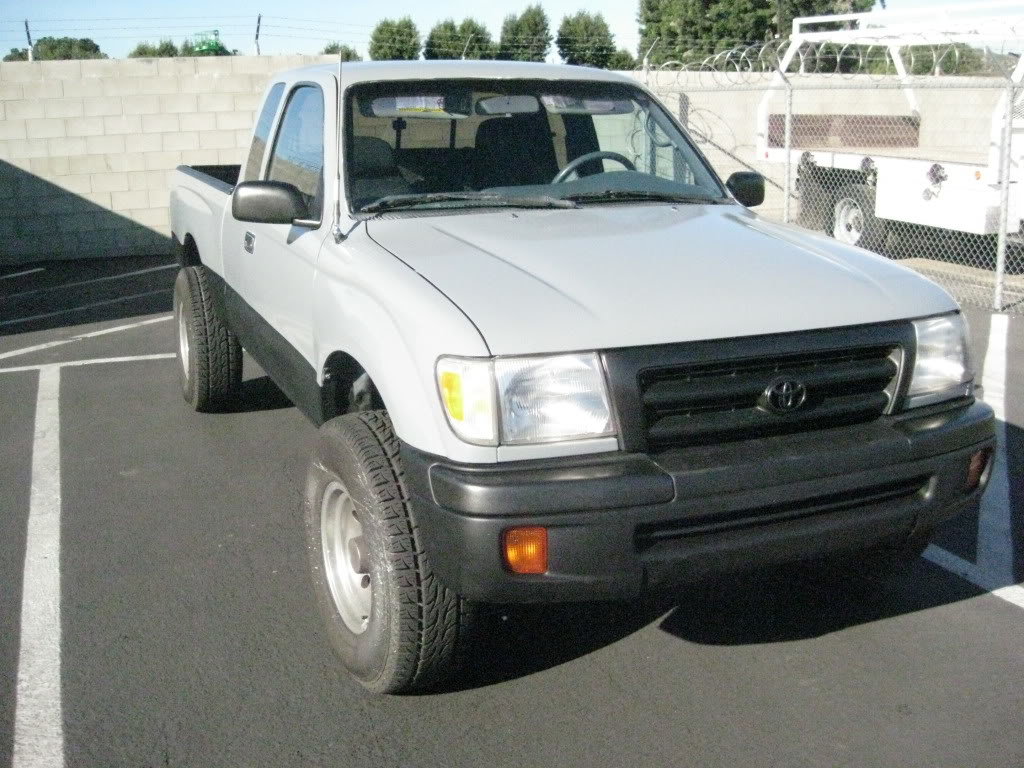

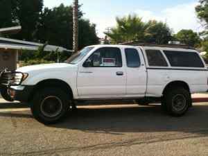

    This truck is a work truck - not a lot of fancy mod's here, but it's getting the job done!

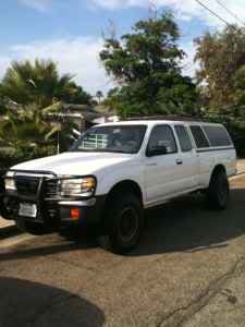

    This is the truck I bought:
    Notice the filthy wheels, the camper shell with wood windows, the ugly (IMHO) brushgaurd, etc

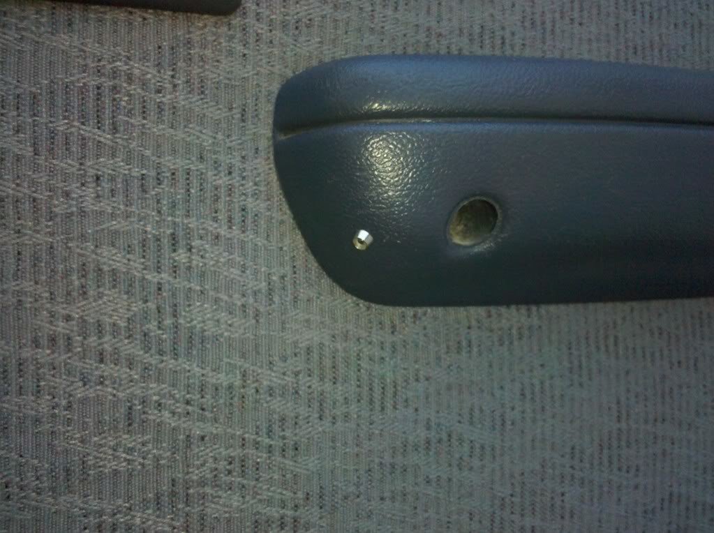

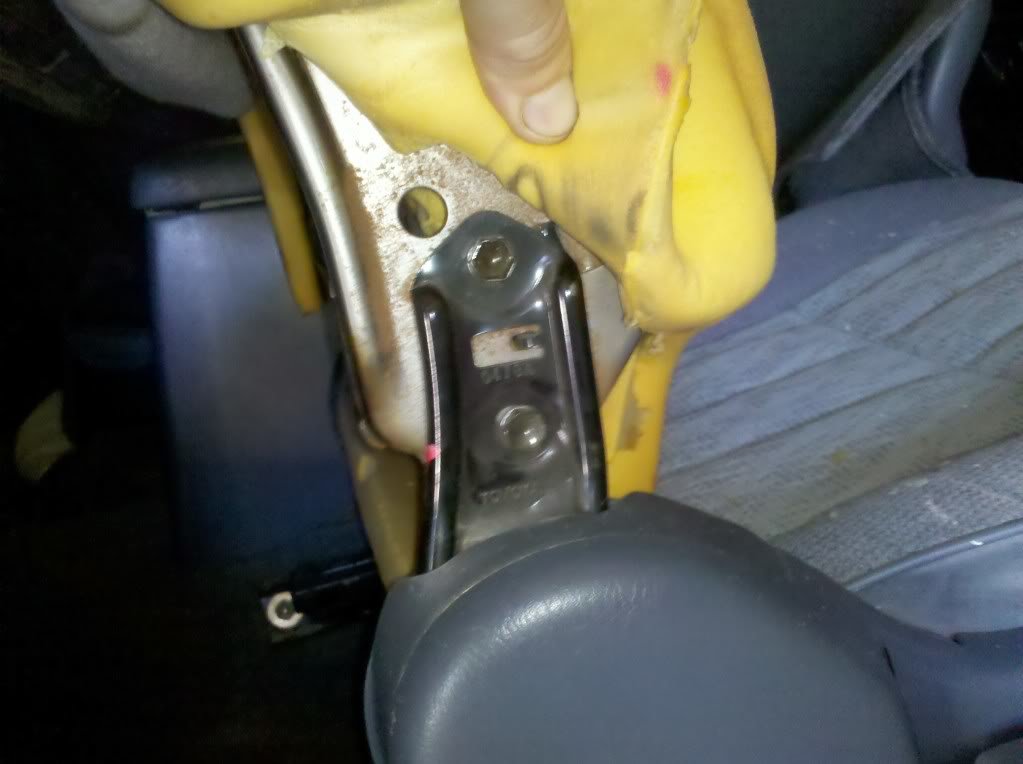

    The guy I bought my truck from didn't know why his drivers seat was broken - here's why:
    Those two bolts had backed themselves out and the back freely moved back and forth - This is the passenger side, since both were loose/broken - tightened them up and it was as good as new...

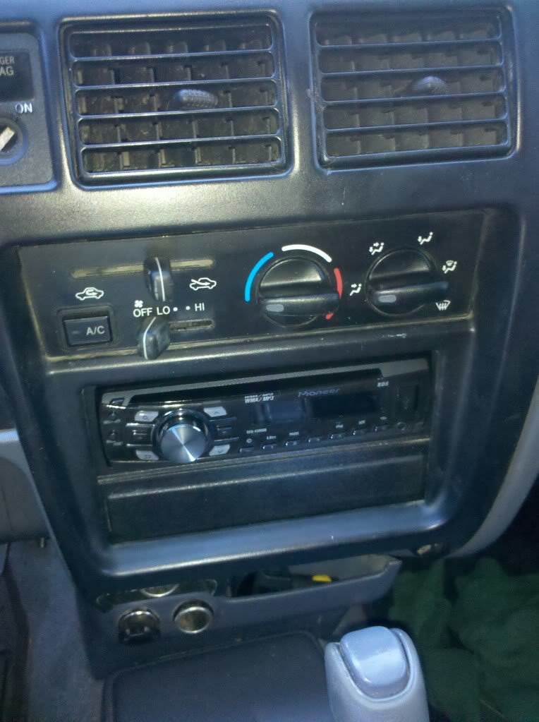

    Also put in some tunes, since the radio didn't work:

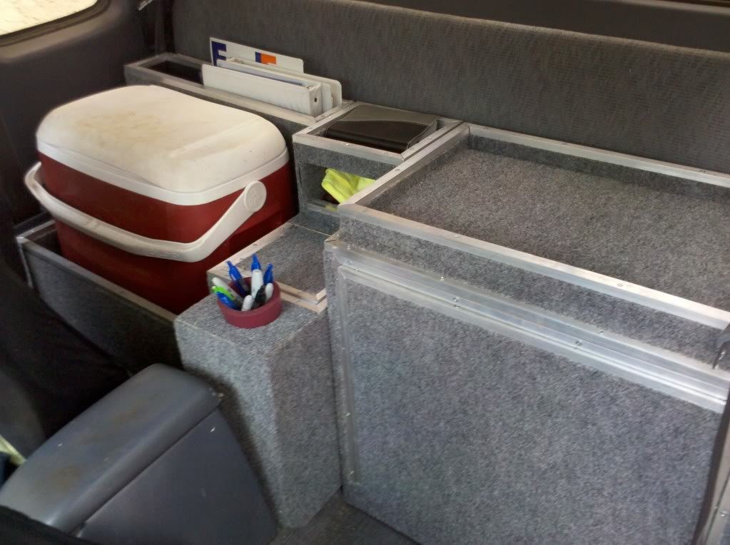

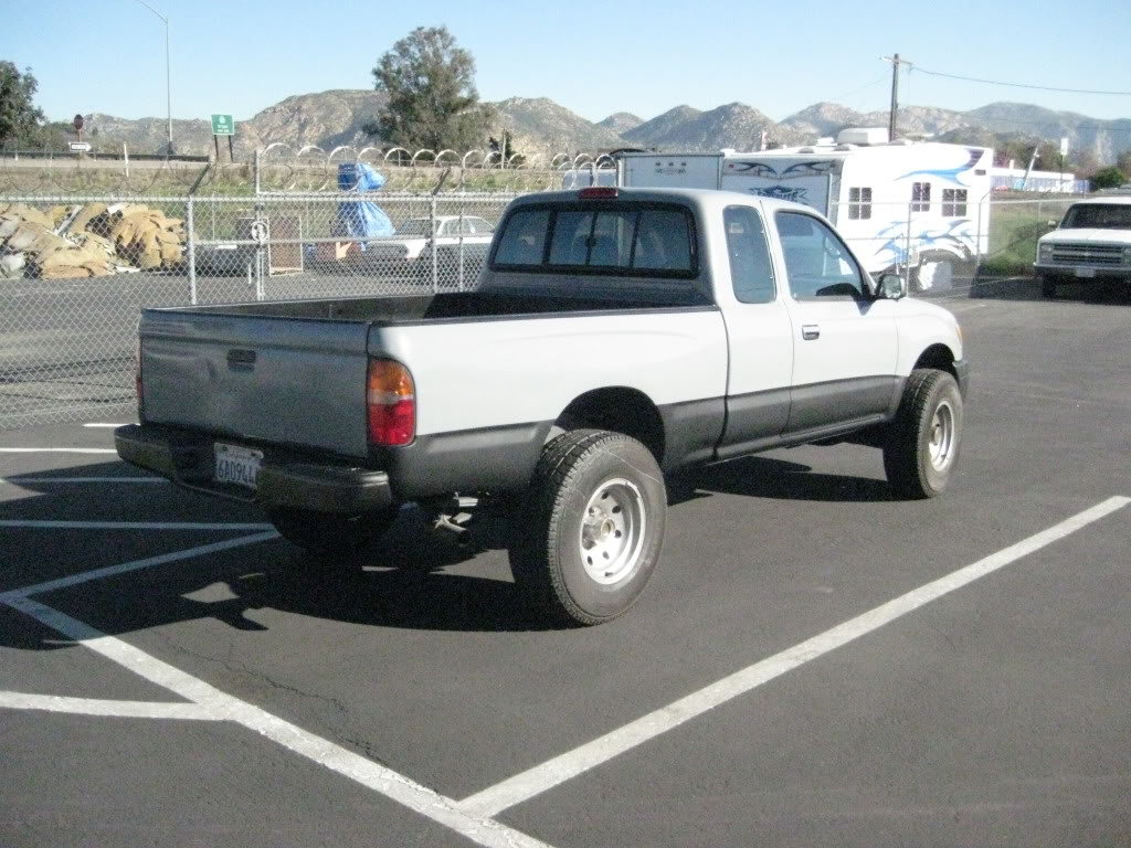

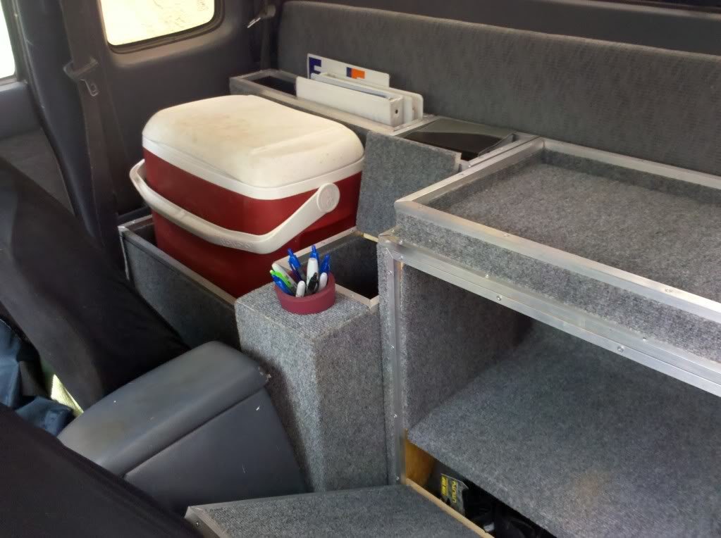

    After driving the truck for awhile, I realized that I would need some sort of storage in the back of the cab - my cooler kept sliding around and my tools wouldn't stay in one spot - Generally, it was disorganized and messy, so I started thinking about making myself some cabinets - here is the result of that thought process:
    Underneath the cooler I keep a set of tie downs, a set of jumper cables and some spongie ties and the box also locks in my dirt shoes (for when I'm diggin ditches) The middle box holds a first aid kit, and 3 locking plastic boxes, one holds batteries for my maglight and small LED Flashlights, another holds my phone charger, ipod earbuds, etc and the third holds packets of emergency (to flavor water and add vitamens) and trailmix). I added a cup holder for pens and pencils (or a third cup) as well as a tray for misc stuff, but my Bible sits there. The bid box has a tray on it for notebooks, folders, plans, etc and a locker underneath for a change of clothing, a wrench and ratchet set, or whatever really...
    I built them out of 3/8" plywood and indoor/outdoor carpet, and "L" or "U" shaped aluminum from home depot.

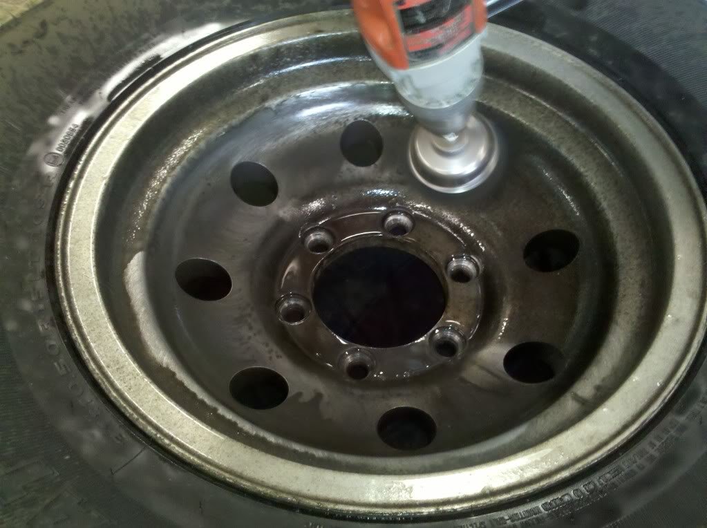

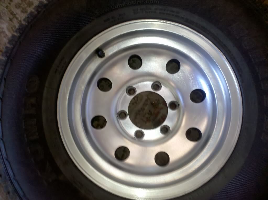

    Next thing I did, because I was so embarrassed by them, was clean the wheels - Took me 4 hours of wire wheeling with a drill motor to clean the gunk off them and I ended up needing to have my tire guy re-balance the wheels once I was done because I had taken off so much gunk. A quick wipe with acetone and a spray of lacquer and they are much better now...
    Tires are 31x10.5x15 Kumho Mojave at-63's.

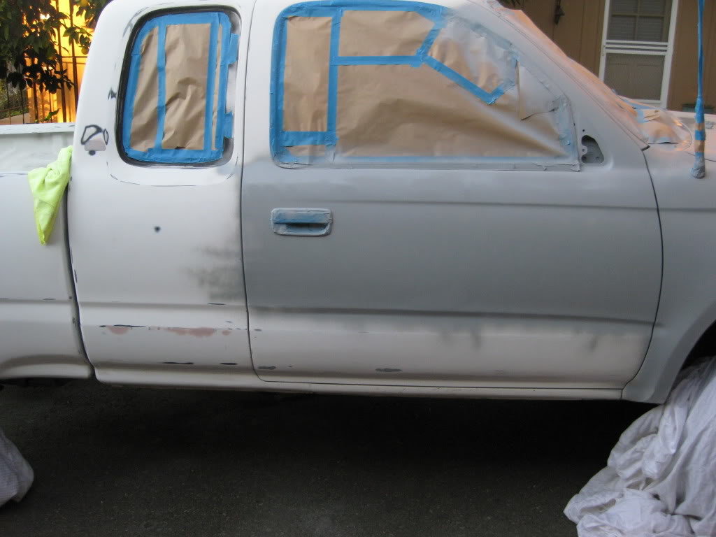

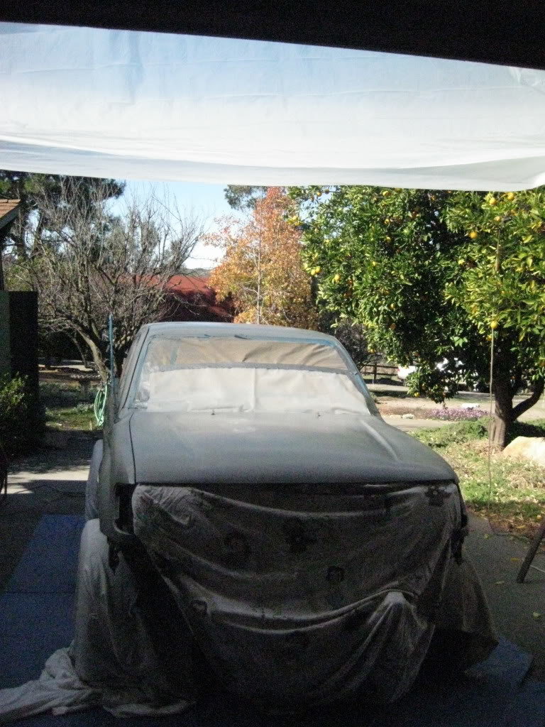

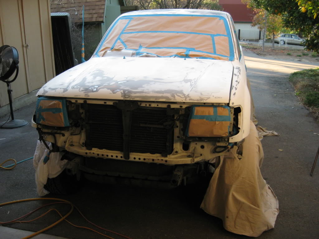

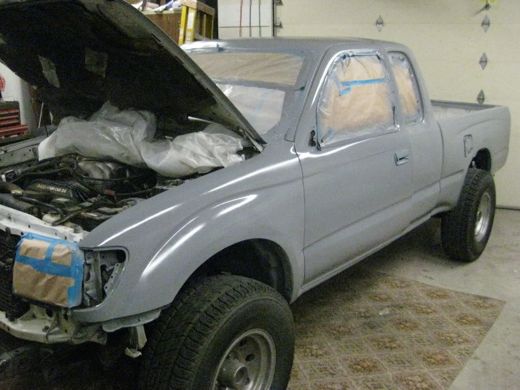

    After I sold the camper shell and bumper, I started reading about painting it - I took it to maaco first, for a cheapo paint job, but to fix the dents, sand off the house paint and respray was much more than the 299 advertised - try 2,499 all totaled out (no thanks to a 7.5% sales tax either)
    Here's what I did - I sanded the entire thing with 100 grit sand paper and a wood sander. My dad helped a bunch, coming behind me with a 180 grit pneumatic random orbital sander from Harbor Freight to get rid of my lines... from there, we worked on the rougher areas, sanding out the surface rust, smoothing out the 5 different layers of paint, etc...
    After that, we hand sanded with 220 to smooth out any sanding marks. Then after some bondo work, we rattle canned on 15 cans of primer to cover up the exposed metal:
    Finally, the painting begins:
  7. Jan 10, 2012 at 5:56 PM
    whatatoy
    whatatoy [OP] Galt/Rearden 2012
    Jul 13, 2011
    #59829
    291
    SO CAL
    I like it
    I chose rustoleum because, for $30/gallon, you can't screw up so much it'll cost you tons... ha ha - ended up having to buy some more (1qt) because water got into the air lines and created massive fish eyes... even with our filter/dryer - don't do this without one of these - it'll piss you off more than you can ever realize!
    My dad worked the hlvp sprayer and we sprayed it outside - so what if a bug or too gets in it... after painting, we pulled it into his garage/shop and let it sit... rustoleum takes awhile to dry.

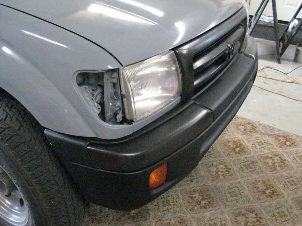

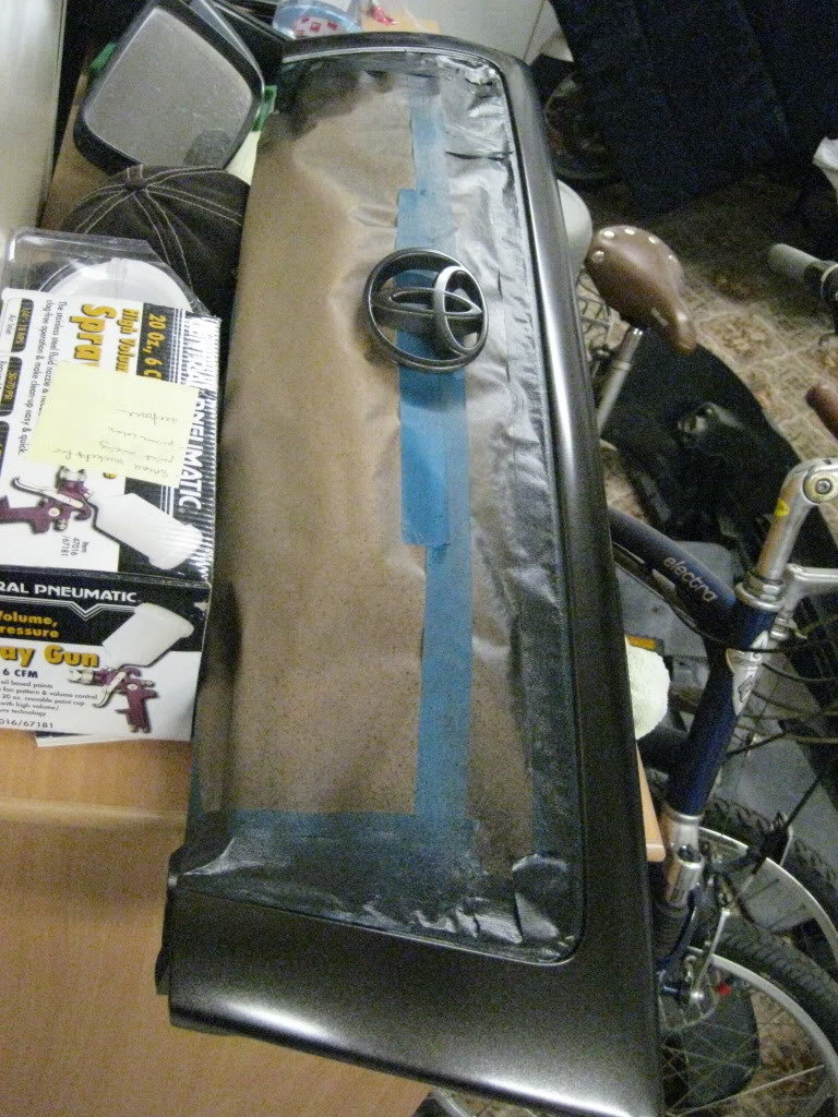

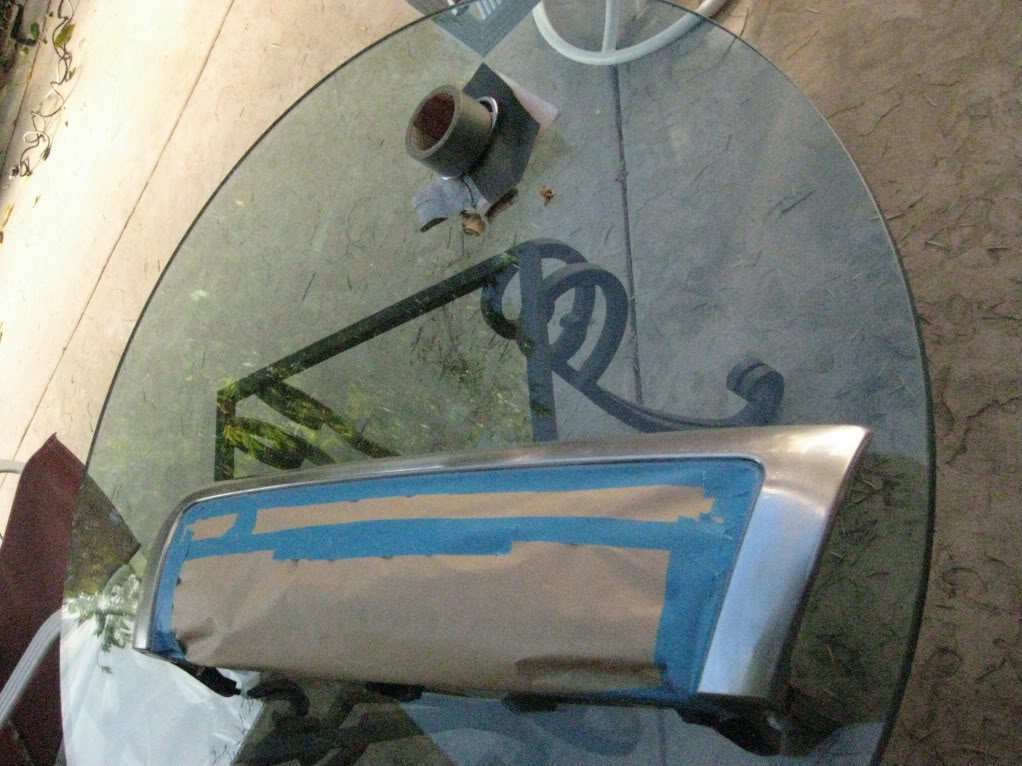

    While waiting for the paint to dry, I started on the bumpers and grill... didn't take before shots of the bumpers (Should have), but here is what I did... I painted the chrome bits metallic black and the plastic bits with bed liner - the front bumper just had the 2 chrome bits under the head lights. The back bumper was all chrome. Here's what the shots of the grill though, which was chrome trimmed and toyota emblem was just bare metal:
    A sneak peak back on the truck...

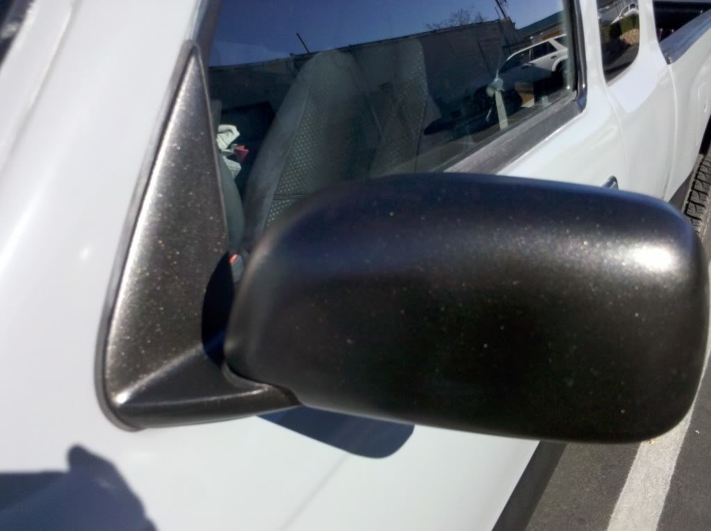

    Also, I took the side mirrors off and painted them metallic black... See here:

    Truck finished painted - It was my first time painting a car and I have to say, it's difficult. But, by the final coat my dad had figured out the proper way and it turned out pretty good. We let it sit in the sun for 3 days (yea for So Cal New Years - 80*F and super sunny) before wetsanding and buffing. Turned out as good as I wanted - wasn't really looking for showroom shine, just a good sheen and all one, consistent color... achieved. The black bed liner from the trim line down really makes though - check it out:

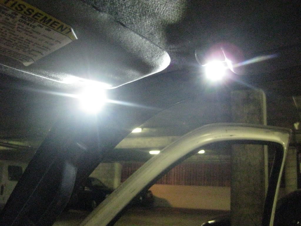

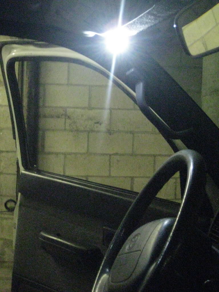

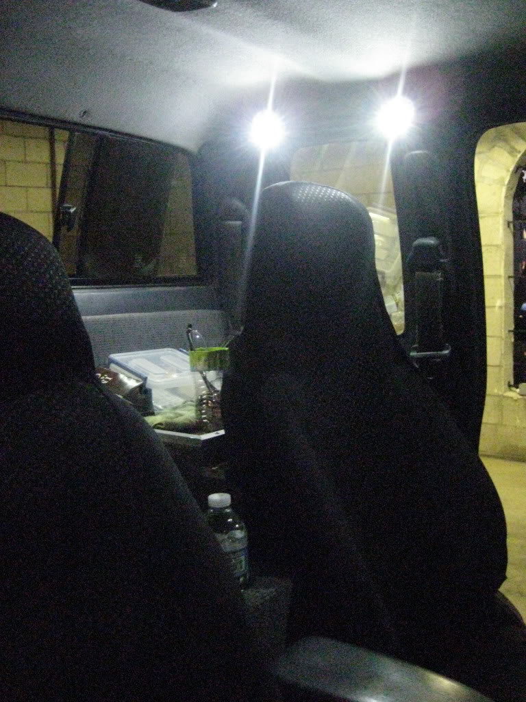

    Did my next mod I've been waiting for forever to do - some cab lights so I can see at night - I've taken a closer look at my dome light only to find remnants of prior shorting issues and since I couldn't get the switch to work in testing with a multimeter, I ditched it altogether. So, I started looking around the net and on this forum and I ended up buying some oznium pre-wired LED's --> surface mount LED's <-- as well as 2 not lit rocker switches.
    I didn't take any pictures of them just out of the packaging... kinda in a hurry earlier today... So, here's some pic's of the process and final product. I pulled the crack wiring job off the cigarette lighters (the Prior owner bypassed the fusebox and went straight to the battery with no fuse) and borrowed the power line, since it was good. I added an inline fuse and found a good ground - the rest is just clip, squeeze, tape, repeat. The nice thing about OZNIUM is that the LED's come pre-wired with a resistor and about 20" of wire... these surface mounts have double stick 3m tape on the back so no worries on even mounting them... and they are small - maybe 1/8 inch square.
    I put 3 on each side of the cab. Both the front and back LED's are in the same spot, the middle one I put further back on the drivers side for the ext cab storage and further forward on the passenger side for the passenger. switches are mounted on center console and they control their respective sides...
    The Mess below:
    Switches mounted nice and snug:
    Front Driver:
    Behind driver:
    Front Passenger:
  12. Jan 13, 2012 at 10:15 PM

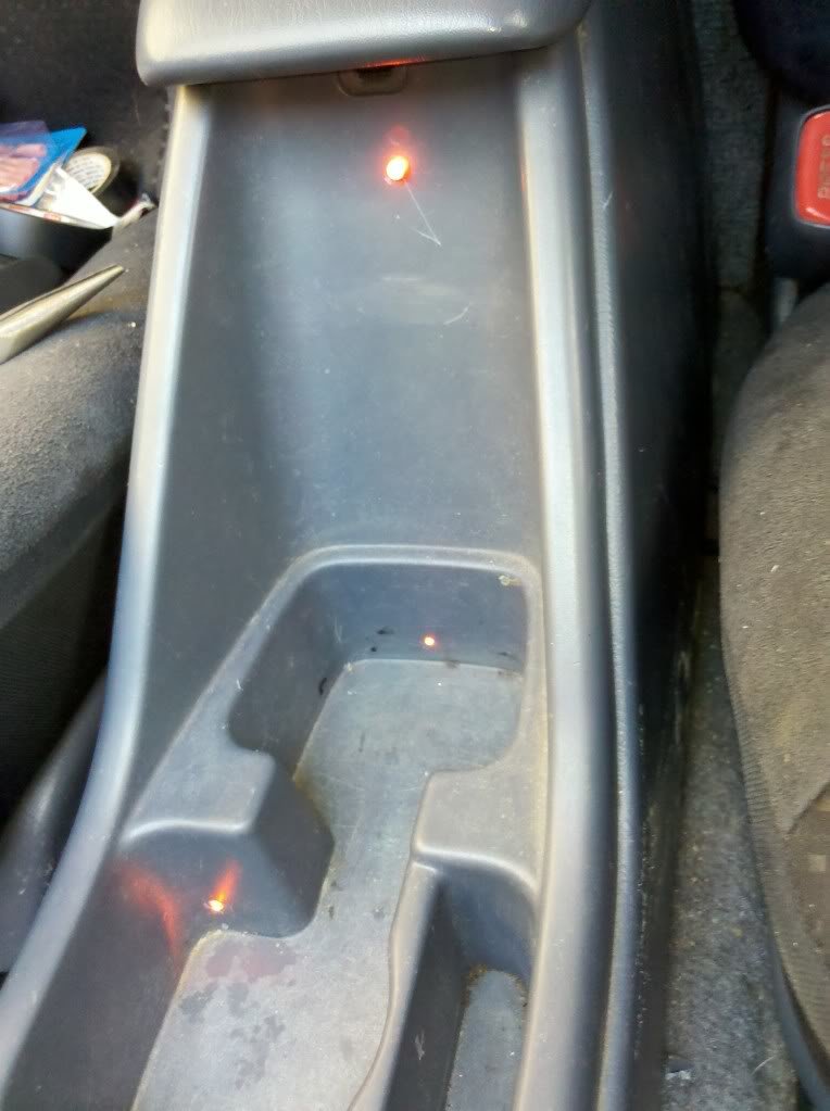

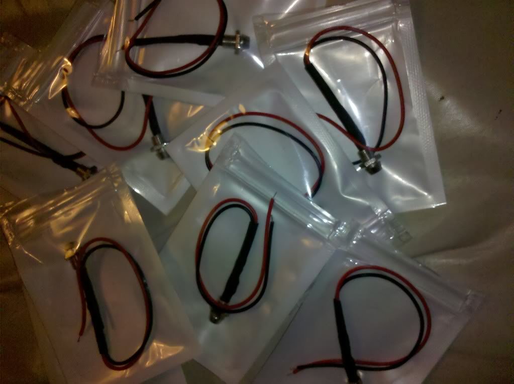

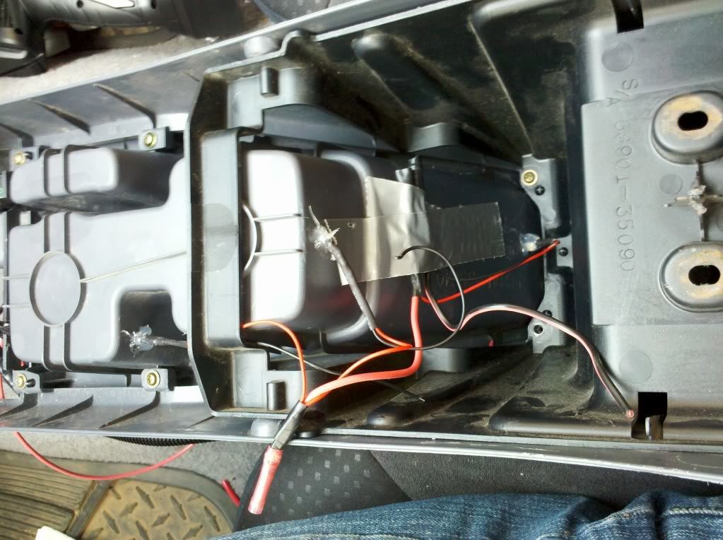

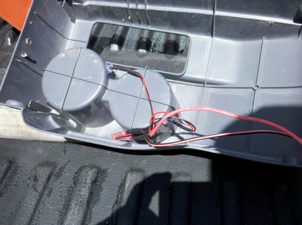

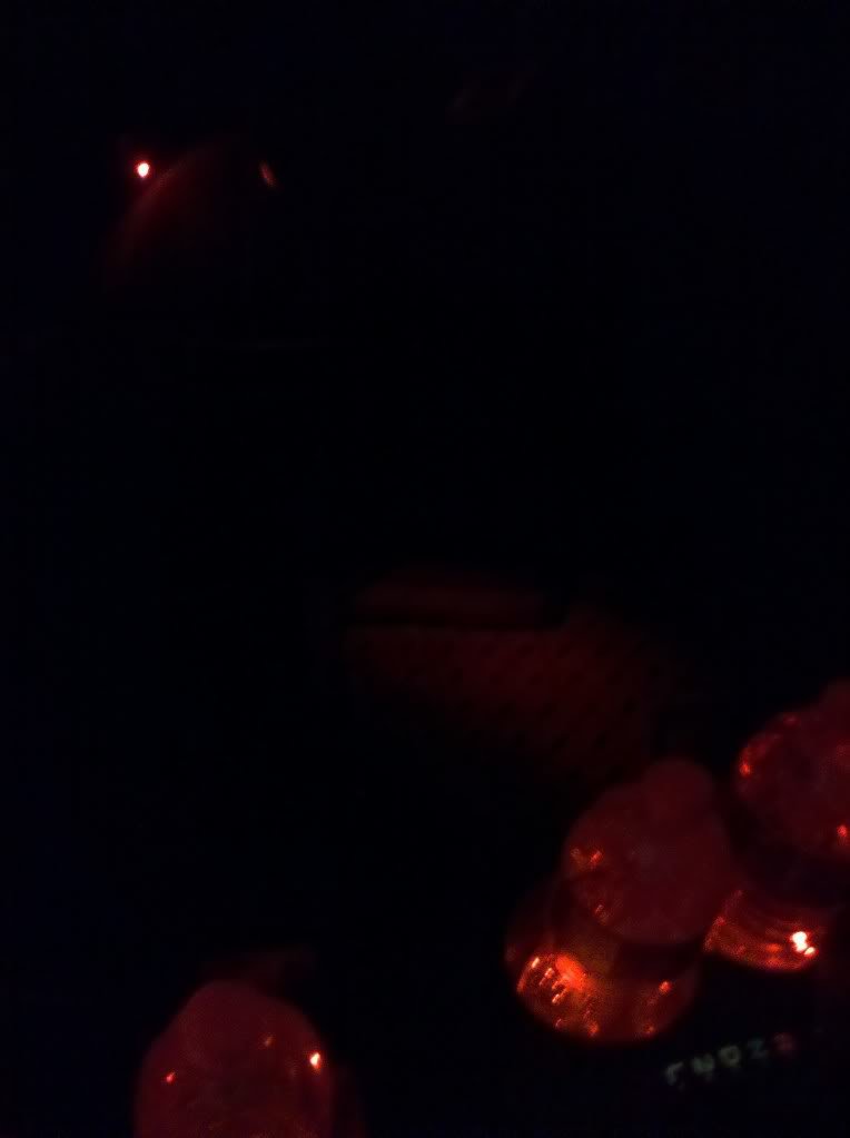

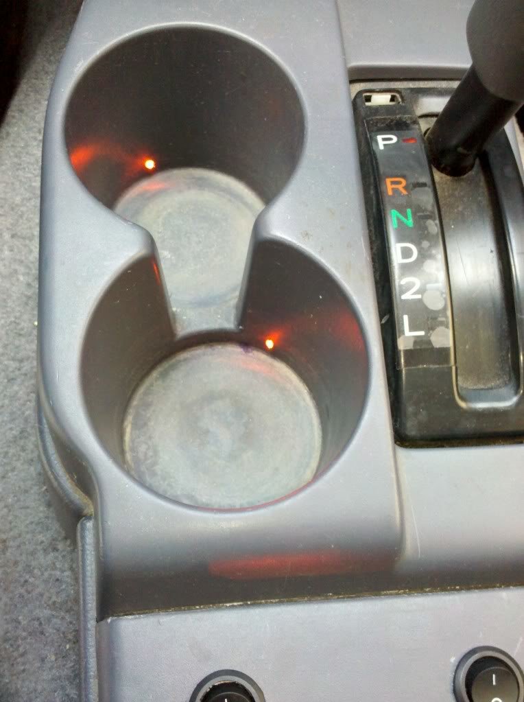

    MORE LEDS - 10 3mm orange ones from oznium... going to wire some to the headlight switch, some to my existing switches... good weekend project
    will post pics when I'm done... more pics here!

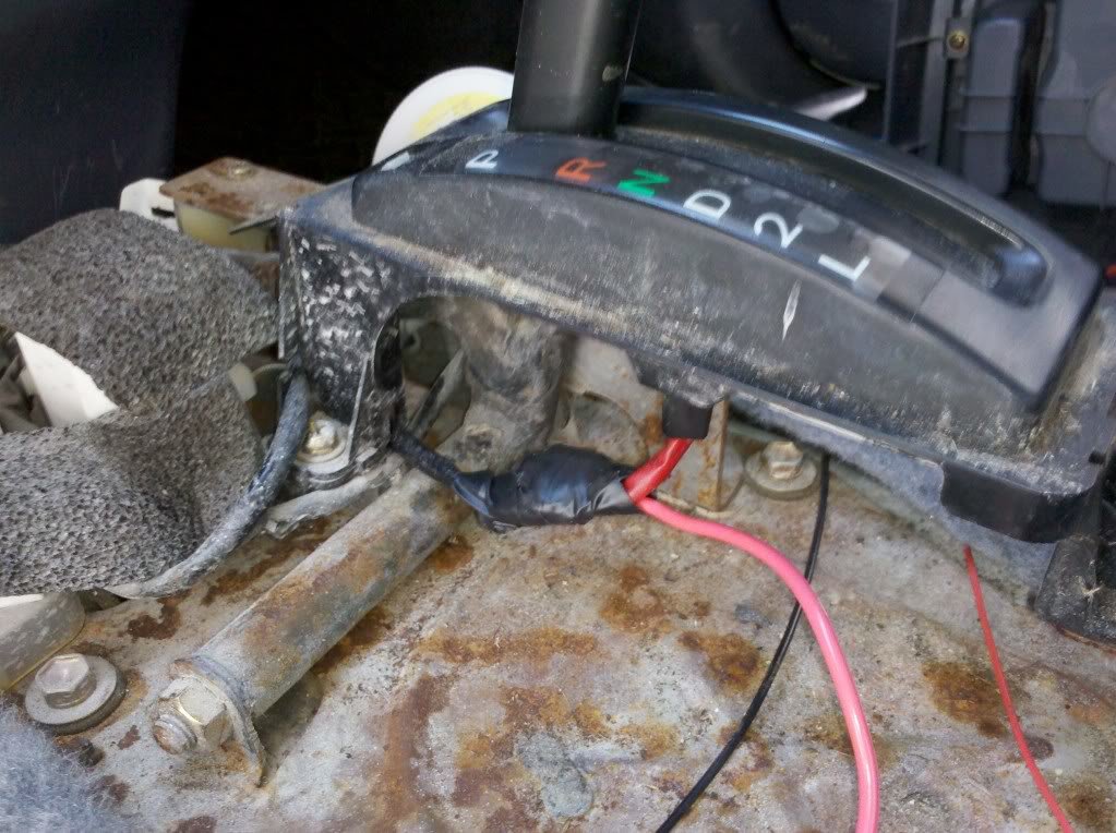

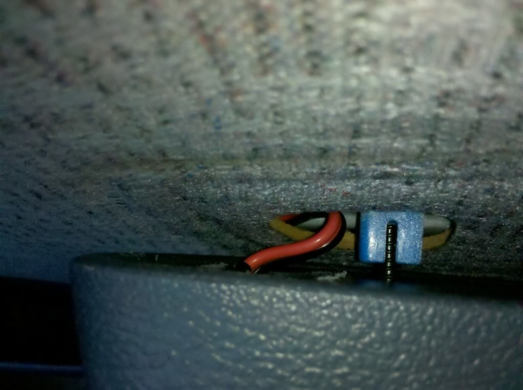

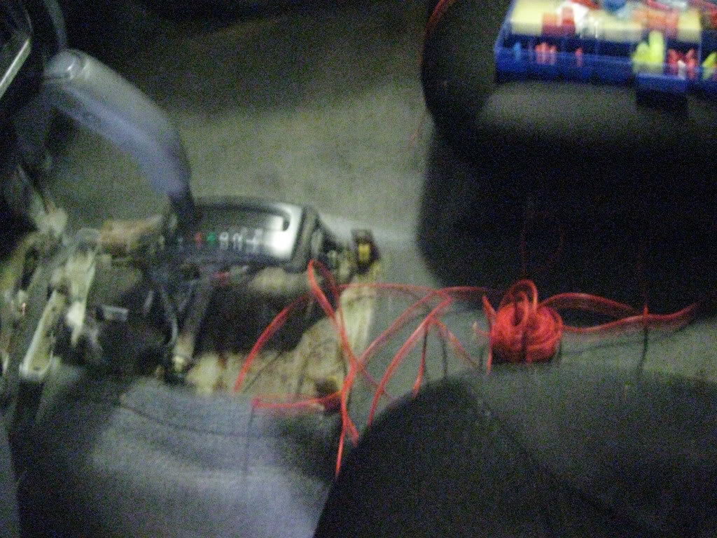

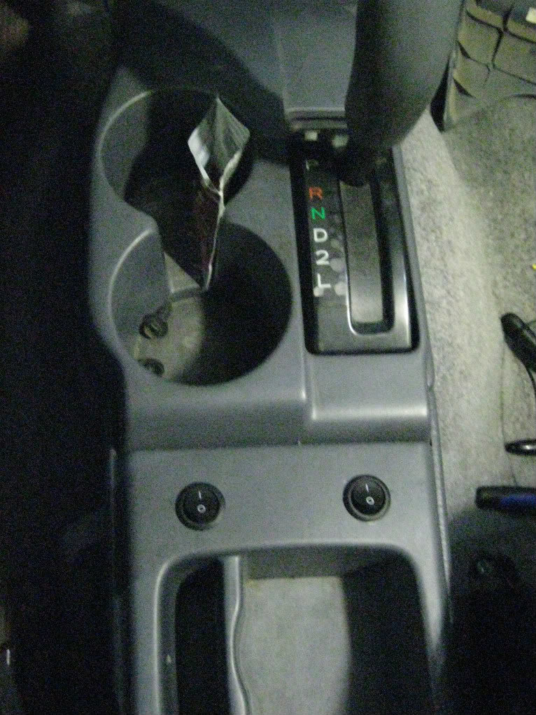

    So I tapped the power from here: It's power for the light under the shifter indicators.
    Yeah, I know - rust... what do you expect from an old truck?
    Underneath the cupholders, I used 18guage wire and 16 0 22 gauge butt connectors to attach the wires. I drilled a hole roughly the same size as the LED bulb - 3mm in size. The LED's fit pretty snug inside the hole and could probably stay in place without the hot glue, but for double reassurance, I used some hot glue to back the LEDs in place. I put one in each cup holder...
    This is the back section of the center console... I put 1 more in each of the square cupholders (stupid things) and one at the top of the center console to light up the dash... The wires duct taped to the back there are butt connectors for later use in case I want to add more lights to this group...
    Trucks kinda dirty, but here's the two in the cup holders during the day...
    Funny enough, the scratch at the top LED is not the drill walking on me - it's been there since I bought the truck - just happened to be where I put the LED... and again - dirty truck...
    just one night shot - my phone's camera decided to quit last night after this shot... pretty bright for 1 3mm LED per water bottle, right?
    The only disappointment I have here is that I thought it would dim with the dash lights and the shift indicator light power that I snagged power from - I guess the ground on the truck system is the side that is connected to the dimmer knob... oh well.

    I highly recommend it - I've had the chance now at night to turn on the lights - it's like stadium lighting in my truck - I get 2 shadows - super bright. I bought 3 for each side because I was skeptical of the amount of light I was going to get - dang, it's bright!!!

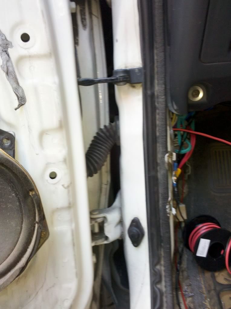

    Finished up my LED addition inside the cab - nice and low lit - so low the night pics didn't really turn out... I added 2 more, 1 in each door handle, which required pulling the door off... Pics below:

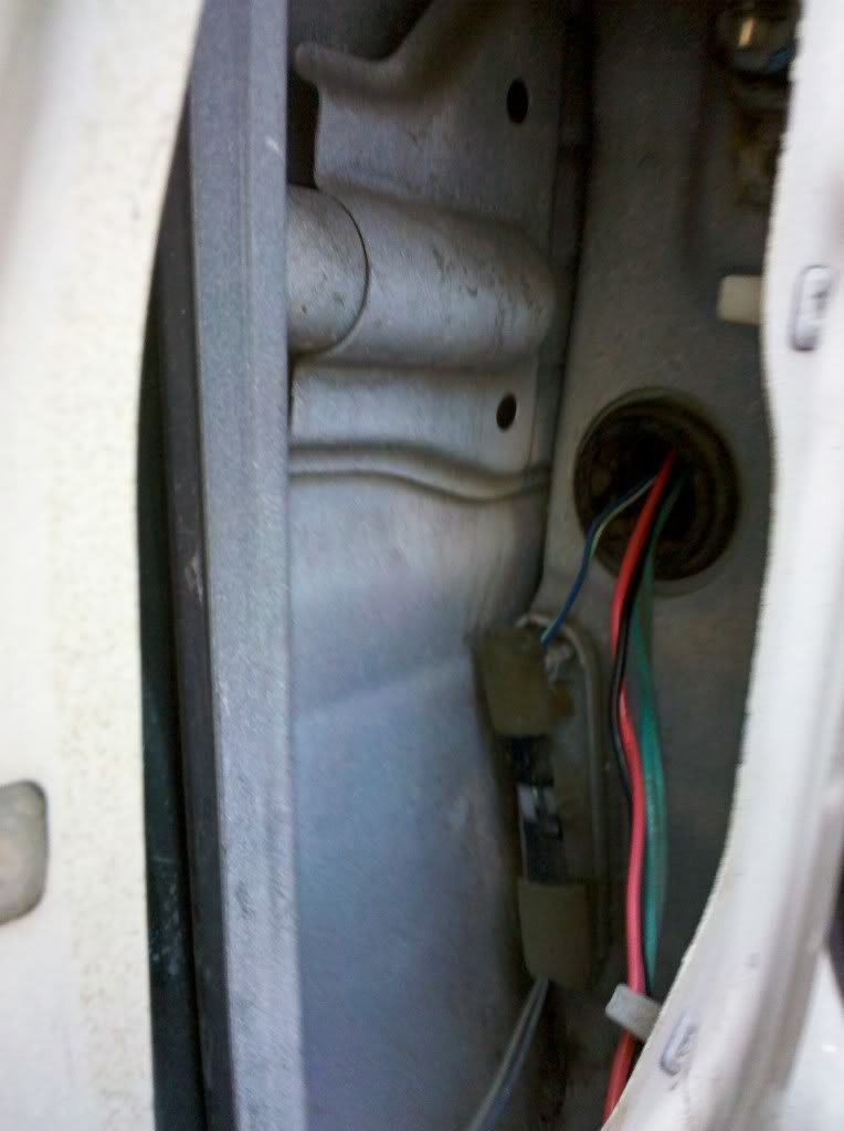

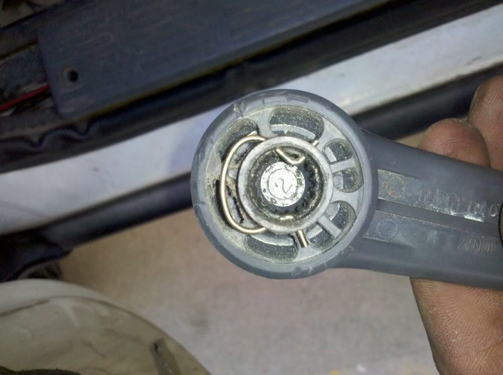

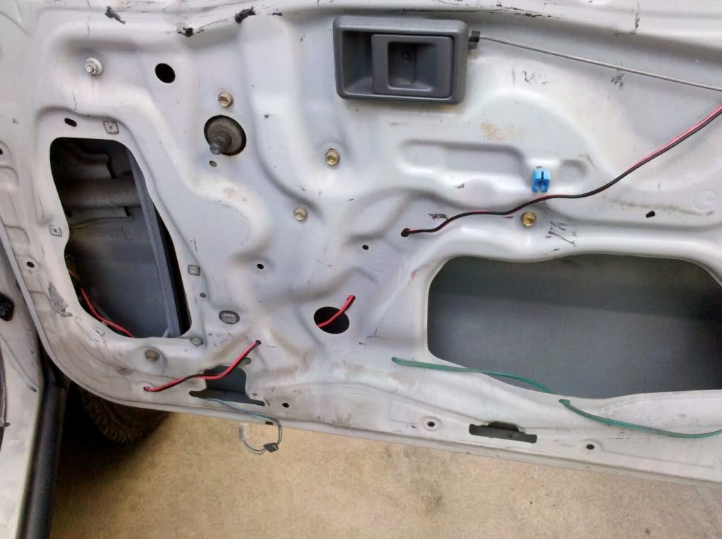

    Pulled the door panel off and ran my red/black 18 gauge wire through the door to get to my door handles...
    Getting it through the rubber wire protector that connects to the door was a pain, but a coat hanger worked wonders here:
    To take off the old fashioned crank windows, I deployed the shop rag technique and it popped right off:
    Running the wire from behind:
    Used Oznium 3mm LED's for this application - gives a nice glow on the floor. That's a chrome LED holder they sell, and since I used the prewired LED's, I had to hot glue this puppy in...
    One night shot so you can see how dim (what I was going for) it is and it didn't help that my phone's camera is lame...
